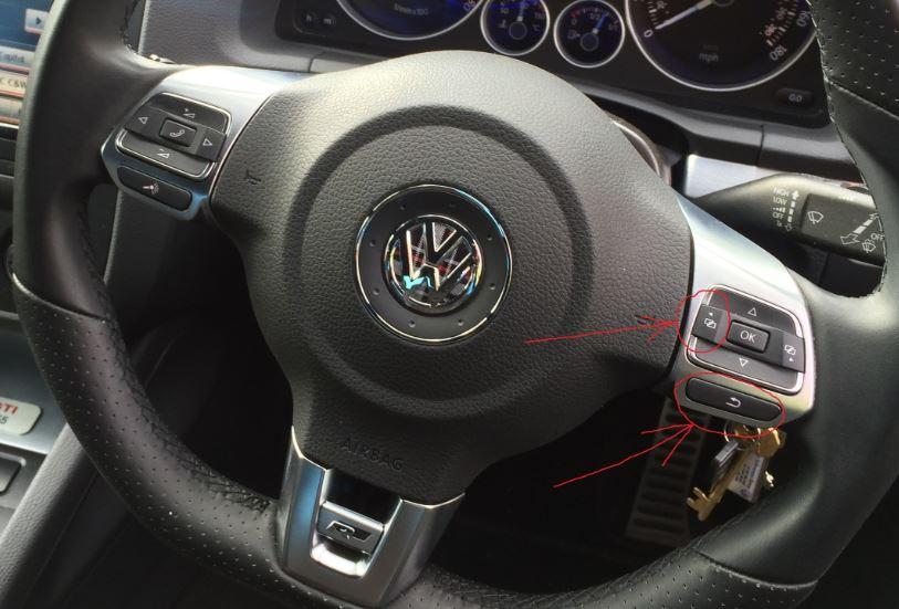

Got 2 out of the 12 that don't do anything.

As per Rumple.  Coded by the man himself Eddie NL
The two that don't do anything are highlighted below
could you not have the return button set up to work at all?

To be honest, no idea.  Ed would be best answering this question.  It's never really bothered me at all as I have access to everything I need.  :happy2:
I'm sure if there was the chance they could be utilised with the setup I have Ed work have had them up and running.
