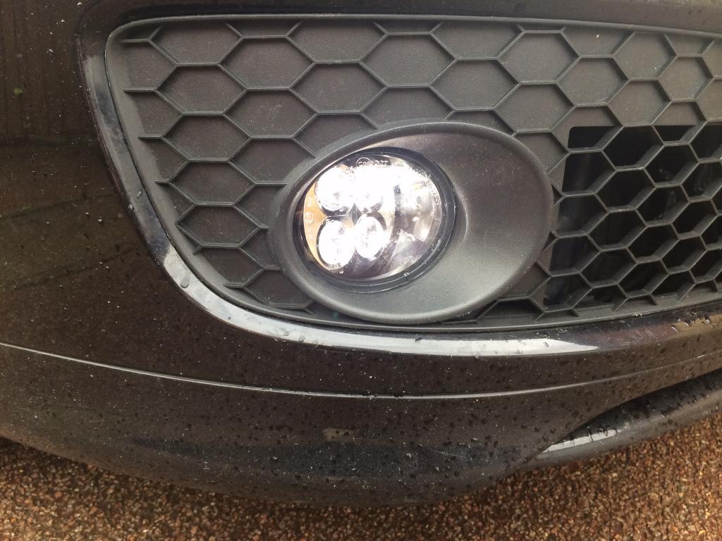

I ordered a set from skoda, these 4 smd led units are the same dimensions as the mk5 fog, its just the mounting brackets are back to front!
They require a tiny bit of adjusting bodging to get them to fit :laugh:! I have coded them with vcds as 'fogs as drls' and the 'drl dimming' is currently at 80%, pics don't do these justice

The led units were £42 each new from skoda, which i thought was cheap! Then a few quid for repair wires and the plugs to connect them  :happy2:

I assume you need the mk6 cecm to do this? and that if they are drl's they now don't have the cornering function?

You don't need a mk6 cecm as the option 'fogs as drls' is on all cecm's. Also cornering fogs leds still work with headlights  :happy2:

Are the electrical connectors the same on the Skoda lamps, despite being LED?

Thanks, The plugs are 3 pin on the leds as opposed to the 2 pin fogs. I only used 2 pins to power them with the new plugs however they do require a resistor inline to trick the canbus  :happy2:

The silver tip buttons add a nice touch to the interior  :happy2:  and the fogs as DRL's look klass  :congrats: :congrats:
