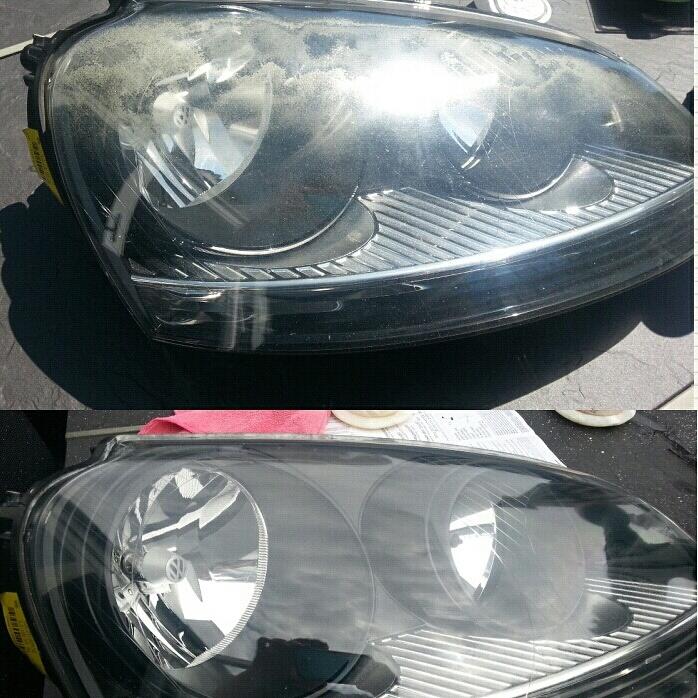

3M kit before and after shot
Good result

Asking in all seriousness - would i be ok using AG Super Resin Polish to restore my headlights? I have a small amount of that dull crystalling effect (oxidisation i think) as seen in wodder42's before shot running along the top of the headlight and i want to nip it in the bud.
