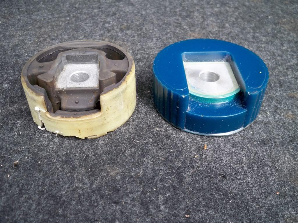

anyone any pictures of the vwr bushing? how much are they?
All the details are here - http://www.mk5golfgti.co.uk/forum/index.php?topic=6995.0

« Reply #26 on: October 25, 2009, 09:40:59 am »
ah right thats what i will get then cheers  :drinking:
