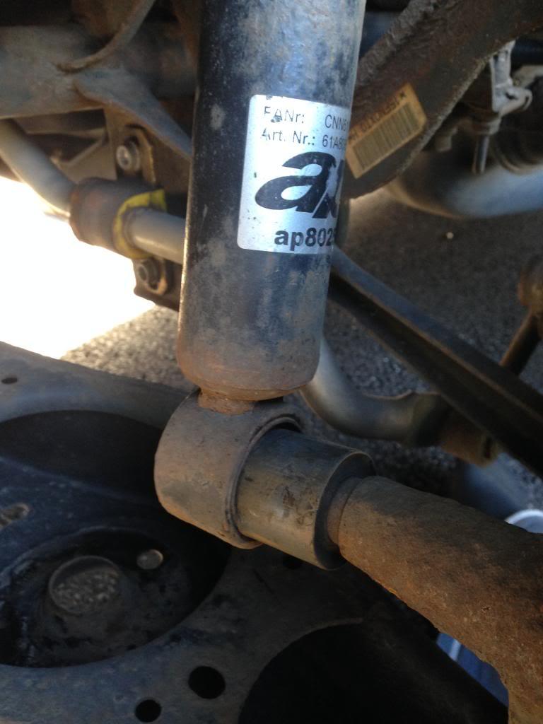

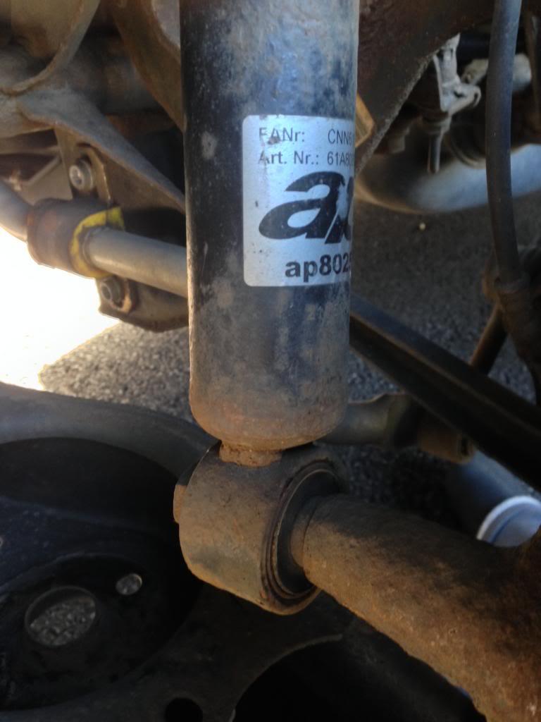

One of my AP rear shock absorbers has decided to die on me, the strut has completely come away from the bottom bush.
God know how its happened but it doesn't fill me with confidence. I need a replacement shock and ive rang around a few suppliers but no one seems to stock them in the uk. Ive been quoted 7day delivery from most people as it has to come from Germany. Does anyone know of  a quicker option?

uh oh.. is this not dangerous?  :surprised: how did you notice it, random inspection?
 :scared: Yes slightly...... I parked it up on friday night then came to drive it later on in the evening and it was making a horrendous knocking noise so got it back on the driveway and inspected it. Im pretty chuffing lucky I didnt end up alot worse off. Like I said I dont know if it a manufactures problem or just wear and tear?
