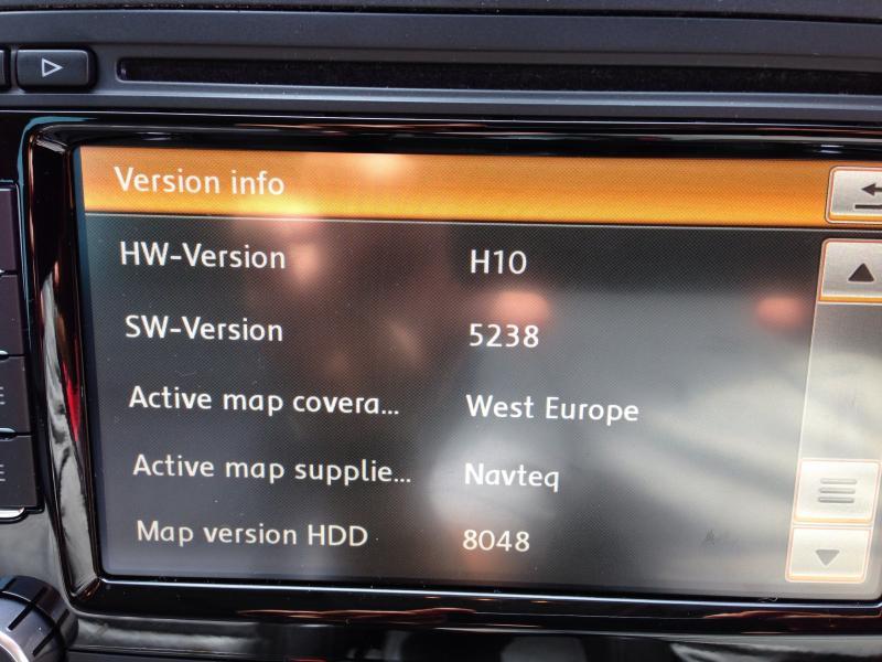

So am I right in thinking my firmware version is 5238?
My can gate way is 7N0907530S
Any ideas why I am still getting battery drain?
