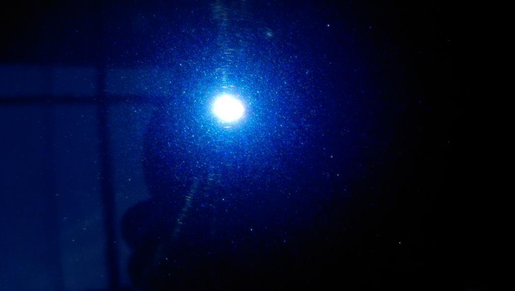

There is a HUGE difference between hand and machine polishing.
I wouldn't bother hand polishing, glazing by hand is fine but hand polishing, you simply cannot get an even coverage of pressure, effort and product. Machines work far faster and they are consistent so you can get a consistent result. I have seen horrible hazes from hand polishing especially if you're using polishes which have a long work time and take a long time to break down into their finer "finishing" particulate sizes.
A light source shows a million things... this is not a dig at anyone in particular, I'm just purely trying to educate people. you need a fixed light source on a panel in a position to highlight swirls, scratches etc. A side on shot shows nothing especially on a black car... LITERALLY none the wiser - amazing what a light source shows...
Wow jay that's really after opening my eyes. I'm almost Afraid to go on and put some light on mine it must be destroyed.
How naive I was to think I was actually removing the marks by hand :-/

You can remove scratches and swirls by hand but it's very hard work, and the finish is not as good because you can't get an even coverage and pressure as mentioned.
I'd stick with hand glazing using SRP etc. But these products do also work well via machine especially on softer paint, not that that really effects our Golfs.
You will get some improvement with a "hand polish" but personally not worth the time, just glaze it and wax/seal it until you can do it proper  :happy2:
Main point of having a light source is to see exactly what you're doing and what you're actually removing.
Just makes me laugh all the people who are like "just polished & waxed my car it looks SOOOO GOOD" and then take a side on shot with no direct light, that's just the detailer in me screaming out but at the same time people can take it the wrong way, not doing it to put people down but to hopefully show them and educate them to spot and work and improve on their paintwork :)
