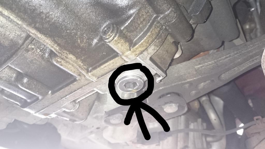

Hi guys, the gti was parked up for 2 weeks and i noticed small oil stain when I moved it. Why is it coming out of the below nut?

Gearbox oil sump??? Not sure! Just a guess

Gearbox sump drain plug.
Has the gearbox oil been changed recently or the car been in for a service?

Will probably need a new washer on the plug, or they havent fitted one, catch the oil if its fresh in a clean container fix the plug then refill it.

I would look higher up as it looks like there is more oil further up the box.

is your car DSG? could be the DSG oil maybe? just a guess
