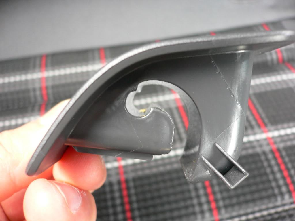

1. Remove Isofix plastic thingies, note the shape of the grooves in the picture, you have to press down and pull them out rotating the back/top towards you.

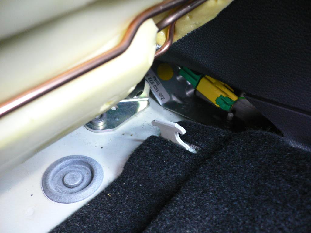

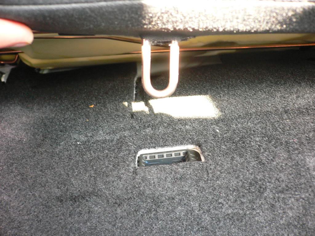

2. Remove base, there's spring clips on the front, so feel for their location to ensure you pull in the right place. There's also some more clips towards the sides as shown. It should now pull towards you. Get your fingers under the bit near the Isofix bars to free them up, if necessary.

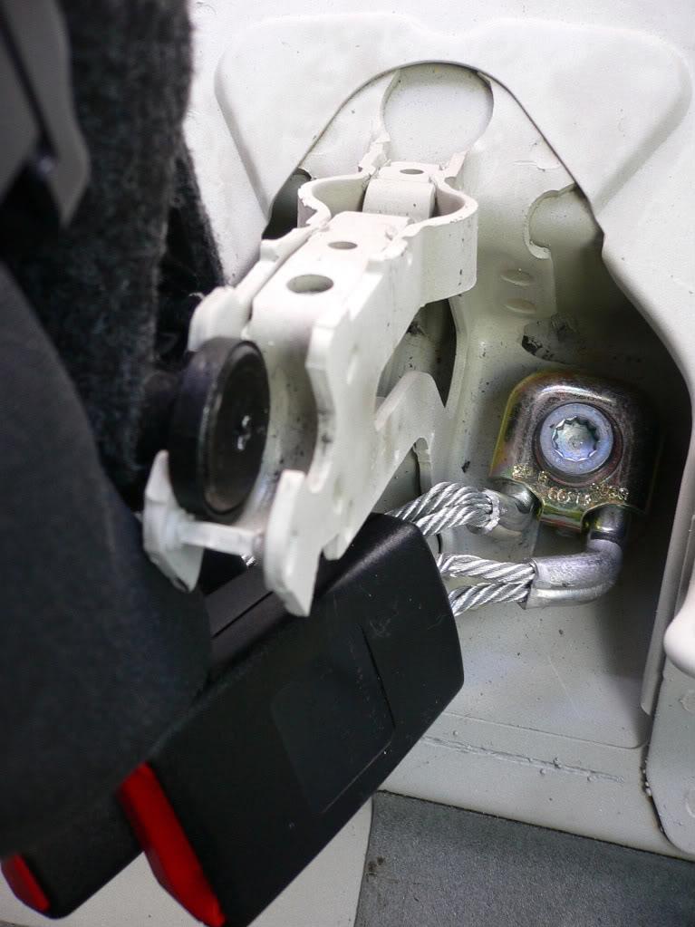

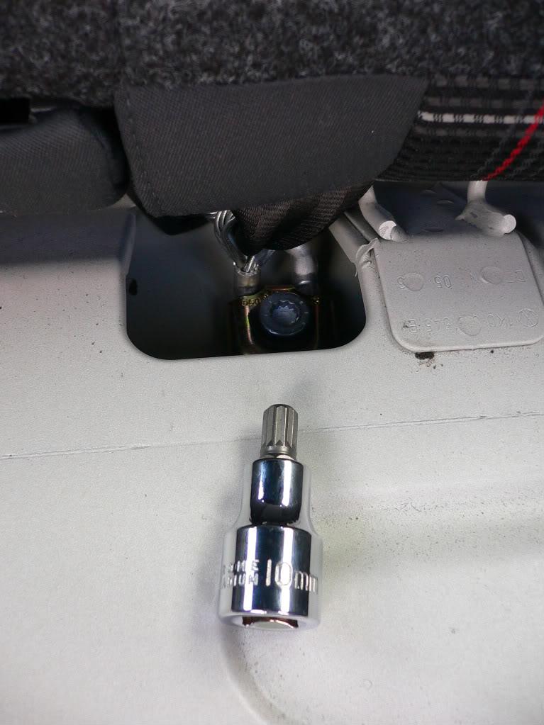

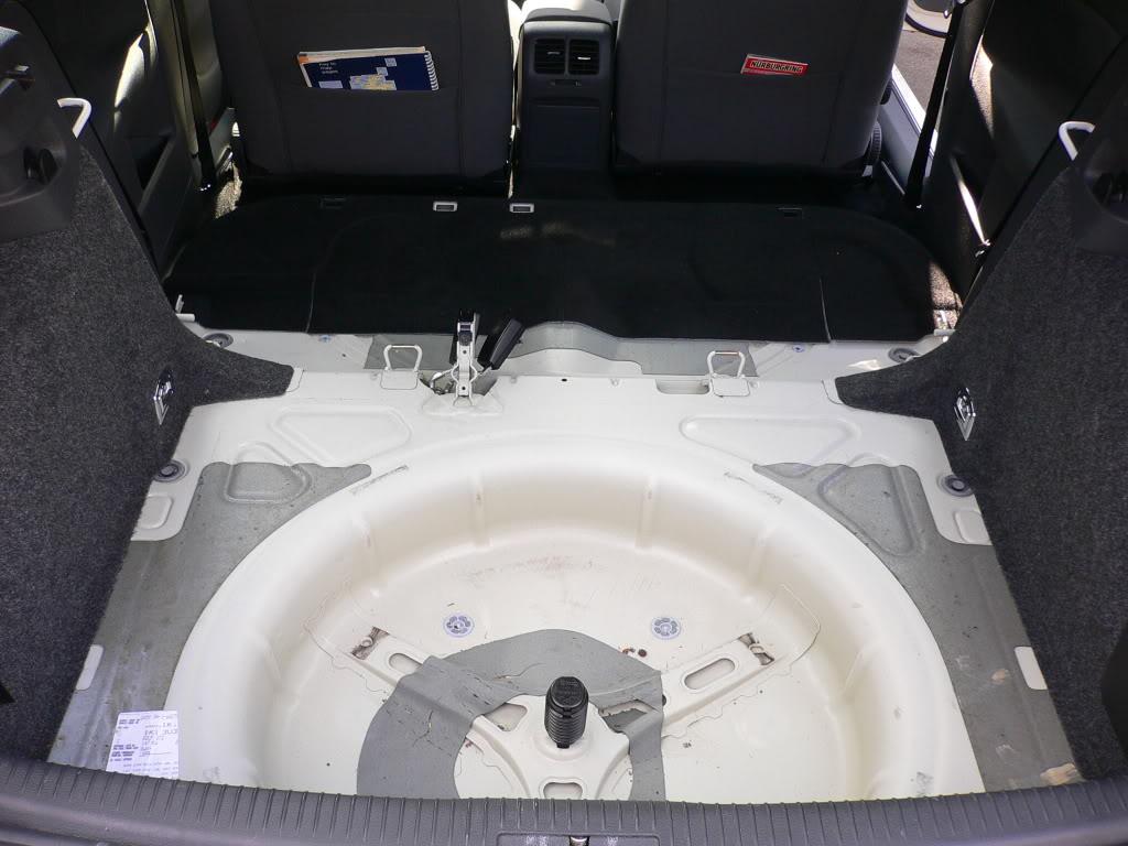

3. Lay the seat backs flat and using the 10mm spline, remove the seatbelt anchor.

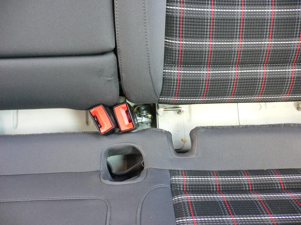

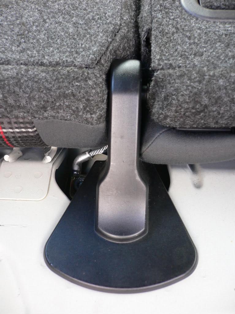

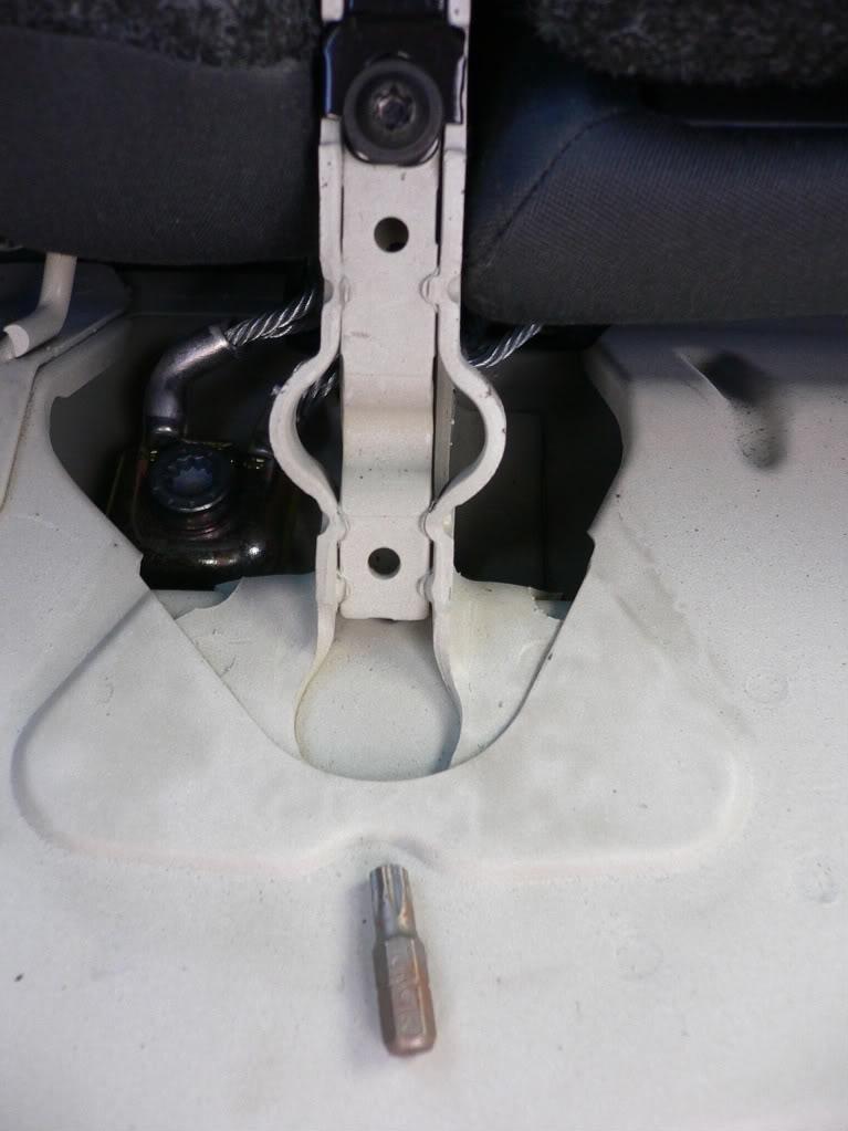

4. Remove the plastic cover for the middle hinge and undo the screw with the T30 Torx bit, then remove the black metal cover it secures.

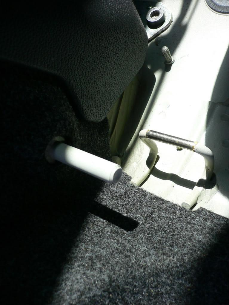

5. Pull the seats off the pins on the side of the car as shown... this is where you need the wiggle and it has to be the right angle.
