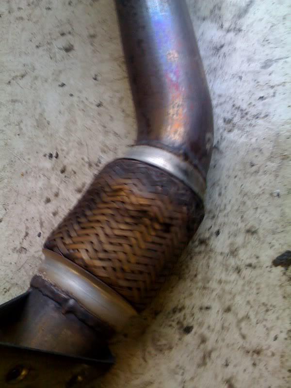

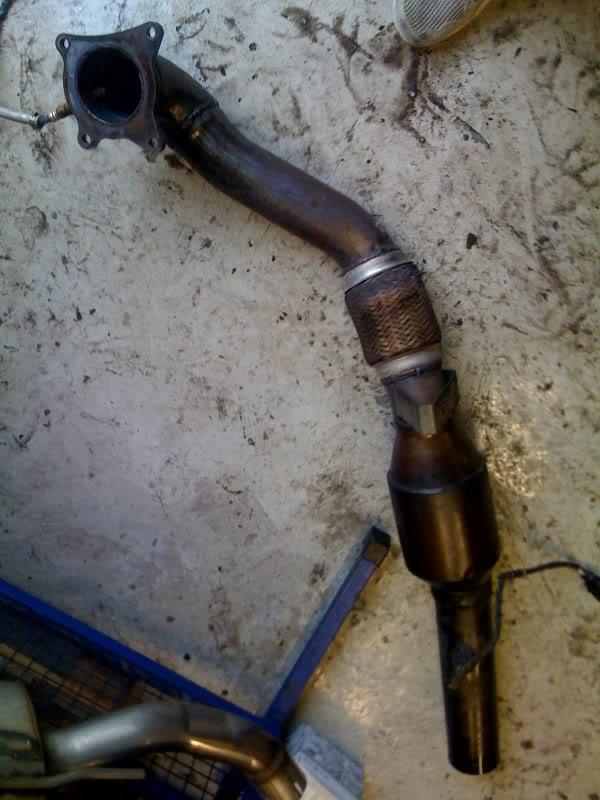

well its all fixed now - pic of offending pipe with blown flexi metal bit
normal boost has been resumed, my gauge was fluttering at idal and in 4th gear pulls i was spiking then dropping right down and then spiking again this has now has become stable - cant believe what a detrimental effect a blown exhaaust has on performance - only downside is how quiet the car is now  :sad1:

There is no getting away from the fact that the flexi is to short - compare it to the OEM.
blueflame flexi and oem as you say is much longer.
The shorter flexi on the milltek does appear to be its weak point
