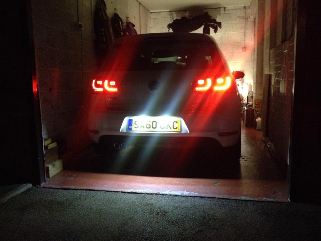

Thread update,
I decided to go with the one's SUG suggested in the end... These did come with quite a large resistor pack and a little loom that you plugged into the original socket which had two little plugs on... one for the resistor pack and the other that plugged into the LED light unit, I did try them without the resistor ... they worked fine but gave  the light out error on the dash so I plugged the resistor in and they work fine with no errors. I did end up putting a strip of double sided tape on the flat face of the resistor pack as it is rather big ... sort of thumb size with an aluminium case...  as I pushed them up into the bumper stuck them to the top ledge so they wouldn't be swinging around then just clipped the LED light unit in a 5 minuet job. I must say they are rather bright you wont miss them being LED when following ...
Took a couple of pictures with my Iphone so not brilliant but you can see how bright they are. Thanks to all who had an input  :happy2:

Looks good!  :happy2:

Hi, that's a great, crisp/fresh light, thank you for posting the pic  :happy2:

Picture is a bit rough tbh... I will try and get a sharper one.
If i'm honest they may be a bit too bright !!!
