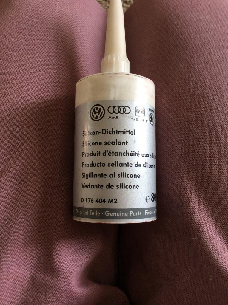

This is the part number for the genuine stuff if it helps
A long 5mm Allen key with 'wobble' end or a wobble extension with 5mm hex socket will be needed. As a couple of he sump bolts are a bit awkward.
