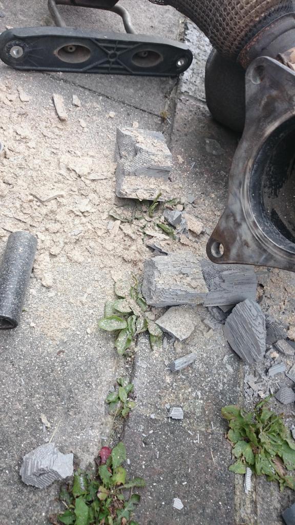

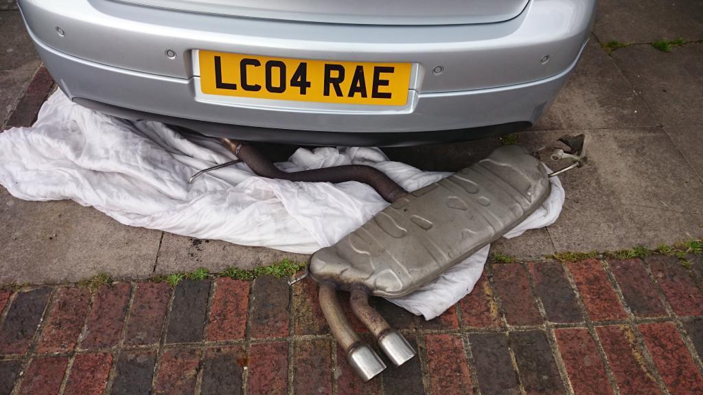

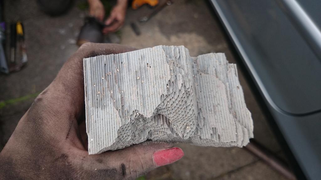

Finally got rid of my pre cat. I don't know why these things happen to me but my car just doesn't want to be modified. Everything I've done so far has been a pain and a struggle even for the simple tasks but its done and won't be attempting anything like this again!!!!
I ended up have to drop the whole exhaust system as I still couldn't get the clamp off.
Everyone likes a pic or two so here goes.
Reflex silver GTI, revo intake, eurojet dogbone mount and insert, colour coded rear bumper, projector headlights, revo stage 1, precat delete, cente resonator delete, R8 coilpacks, eibach sportlines, depo projectors, 4300k hid kit... Not finished yet

Great job! Looking to tackle this one vey soon! How did you find removing the whole system? Surprised you could get the down pipe through the front gap?

Just make sure none of the old cat falls down into the system, spent weeks trying to find out why a gti was down on power, turned out to be debris from when someone carried out a pre cat delete. It was clogging up the second cat.

If I had managed to get the clamp off the whole system wouldn't have had to be dropped which was fairly easy to get off but putting it back on was a different story, definitely a two person job. Getting the downpipe through the gap wasn't too bad just a bit of teasing and careful handling. I made sure no pre cat got sucked through by using a handy dyson  :happy2:
Also an old duvet was some help as I didn't want to damage my back box, centre box wasn't a problem either as that has previously been removed.
It's well worth doing as I have noticed a power improvement and she feels less restricted ready for revo stage 1  :wink:
