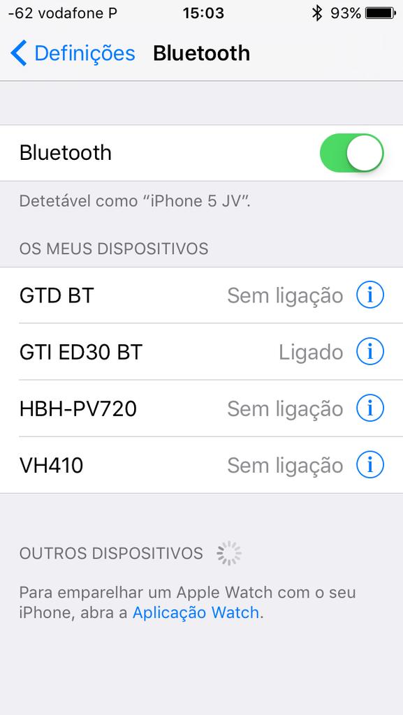

Was forgetting to mention that a friend sourced me a cheap used BT module compatible with iPhones, a 7P6035730F. He also made me the loom to connect to the radio and fitted all in place. I already had a microphone fitted and a foam holder from the Ed. 30 factory fitted BT module, so it was a really cheap mod to do as a surprise to my wife who was initially against it. Now that she can use the radio, cluster and steering wheel to control the phone instead of just a BT headset, she sees that it was worth it. :laugh:
Activated the BT emulation in the PolarFIS Adv. as @rich83 explained. Everything works as it should. The PolarBT module is just needed when we don't have a PolarFIS Adv.. Thanks for the tip. :happy2:
The BT module was from a SEAT so it showed in the phone as SEAT BT. Decided to change its name to GTD BT and later changed the Ed. 30 BT module name too (it showed as VW PHONE). :laugh:
