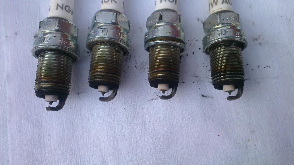

After a bit of Googling I found a couple of websites with some saying plugs or coil packs could be possible issues. I started by swapping coil packs 3 and 4 over so see if the misfire transferred. It stayed on cylinder 4 so told him to get some new plugs. Fitted those yesterday but it is still the same.
My knowledge on these engines is quite limited so I'm just wondering if anyone else may have some ideas of anything simple it could be. He is thinking of getting rid as he reckons red cars he owns are always cursed haha.
@vRSAlex Here is a photo of the plugs that came out. I was expecting number 4 to look different to the other but it didn't. Any ideas? :confused: Appreciate your help over the phone too the other day  :happy2:

Most probably an injector failing  :sad1:
Getting more common on K04 engines cars
Saintsteve
Re: S3 with a misfire
« Reply #4 on: October 02, 2014, 08:36:12 pm »
Injector all day long :happy2:

Don't use s/hand injectors.
PSI sell a set of 4 for under £500.   I doubt you'll get cheaper than that unless you have special sources.
There won't be any piston melting going on, don't listen to such nonsense.  It's only at idle.  The nozzle has gone a bit lazy but is fine with higher rail pressure.  Might be able to free it off with a Terraclean but personally, stick a new set in.   It's just the nature of the beast.   Walnut shell blast the intake ports whilst you're there.  Special tool required for injector removal, which Laser Tools sell.
