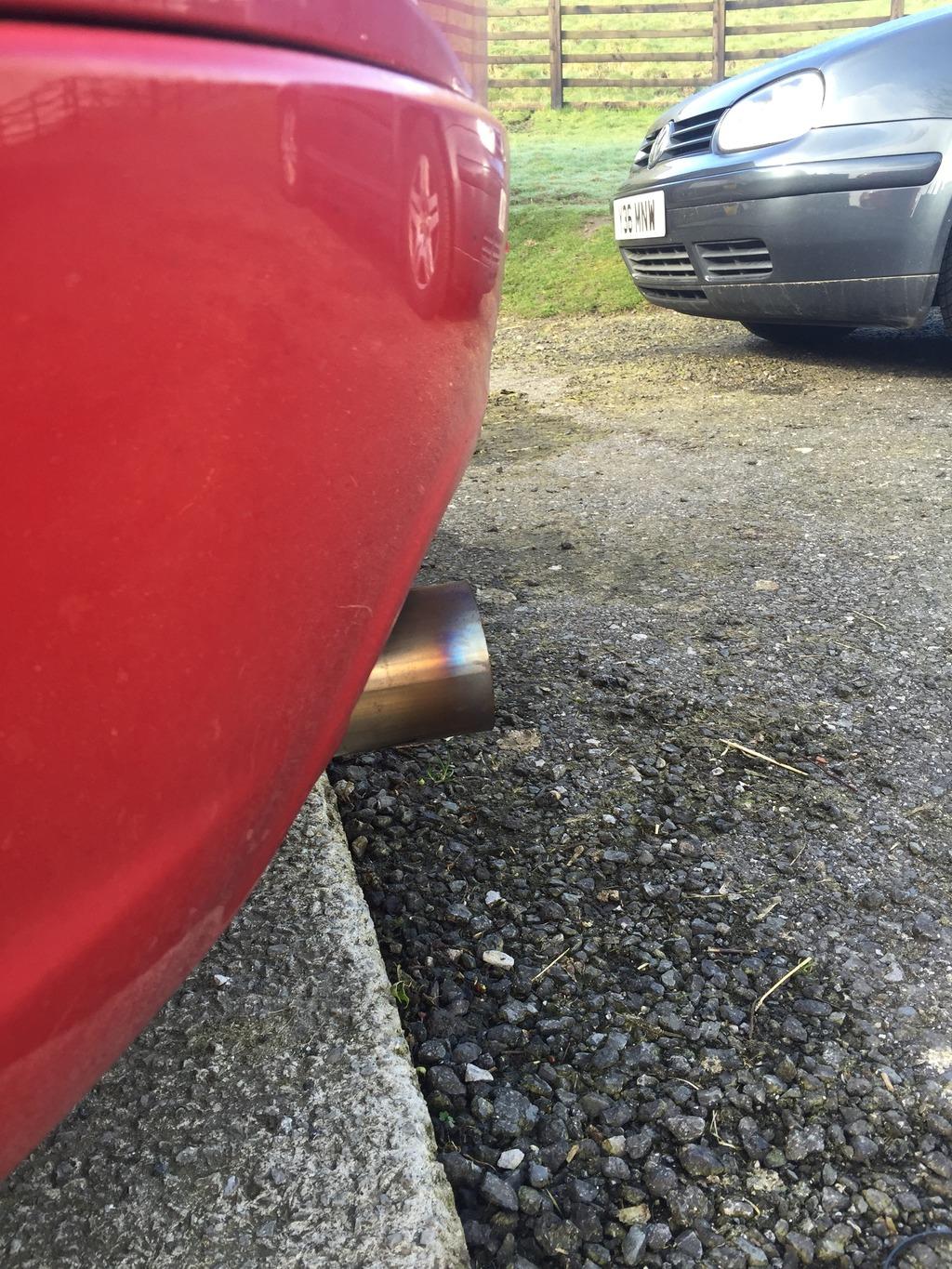

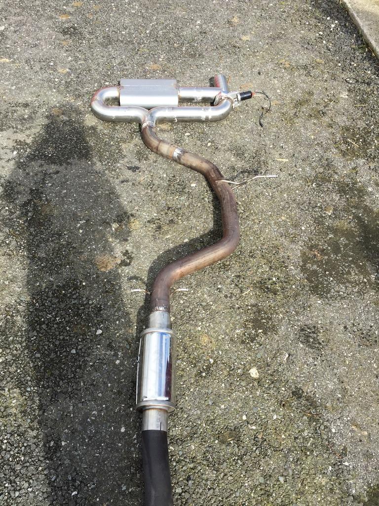

Finally, over the last couple of weeks I have been building my own 3" Stainless exhaust system. I wanted the car to sound great when I wanted it to but I didn't want it to be intrusive. So I designed a stepper motor actuated valved system which allowed me to more or less adjust the tone of the exhaust.
First thing to arrive was the valve which I got from California, as you can see it was integrated into a stainless section which I didn't end up using.
Next up was the silencer and muffler which I got from Demon tweeks.
Silencer: Jetex/Simons 250mm 3"
Muffler: Flowmaster Pro Race 50 series 3"
I then went to a stainless steel suppliers and bought a load of 3" tube and bends. I had already drawn up the design so next thing was to make a cardboard template, the design changed slightly from what is pictured.
Once I was happy everything was right I cut all the tube to size and tacked it all together. (to all you weld nerds I am well aware my welds are terrible but it is my first attempt and I was welding stainless with MIG!  :ashamed:)
Here is the system fully welded, the orientation of the valve changed to allow room for a hanger.
and a shot of it positioned under the car
The hangers were then tacked on and it was fully welded up.

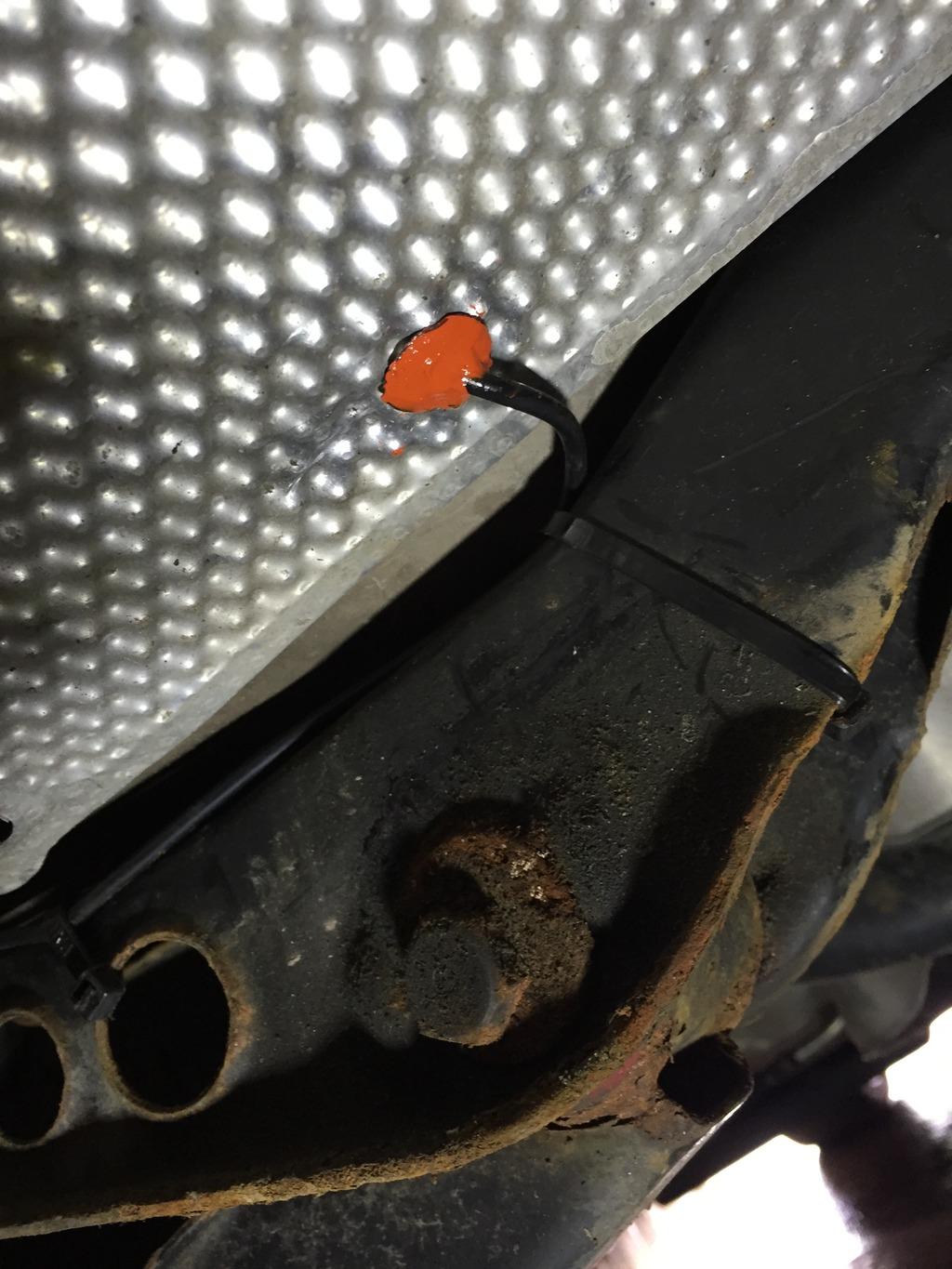

The switch was installed in the ashtray and the wire was routed to the back and through the wheel well with a gromet and silicone.
Here is the system installed, Please note it is not fully finished yet. I am undecided on what the plan is for the exit, im going to set a poll up and see what you guys think.
4" single exit (modified r32 bumper)
Twin 3" exits (modified r32 bumper)
It sounds insane with the valve open (silly loud rally car style :party:) and when its shut when on WOT I would say its quieter than the standard pipe, a lot of turbo noise though.
