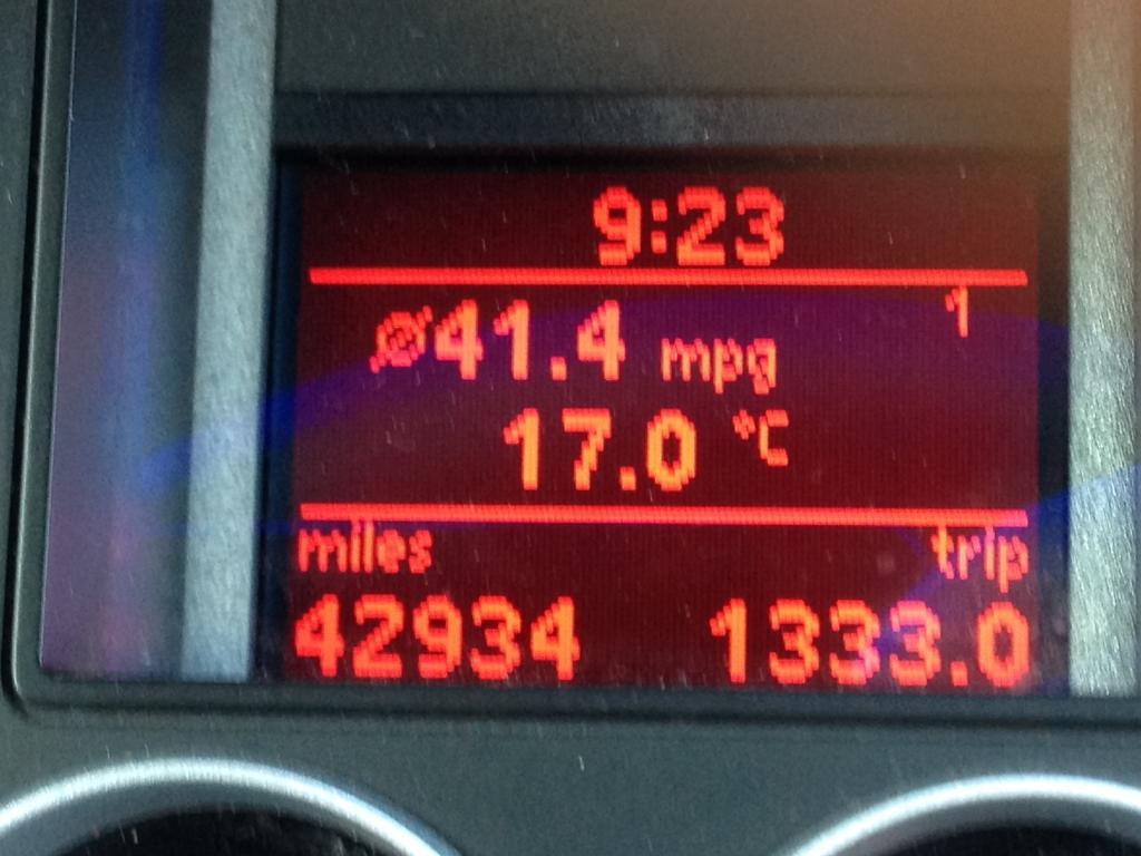

Just a quick one lads. Are the dashboards interchangeable or do they need different models etc?? I have the basic one in my pirelli but like the r32 dash and also the dash that shows the doors open etc
Hopefully the pics works that's my boreing dash.

What your after is a highline dash! You currently have midline. There available in both R32 & GTI clocks. It's a great upgrade. Some more info here
http://www.mk5golfgti.co.uk/forum/index.php/topic,33055.0.html
Can get a bit confusing, basically you need to find the last 3 digits of your current clocks which will be either 960-961-962-963-964
The replacement highline will be 7 in place of the 6 ie 972 instead of 962
The last digit the higher the later their manufacture, the new highline must be the same last digit or higher. Ie if you midline is 962 you can fit 972-973-974
