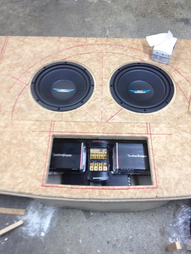

Looks like a nice tidy install, can't help but think the box is slightly small, have you worked out the size of it?
Originally, the box was too small, As it use to be 0.88 and with the displacement of the subwoofers I would have ended up with 0.78ft3. Which is still fine but does create a little peak frequency.
I extended the top lid to allow for exactly 1ft3 which means after the sub displacement and sound deadening to go into the box. Will leave me with approx 0.86ft3. Which is exactly what I'm after.
From personal experience I found that to be the best compromise for sound vs performance and still sound really nice.

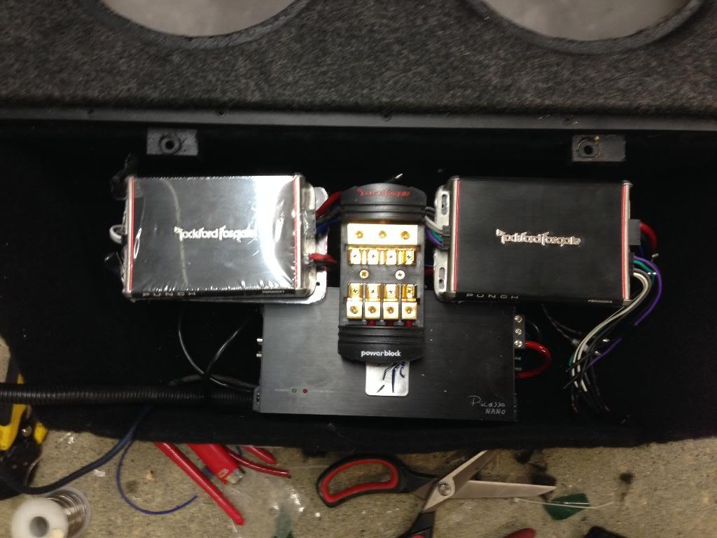

Then went on to install the MS-8. Which is now all installed. Just hoping for some miracle that even thou it's literally brand new, it will work!!!
Also figured out the heights of the amplifier and distribution block. So Cut down some 2x4 and the mounting base.

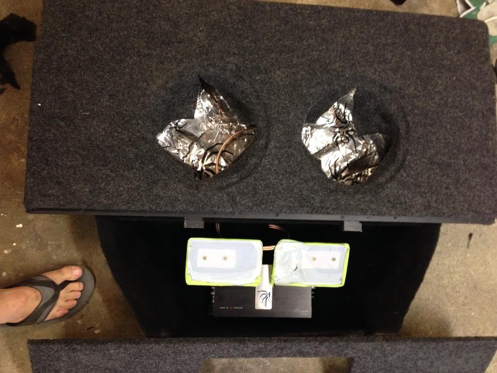

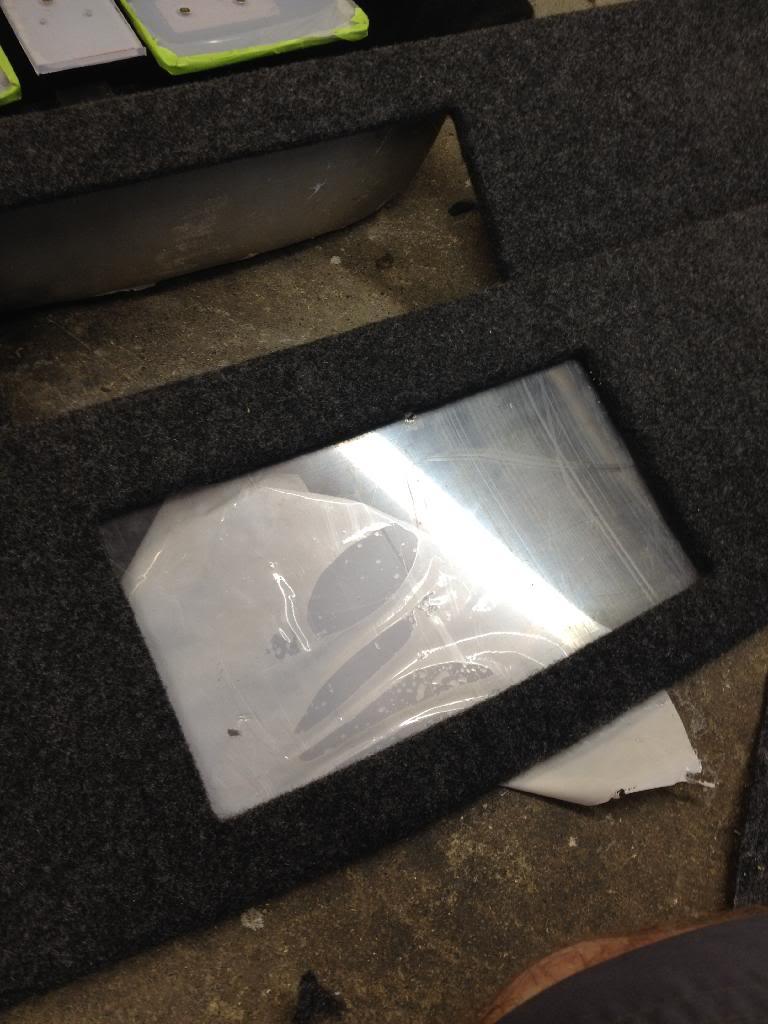

As for the amplifiers mounting boards? Well I had more than ample perspex left over after the window for the lid. So I cut 3 amplifier mounting boards and 1 distribution block plate.
Additionally, I drilled holes thru the distro block's mounting 2x4, so that I can hide wiring as much as possible. No photo's of this I'm afraid as my phones battery ran flat earlier in the evening.
Mounting plates at final heights first photo debut.
Here is a photo of the box wrapped. As you can see the white plates is in fact the clear perspex. Cut it down with the Router. Again no photo's I'm afraid.
Here is the lid with the perspex window.

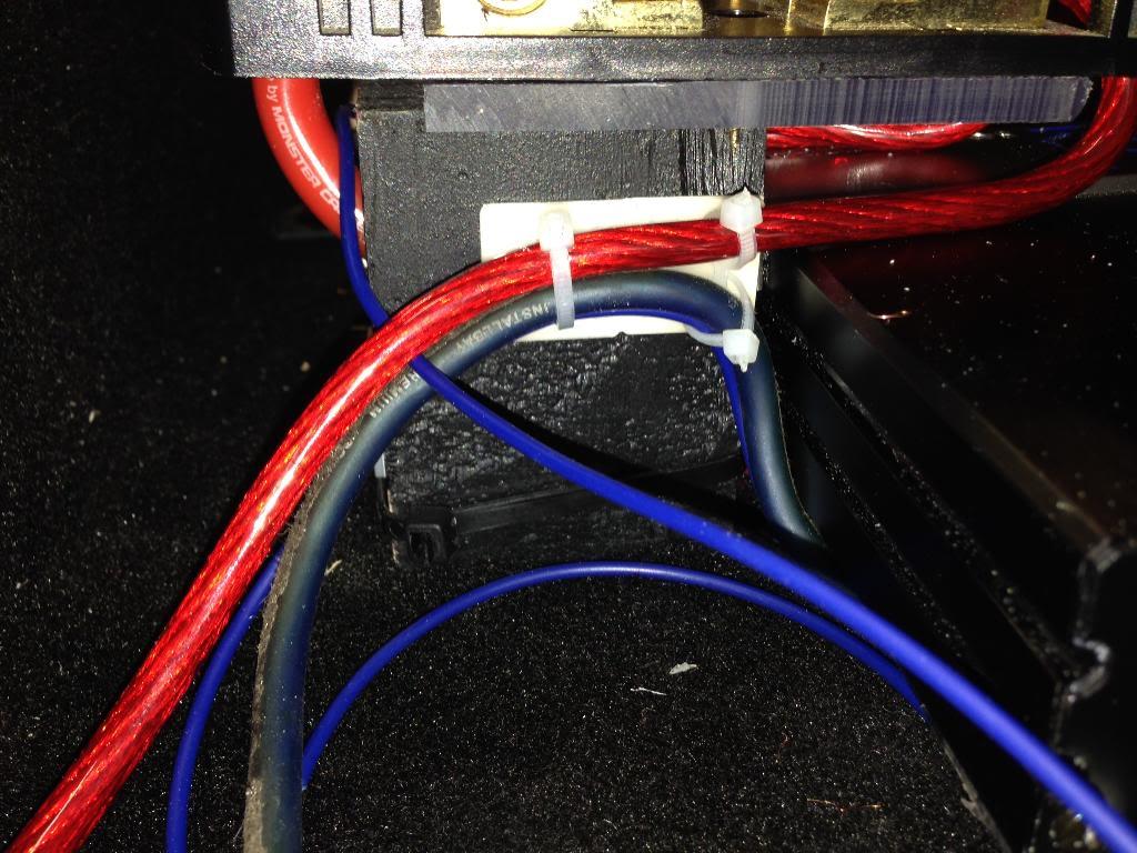

All the lids covered. My source for the vinyl did not come thru. So I had to go 90's look with all carpet. May have found a new source today. If it works out, than I will redo some of the carpet with Vinyl
As I painted all the pieces of 2x4, I decided to get some stick down cable connectors.

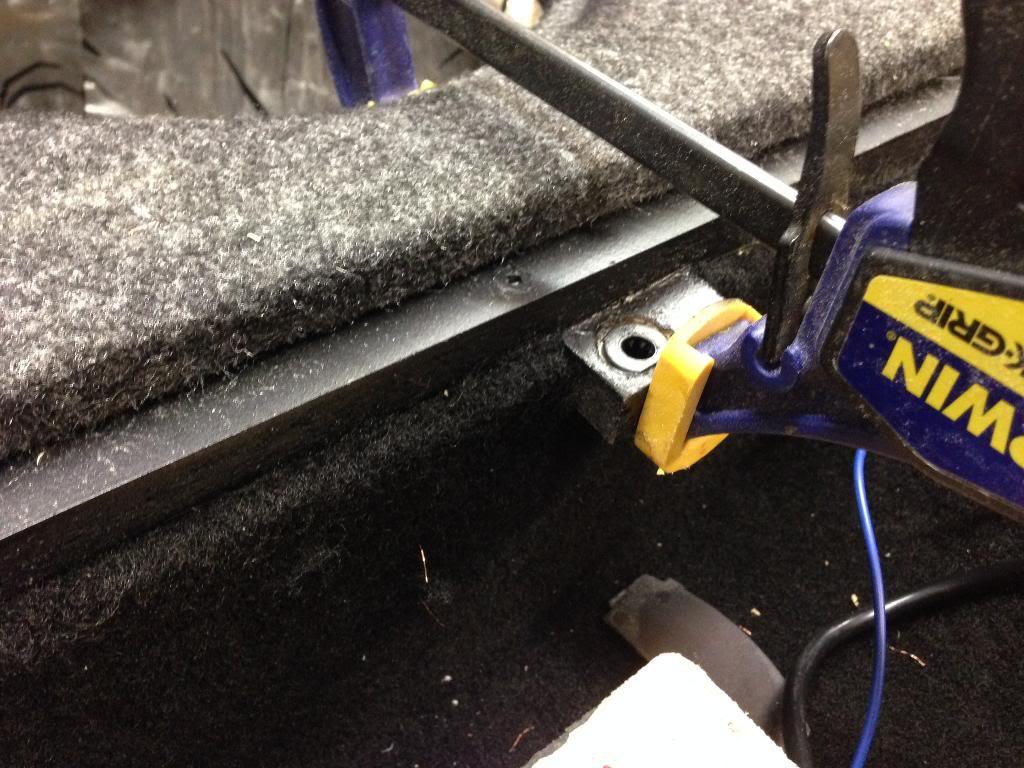

Then I remembered that I forgot to add the mounting points for the Lids. So I had to work with the existing carpet and drill holes. It damaged the carpet on on side, so I had to cut the carpet off and remove. Then recover only the damaged section with a new piece of carpet. Will add photo's tomorrow.
I also had to add some mounting/location points. In which I used speaker grill clips.

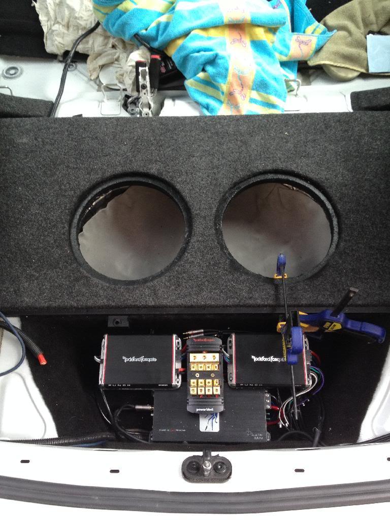

This afternoon, I decide to install the box to insure I could run the required cabling where I wanted to. For the most part, it went well. Until I came to install the speaker wires.They are just to short. By only 10-16cm's. That was really annoying.
So decided to call it a day. So will continue with the install in the next 2 days.
