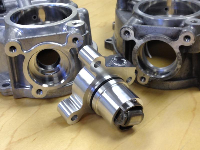

There's 2 upgrades available:-
This one -
http://hpfpupgrade.com/Products/Show/Volkswagen/2.0T+FSI/VW+FSI+Performance+Cam+Follower
And a kit from INA Engineering which replaces the cam follower with a roller follower from the TSI engine.
Neither are proven, so the best bet is regular oil changes and check the follower every 2nd oil change. It's not a lot of work to change and cheap. So far there isn't a better, permanent, solution.

I think BDM used the roller follower in their S3 build.
They say that this kit is a "fit and forget" solution to the high maintenance, problematic OEM fuel pump drive system.
