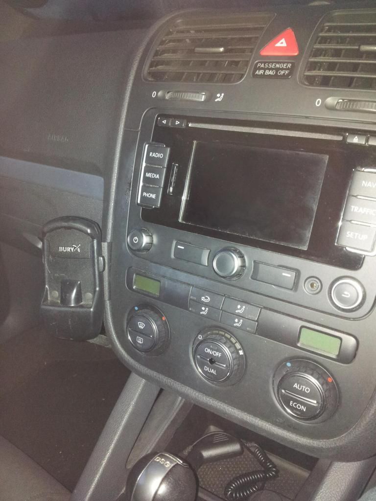

Oh right ok thanks - does that mean it is possible to make it work? I can't discover the Bury via bluetooth, is there something special I need to do?

I think it's probably because it's not a Bluetooth kit. You connect the handset to the cradle to physically make connection to the kit, rather than Bluetooth connectivity. The cradles are handset specific and (probably) no longer available as Bluetooth is more common these days.

It needs the cradle attached for it to be searchable via bluetooth, this bit http://www.amazon.co.uk/THB-Bury-Take-Talk-Cradle/dp/B000HHDLKC

Is that the same as the cradle in the glove box? Thanks

Yep that's it
