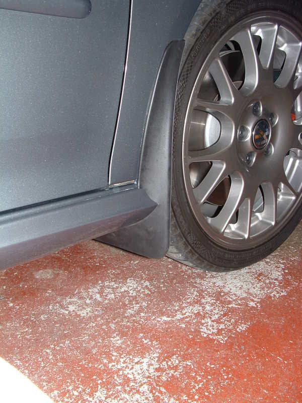

When you fit the fronts, a tip from me, is once all the screws are out, offer the mud flap up, and make a note of where the holes in the arch liner appear in reflation to the holes in the flap.
Then take a round file and elongate the holes in the direction required, and you will get a superbly fitting mud flap, with no gaps around the body work, and no movement to cause scratches.

They look spot on Gaz.Did they come with the car or have you fitted them please ?.And do they just bolt straight on with no mods etc ?.Cheers.  :happy2:
Yeah mate , they just bolt straight on, no mods. :happy2:I got the dealer to fit mine as part of the deal when I bought the car. Sorry don't know the part numbers though :driver:

I have wanted to get a set for a while, but not sure how they will look with a colour coded skirts, dont like the black sides on them.
E bay has them every now and then, seen them for a set of 4 at about £60.
