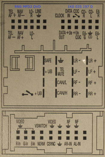

Hi all. Iv looked through a few threads but can't seem to find what I want. Iv just got a mfd2 sat nav for my golf and I want an aux point putting in but I'd like to have the aux point next to the tc and winter switch in the console so it looks more like a oem install? Is this possible or are there any other options? I have an ipod but also a samsung s5 so want something I can use both with or maybe plug play and charge the ipod?

You can get one of those from ebay or aliexpress.com.

Iv seen one on ebay but it states in the description it's for the rns 510 and I don't know if they are the same connection or not

It's not the same, you'd have to change at least one wire, because they have different pin placements.

This kit will work and probably has instructions explaining where you should place each wire depending on the headunit you have:
http://www.ebay.co.uk/itm/221588394023
Just follow this pinout image:
Just not sure about the rear plug. I know it has to be a 18-pin connector and that item from the ebay doesn't have this:
You can always get the correct 18-pin connector and fit in the ebay aux-in.

That's the one iv seen just wasn't sure if it would fit the mfd2

I think you might need to fit the 18-pin plug I put above. If you get the Aux-in adapter that you can found it on electronic stores, I'm sure you'll be able to retrofit the Aux-in like you want to.

OK cool. Thanks for your help. I'll use that for now and then see if I can retro fit one in some how
