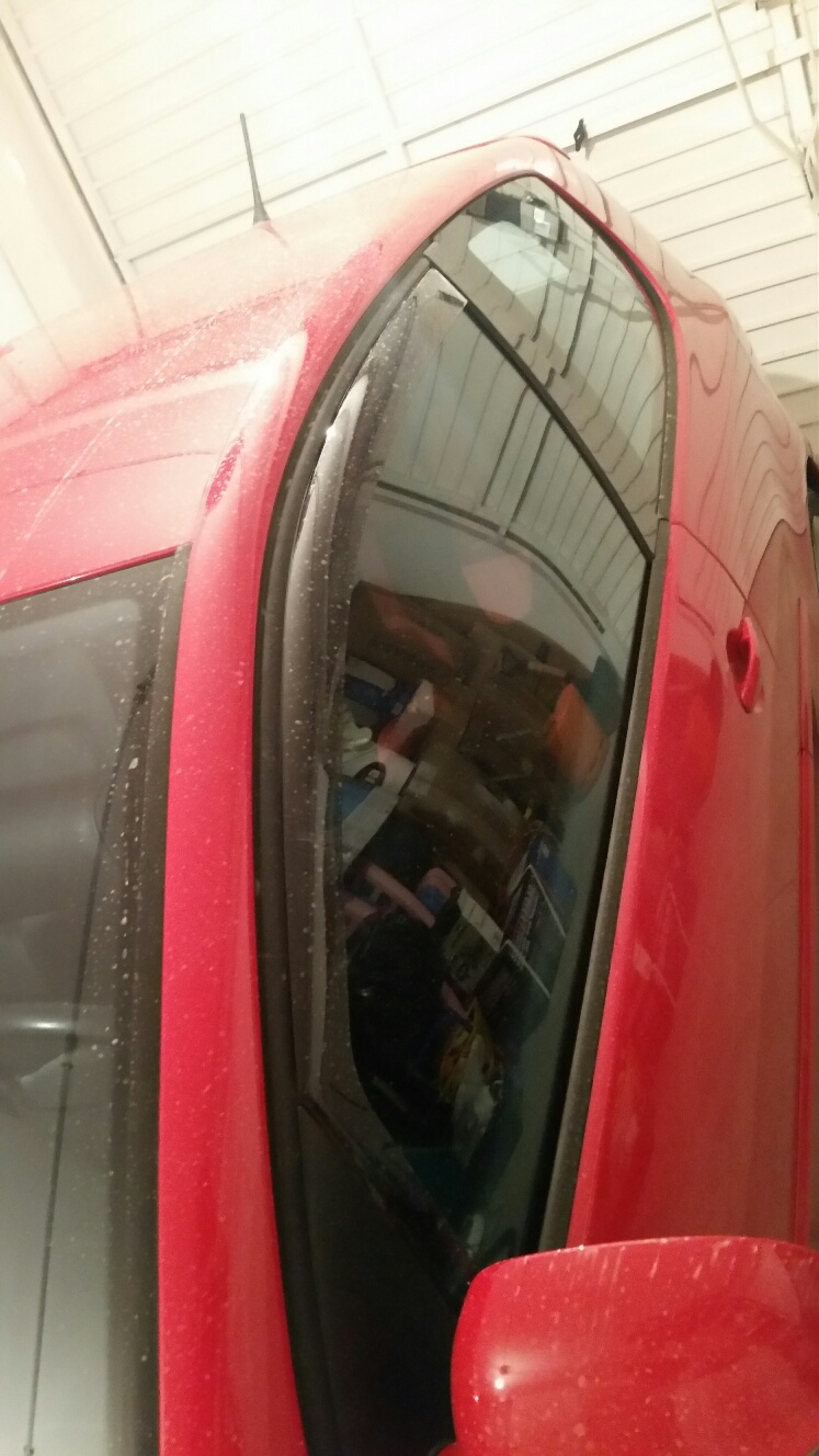

Did manage to fit the Climair wind deflectors this week. Fooking expensive but i do like them.

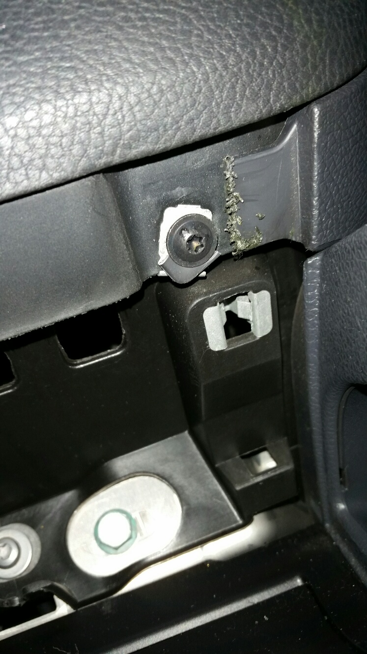

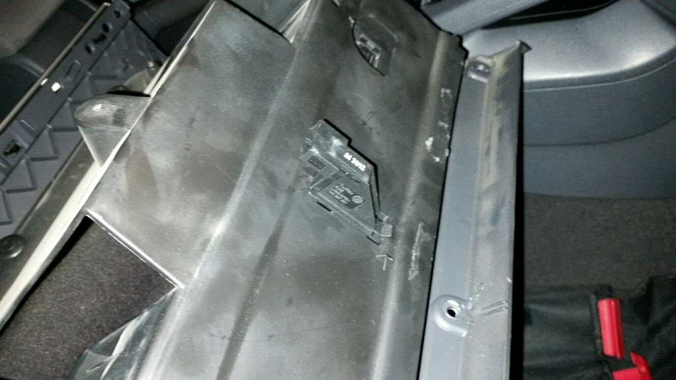

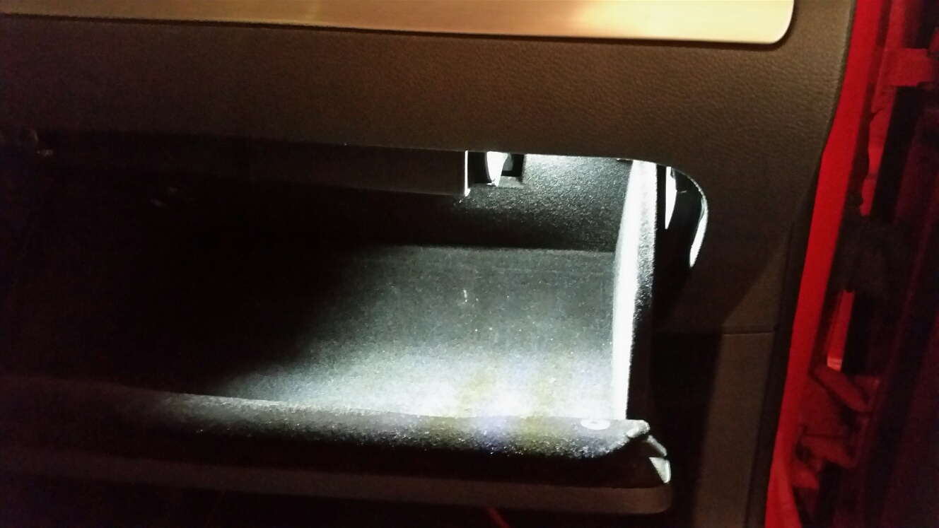

When installing my interior LED's i noticed the glove box light was not working.
There was no switch on the back of the glove box which was a bit strange.
Took the glovebox out today its been removed before and someone made a complete mess of it. What job would need the glove box removed?

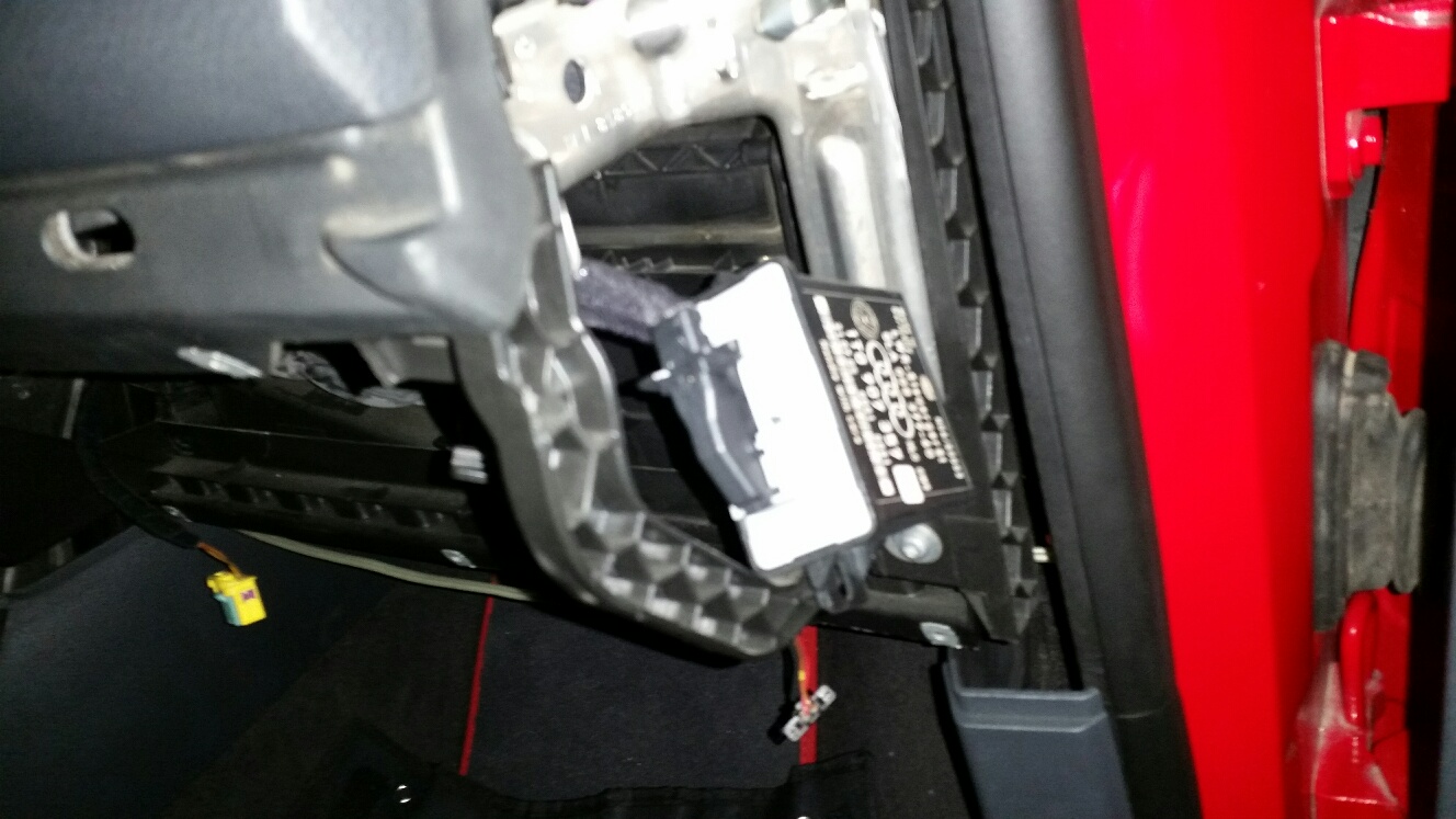

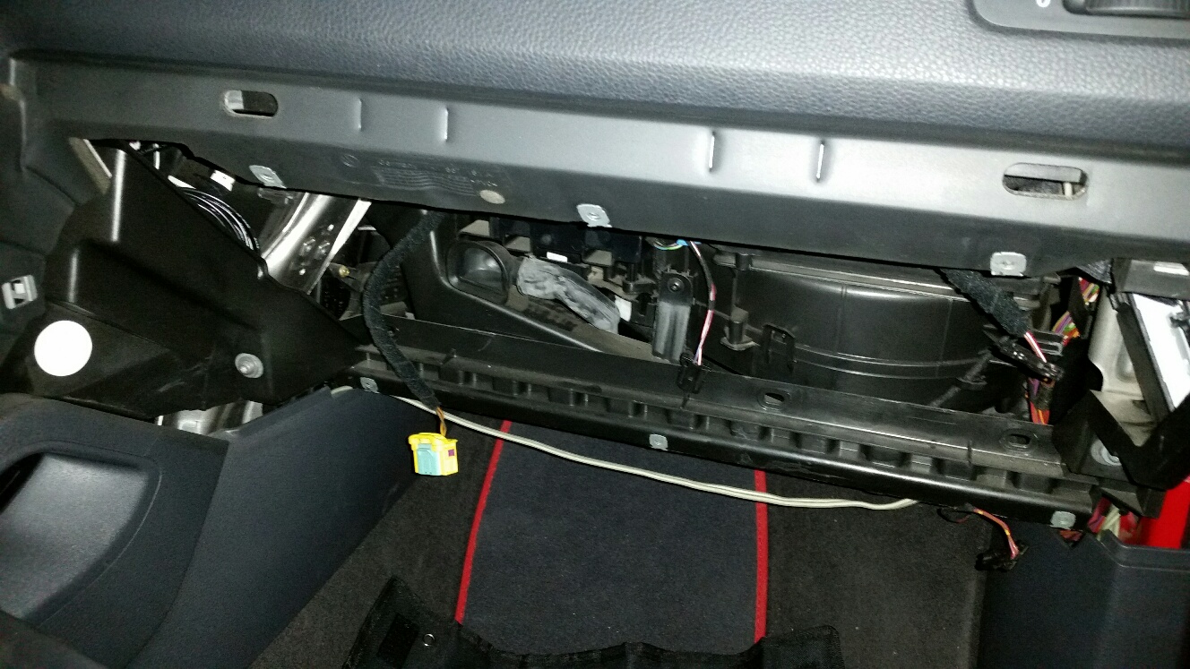

The screw above the ashtray was completely sheared off 2 of the remaining screws were missing a controller that should be secured to the side of the glovebox was just flapping about ( i think it has something to do with the airbag as i says handle with care  :confused:) Also ac pipe for cooling the glovebox was not attached. Should there also be a trim piece that covers the cabin filter??
Installed new switch now working as expected.

Yes there is supposed to be a cover over where the pollen filter goes. Mine was also missing when I bought it in February.  I'd get it replaced before winter comes round because it lets in a massive draft behind the dashboard. The car gets very cold if your driving at decent speeds.

What on Earth has someone done to your GTI? :confused:
I think there's a module behind the glove box compartment, other than that I don't know why someone would want to remove it? Just to pass cables it's not really required to remove it...
The cabin filter has a kind of foam cover, fixed by two plastic screws.

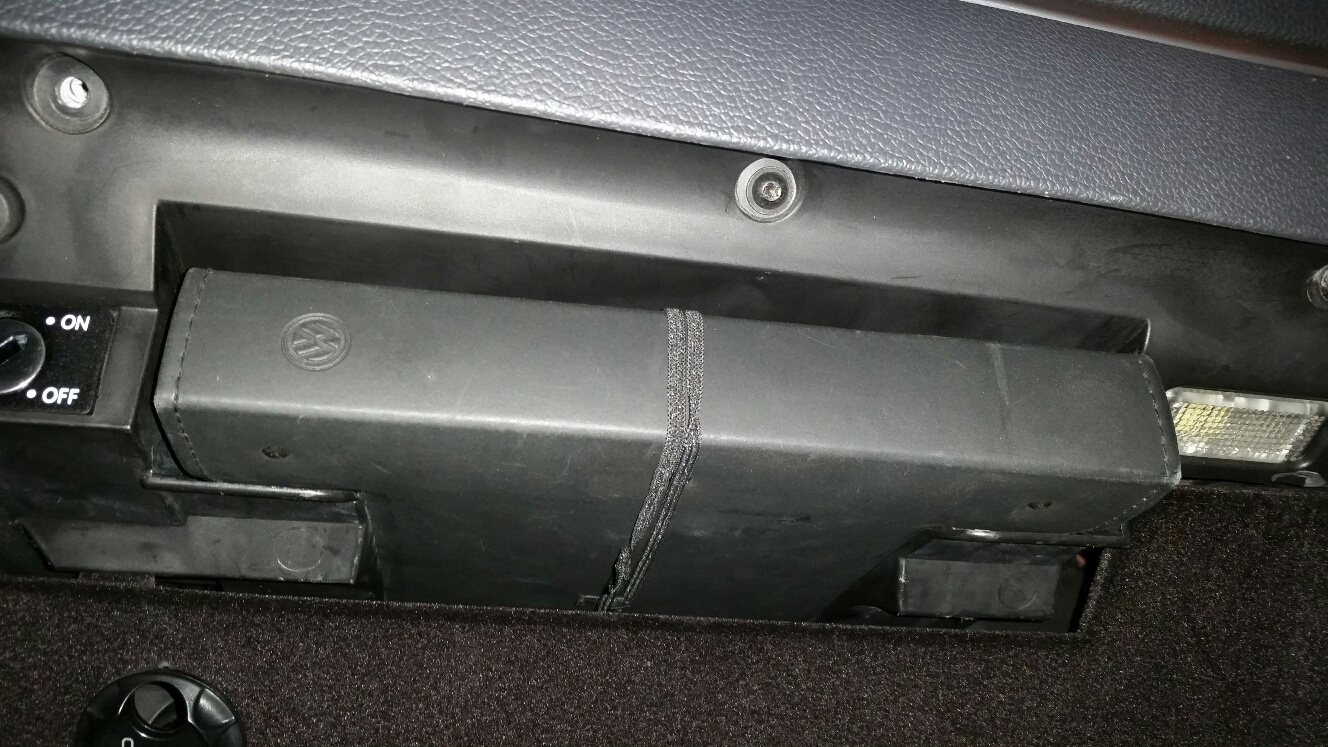

That module that was flapping about is an afs module to do with autolevelling on xenon lamps.
Just cable tie it to something.
Thanks mate i cable tied it. Why have handle with care if its for the xenons?? When i was pulling the glove box out i thought i may get an airbag in the face.
