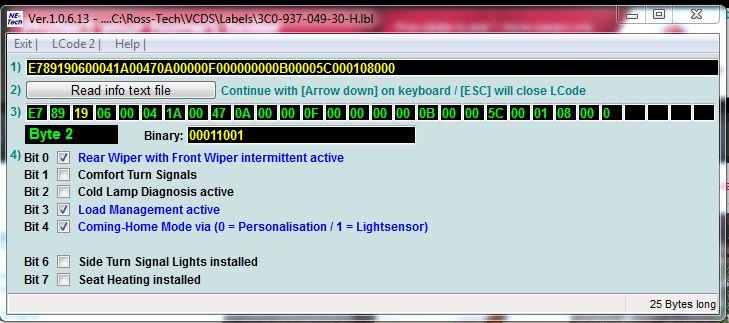

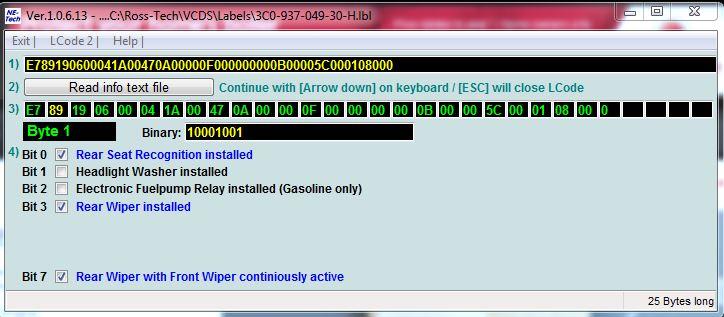

BTW, can you post here your scan from address 09. I need your your codding and P/N
There is example from my old car. Your one can be similar
Byte 1 - Bit 3 and 7 - Untick
Byte 2 - Bit 0 - Untick
Also Change the coding in Address 16 - Steering wheel. Last digit change from 2 to 1.
