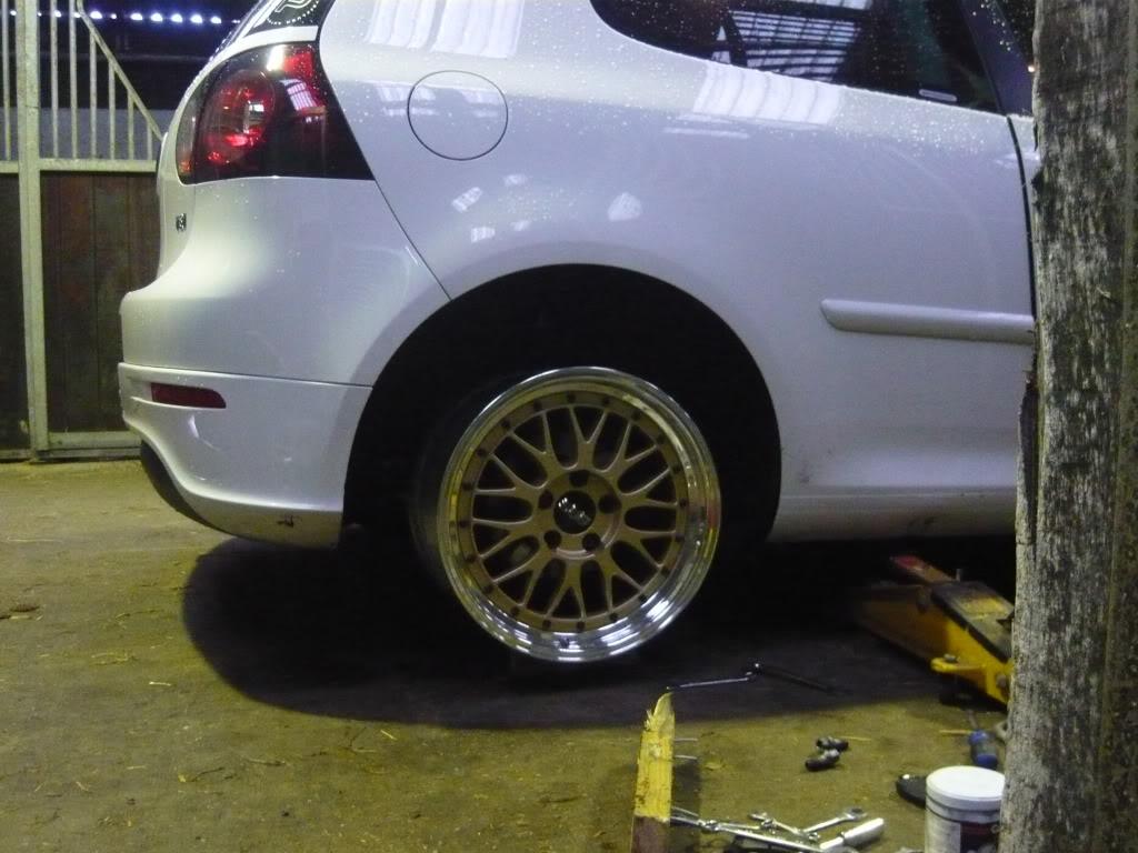

yeah they are genuine lm offsets/ widths are Front: 17x7.5 et38, Rears are 17x9 et35.
its gonna take some tweaking to get it right but should look pretty good when there on  :smiley:
thanks for the comments  :happy2:

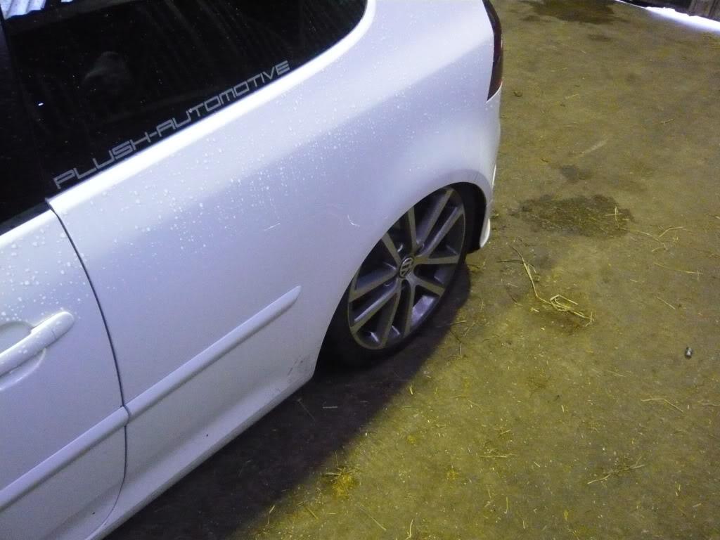

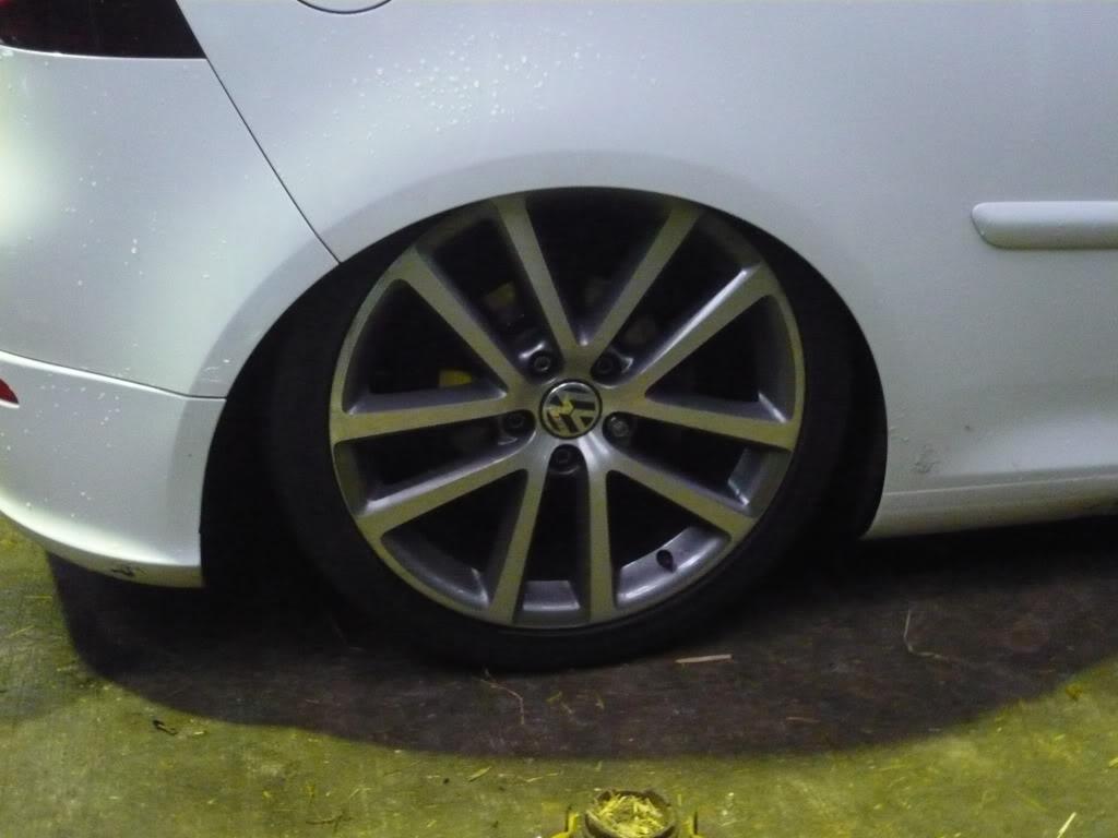

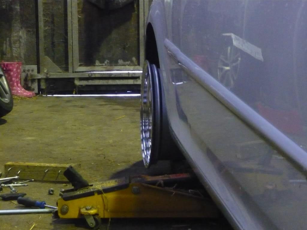

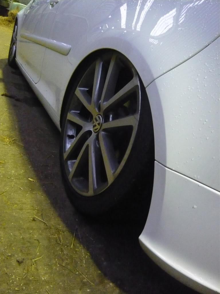

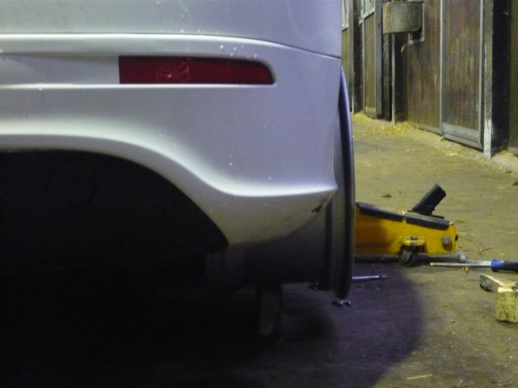

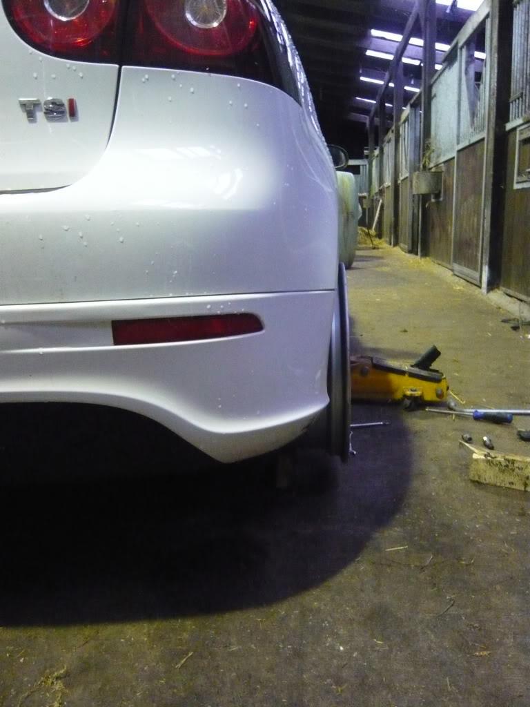

managed to make the rear end drop about another 3/4" by removing the bumpstops, still got the little rubber insert which sits above the bumpstop so its not totally gone   :evilgrin:
getting closer  :grin:
tried the new wheels at the back, if anything im going to need a 10mm spacer as they stick out about 15mm with about 50psi in the bags. once lowered they will lean/camber in and looks like they are goin to be very close to the inner arch.

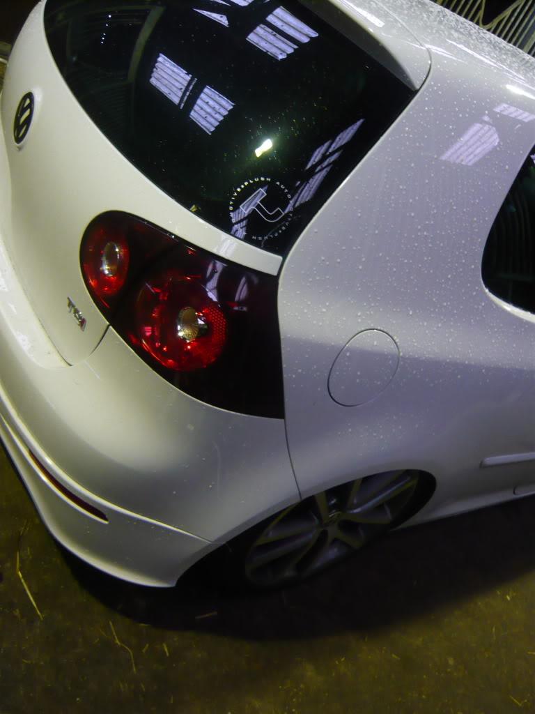

also got a few random pics seeing as it was sunny for a change  :happy2:
« Last Edit: December 06, 2009, 04:38:59 pm by DubwayDan »

make sure you dont blow a bag out dude with removing the bump stops. we cut them down to the recommended spec with the bags so that it doesnt let the bag compress to much. Looks sweet though man just giving you the heads up dude. :happy2: :happy2:
