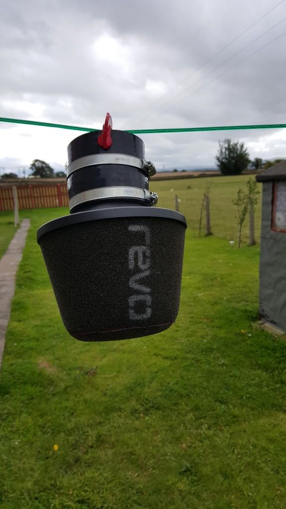

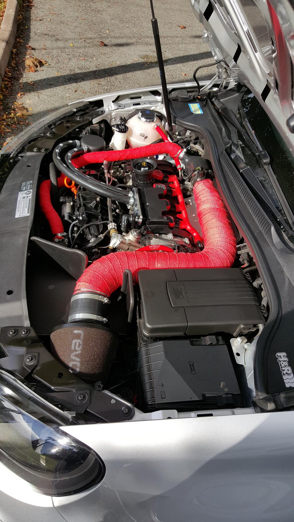

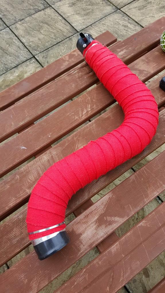

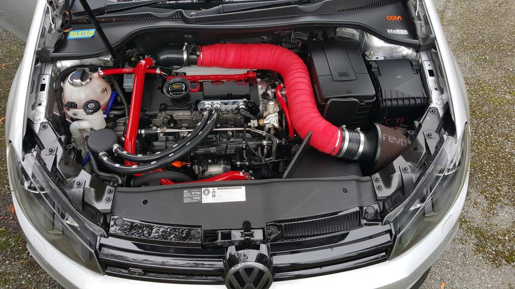

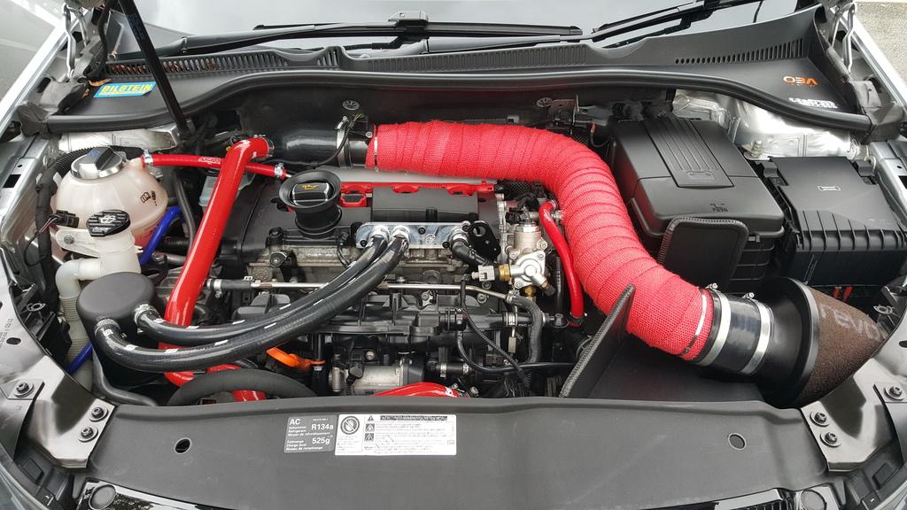

bored over the weekend so wrapped the revo pipe in heat tape and exhaust wrap then cleaned and re-oiled the filter
bum dyno,the car felt a bit more responsive so worth the £20 outlay

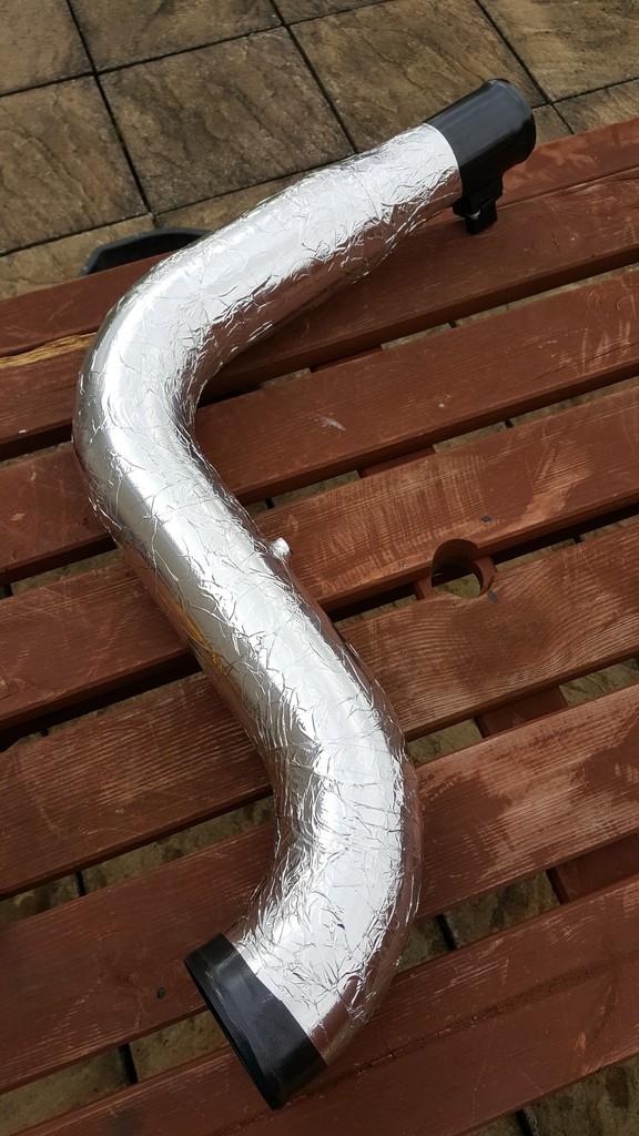

gonna wrap the dv pipe also,suprisingly warm after a bit of spirited driving :innocent:

Well ended up wrapping the dv pipe in the left over exhaust wrap as had no other use for it lol

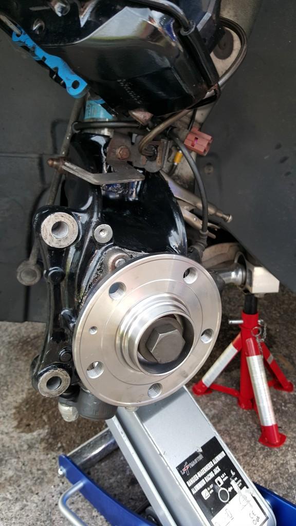

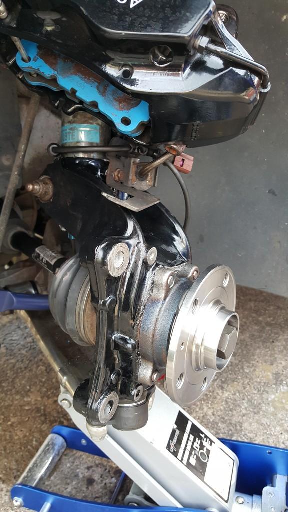

Finally finished the hub swap.... a long story which i wont go into but its done,ill fit new track rod ends before wheel alignment then the whole lot has been new and will last for years to come:wink:
original steel hubs off and weighed are 8.8kg's so i saved 1.7kg's per side,nothing major but with the brake upgrade weight savings a total saving of 8.2 kgs per side on the front and savings on the walk kit and superpro arms it was well worth it

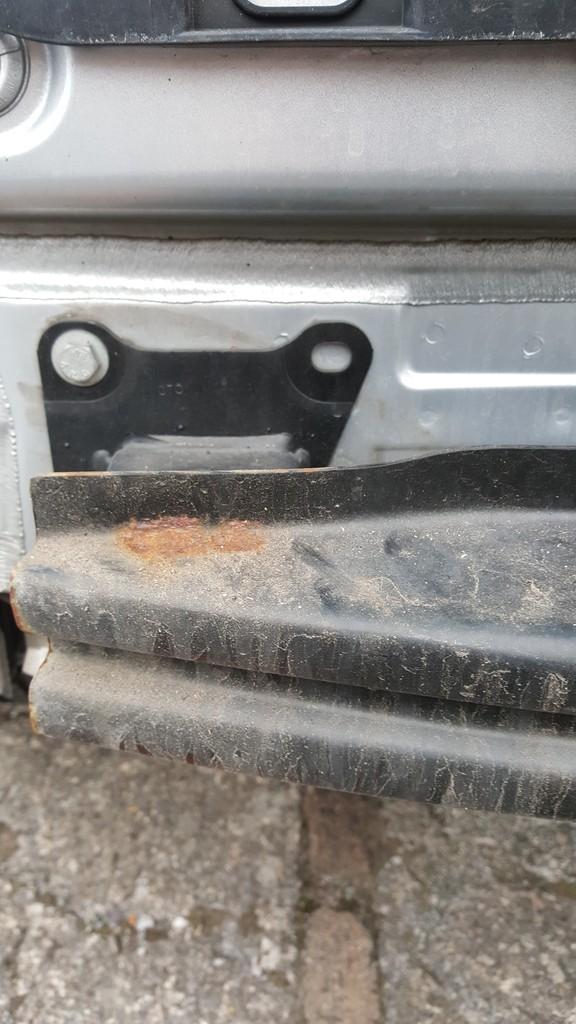

i sourced my hubs off ebay and found a few passat wishbones going cheap pete :happy2:

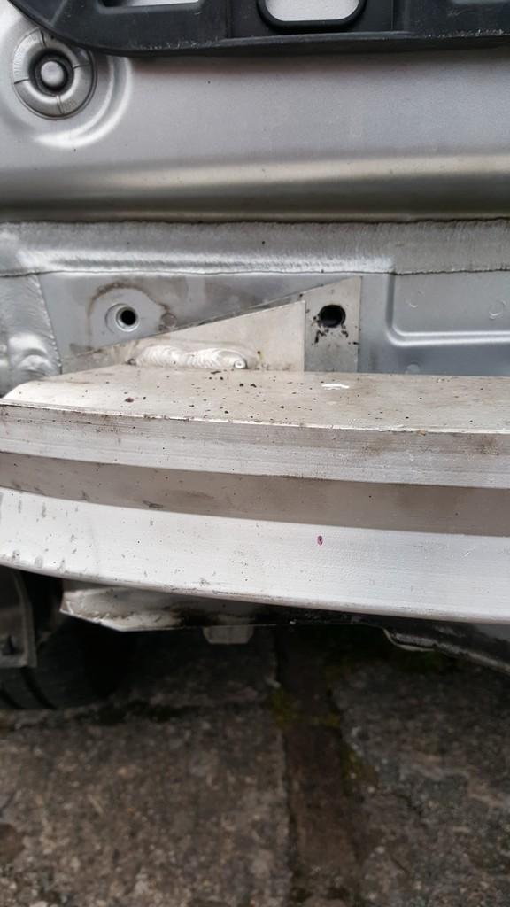

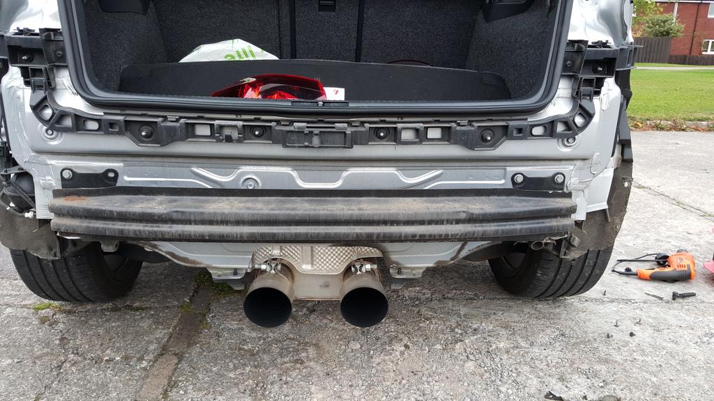

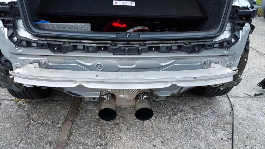

also with help from a fellow member sourced an A3 rear crash bar to exchange mine,£30 posted was worth a try lol

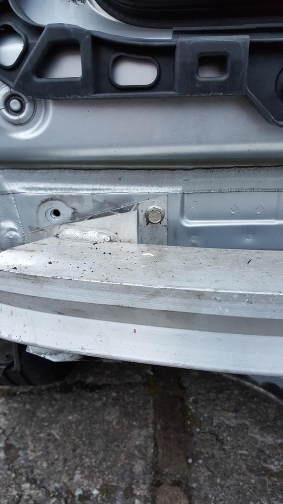

all i had to do was drill this hole on the top right to fit the A3 one
1 M8 bolt and nut job done
total weight saving of 1.1kg's
