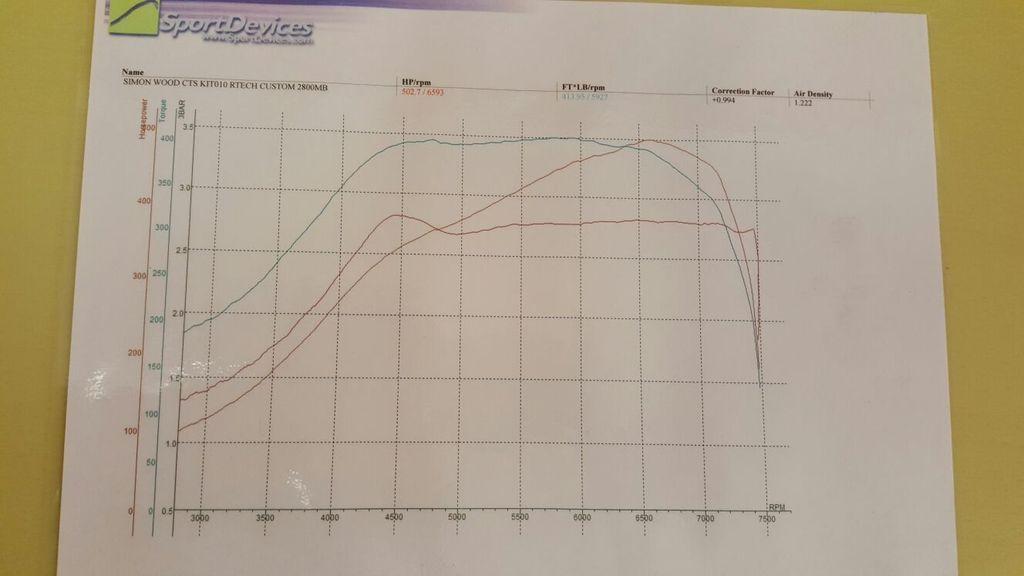

Sorry guys ive not been on,think i need to update my cars spec list now im stage 3 say lol
long story that ill write up 1 day,so here's my new spec list
Engine/performance
CTS GTX3071r turbo
Custom R-Tech map
Tial 39mm external wastegate
RS3 injectors
Loba hpfp
TTRS lpfp
Orc Engineering/RPC intake manifold
Aks Tuning  155 Fpv
Ported turbo hotside
Aks tuning Custom oil and fuel lines
Aks Tuning custom Revo camcoat intake with 80mm maf
Aks Tuning custom inlet pipe
Aks tuning custom High flow turbo pipe
High flow throttle pipe heat taped wrapped
Peron fmic
Nortech Race 3” cat back with custom 3” downpipe and de-cat
Devils Own DVC-30 progressive kit with solenoid,low tank level,filter,4 quart tank  and dual nozzle spraying in Aks tuning methanol plate and Throttle pipe
Rev G dv
NGK BKR7EIX plugs
R8 coilpacks
Carbon stem clean and new injector seals
R-tech full pcv delete
Polar Fis +
R-tech twin plate heatshield
Celtemp hpfp shield
Forge washer cap
Porsche coolant cap
R8 oil cap with filler neck removed
Forge dv pipe
Red coolant pipes
Red conduit
Ecs tuning magnetic sump plug
Black gloss fuse,battery covers and washer fluid neck
Red silicone pipes
Golf R mk6 R-tech tuned GTX3071r

« Reply #229 on: April 03, 2017, 01:03:15 am »
low boost rod happy mapping

Niki was happy to leave it at this power/torque and i was over the moon,stock engine and clutch packs and the car runs like a dream tbh

was off the road for 4 months and had a few niggles to get it where it is now and will need a couple more niggles sorting if i take the tuning any further but overall well happy with it

bit more bhp than my evo had so id say a bit more top end speed where niki has put the power,low down torque capped also
but i still love the sound of the evo lol,its more of a weekend car really,the golf is a better place to be in and does everything youd want out of a car  :happy2:
