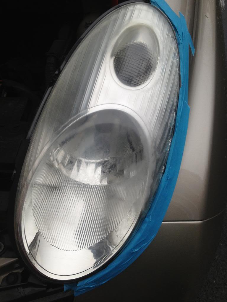

Has anyone restored the lenses on their headlights?
Been looking for how to guides but they only seem to be for lights that have gone dull/cloudy..
I only notice mine are not 100% clear when I have the lights on in the dark.

Yeah done several but never bothered to do a guide sorry!
If really bad, sand back with fine grit then polish out with DA and hard cutting pad, then refine as needed.
Before:
After:
