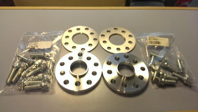

On a better note I've ordered 5mm front spacers and 15mm rear both hubbcentric with longer bolts and lockers, unforeseen but not too bad.

The spacers arrived just after lunch
So chucked the wheels on,
Tbh could of got away with 10 on the front and maybe 20 on the rear lol
They really suit the car,  so happy with them.
