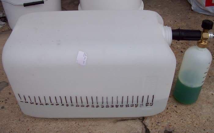

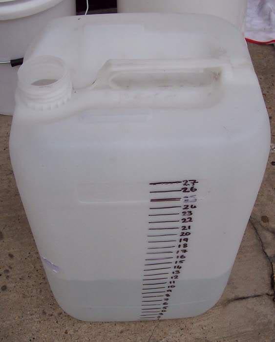

Using the measuring jug, fill the 25 litre container 1 litre at a time, then mark each litre incriment with the perm marker, until you have this
It takes about 10 mins to do.
Once that is done, set up your power washer and fit the HD snow foam lance, fill the lance bottle with 1 litre of water and fire the lance into the container as shown below until the snow foam lance bottle is empty .. DO NOT use snow foam as shown in the picture, i forgot to take this pic and done it AFTER i had worked out my correct percentage
My lance was set to min
I recorded 17 litres in total 1 litre from the lance and 16 from the mains supply through the pressure washer.

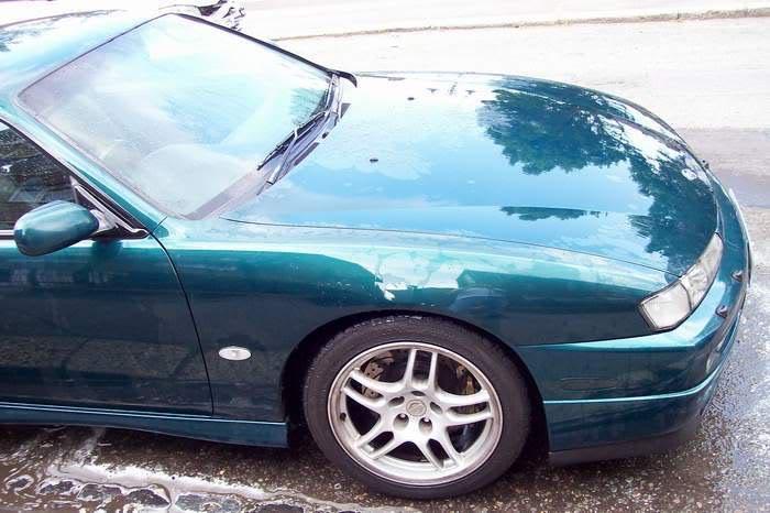

Have fun and if you follow this guide you will end up like i did afterwards.... see below
and to show how well this stuff cleans, even the wheels came up great
