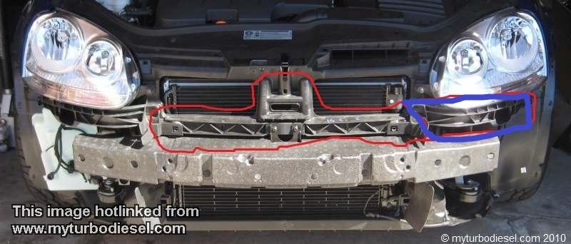

Ok so looking for a part number or link to were to buy it or any info. Had minor bumper broke the headlight clip mount but ive got code for the item in the blue but the item circled red also broke so i need one other wise my headlight isnt secured in

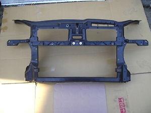

That is the front panel but also known as lock carrier

Sorry to perhaps sounding daft but can that bit circled not be bought separately? If not is that lock carrier all made of plastic ? Thanks

No that it part of front panel,they are made with metal frame with plastic mould covering.
No it can't be bought separate. It's made of plastic the circled part isn't a metal frame with plastic mould but the top part above it is. You can't really plastic weld it as its a thermosetting plastic so it won't melt too well just I case that was what you was thinking lol
