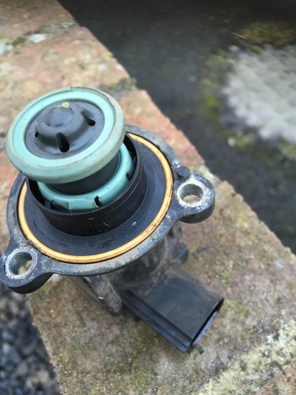

Offline Markmark.123
  • Posts: 48
  • My Ride: 05 gti
Re: Mk5 gti performance
« Reply #12 on: February 15, 2015, 05:07:14 pm »
Well DV done and it's a different car realy fun to drive
No wonder it was slow when ya see the state of this
