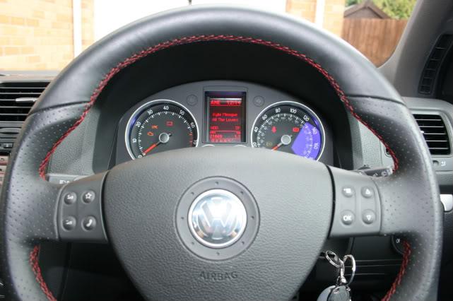

Anyone got a guide to installing these MFSW buttons on to a steering wheel that already has the DSG paddles and controller box/unit?
I want to buy some but unsure how to fit

I've done this, it's just a simple job of removing the air bag, undo wire to flappy paddle, undo torx screw, pull ribbon cable from steering wheel and unplug from controller. Refit in reverse order but with substitute buttons. DISCONNECT battery first. There are several different types of button, at least three that I am aware of. Mine is in for coding tomorrow, but all buttons are working with no problems.

You have PM  :happy2: Mine are the earlier type buttons, I think they are better as no gaps at edge of buttons to get dirt and dust into.  :wink:

These are not the correct buttons for a 2007 car but do fit and work with no problems. As regards price I paid £72.50 including P&P and Pay Pal fees, the buttons were actually £60. Hope this helps.
As regards the control unit, if you have the paddles on the steering wheel they are simple plug and play.
