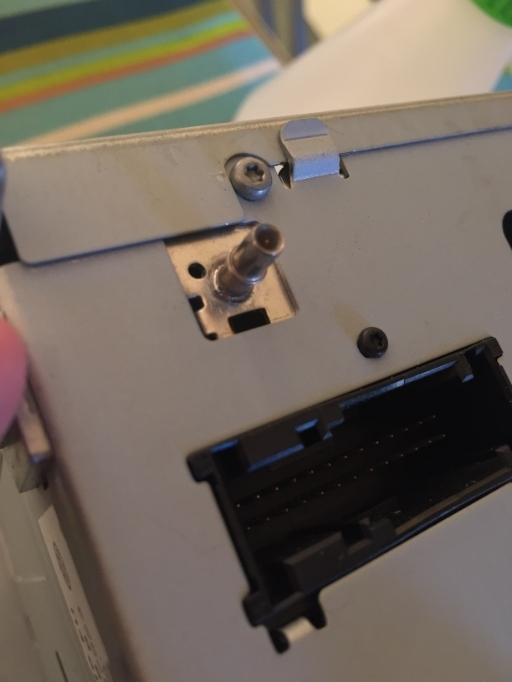

Evening
The DAB aerial connector on the back of my RNS315 has disappeared and i'm having difficulty replacing it. I bought a new connector off eBay (
http://tinyurl.com/lbm4ycf
with the intention of drilling out the connector and using the outer part but it didn't work. Basically i trashed three of them!
Where can i buy just the plastic part as i can't find one anywhere!

www.co-star.co.uk
http://www.co-star.co.uk/prod/3612/fakra-female-black-code-a-rg58.html
The RG58 is the one I ordered to replace my normal FM radio connector but I'm not sure if the DAB ones are the same though.

p.s. I you just type Fakra in their search box top right of the website it comes up with all sorts of alternates

Sorted
Bought a Fakra Universal Male RG58 Code Z Connector connector and pulled it apart. I only need the blue and white parts.
Photo has been resized, Photobucket is being an arse. Again!
