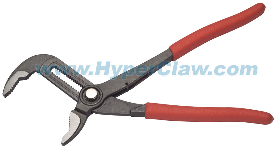

Its bonded on, compress the bottom with a g-clamp, work your way round. It helps weaken the bonding and then a big pair of gland pliers/water pump pliers/5 holes (whatever you like to call them) and it twists off eventually. Takes some doing though.
Once it's off you'll see the top has the cutouts for the oil filler cap.

Stillsons won't bite onto the plastic (ask me how I know! )
These are what you need, biggest set you can get your hands on
