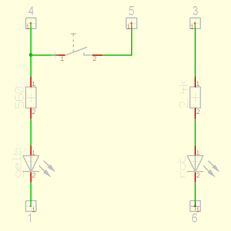

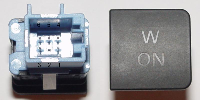

I have found this on the web, can anyone explain to me what wires need to be connected to illuminate and use as a on/off switch:
I'm thinking W for Woofer!
Subject to how your equipment needs to be wired this set up will work for most typical situations as long it's its a low amp circuit or a relay will be required as there's no swich rating details provided!
Pin 6 earth for illumination off dash lights on - (brown wire)
Pin 3 feed from lighting circuit for dash lighting illumination - (grey)
Pin 5 fused feed for the circuit to be controlled
Pin 4 switched side of circuit to activate item to be turned on upon button activation.
Pin 1 earth for the light illumination for the switch side of the circuit - the button will illuminate when the item controlled by the push button is in the on position.
Note pin 6 and 1 can be joined together.

@doylebros thats is excellent thank you. Its just for a amp remote wire so the switch should be more than capable.
Can I ask, did you get that info from the pic above or a vw wiring diagram?

Off your drawing

Just to add a bit to this,  all vw switches are not on-off,  there like a door bell just push on,  so you will need to add a latching relay so with each press of the switch will turn relay on,  then next press will turn off,  plus regardless of power to the relay as it has a magnet in it hence latching it remembers it's last told command
All as stated above is correct!
However,your drawing for the switch offered is not a momentary switch so if your buying as per the drawing all will be good to go.
If you're going to use a VW switch you'll have to fit the latching relay or your amp will only work when you've got the button pressed.

Aah ok that makes sense. The wiring diagram is supposedly for the vw switch. So this latching relay, I've had a quick look on eBay and seen for about £20ish, is that how much they are?
