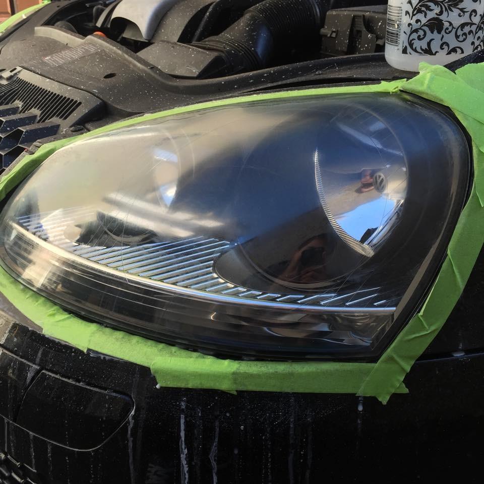

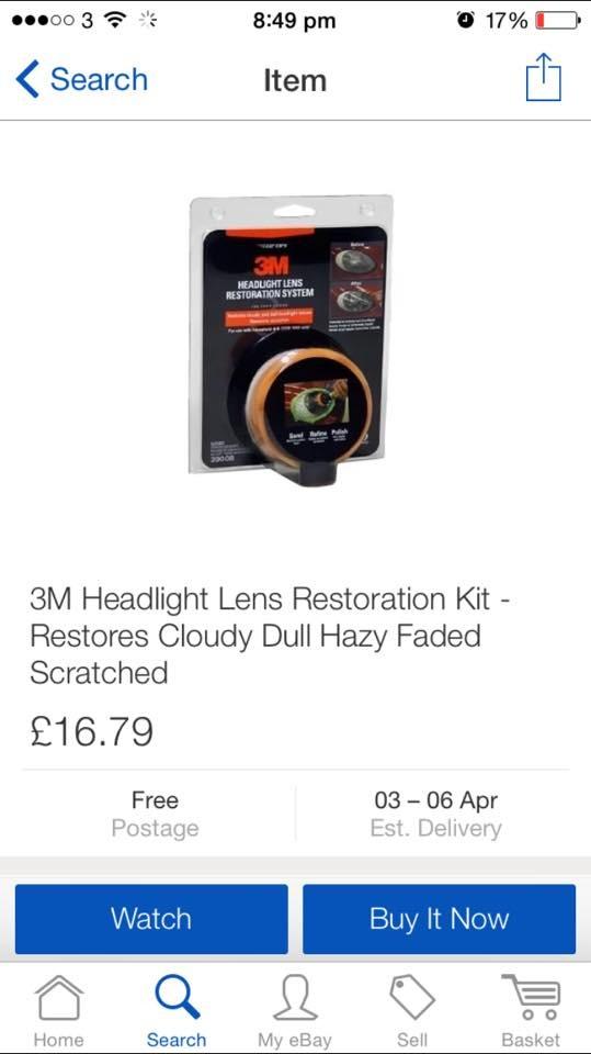

Yesterday I used the 3M headlight restore kit I bought from eBay for £16 odd and what a result I got.
People say that it takes about 2 hours to do but because I started on the finest pads it took me about an hour to do.
Very easy to use and was a lot quicker then I expected.
This is the kit i bought and it comes with 3-4 different grades of sandpaper pads but i just went straight the finest one and started.

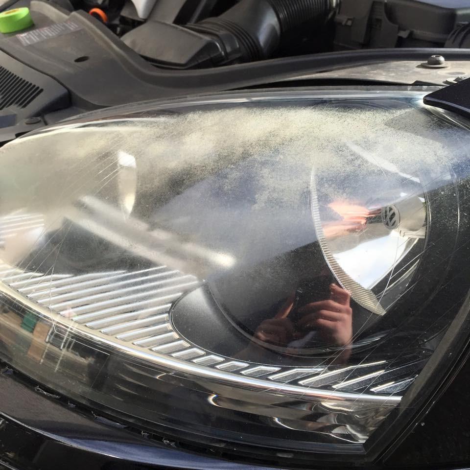

You get 2 pads per headlight so after the 2 pads where used you move onto the rubbing paste and the buffing pad you get with the kit, after a while your headlight will look like this.

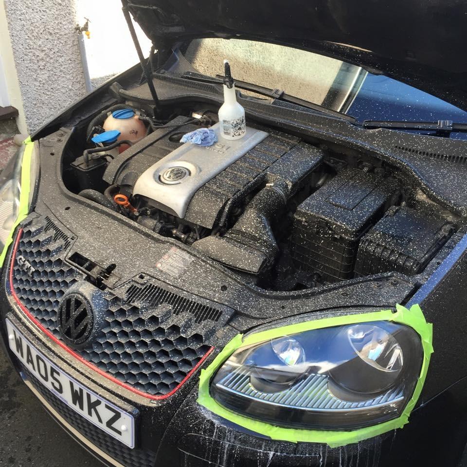

I would recommend to do it with your bonnet shut or to remove your headlights and also don't ware good jeans! haha

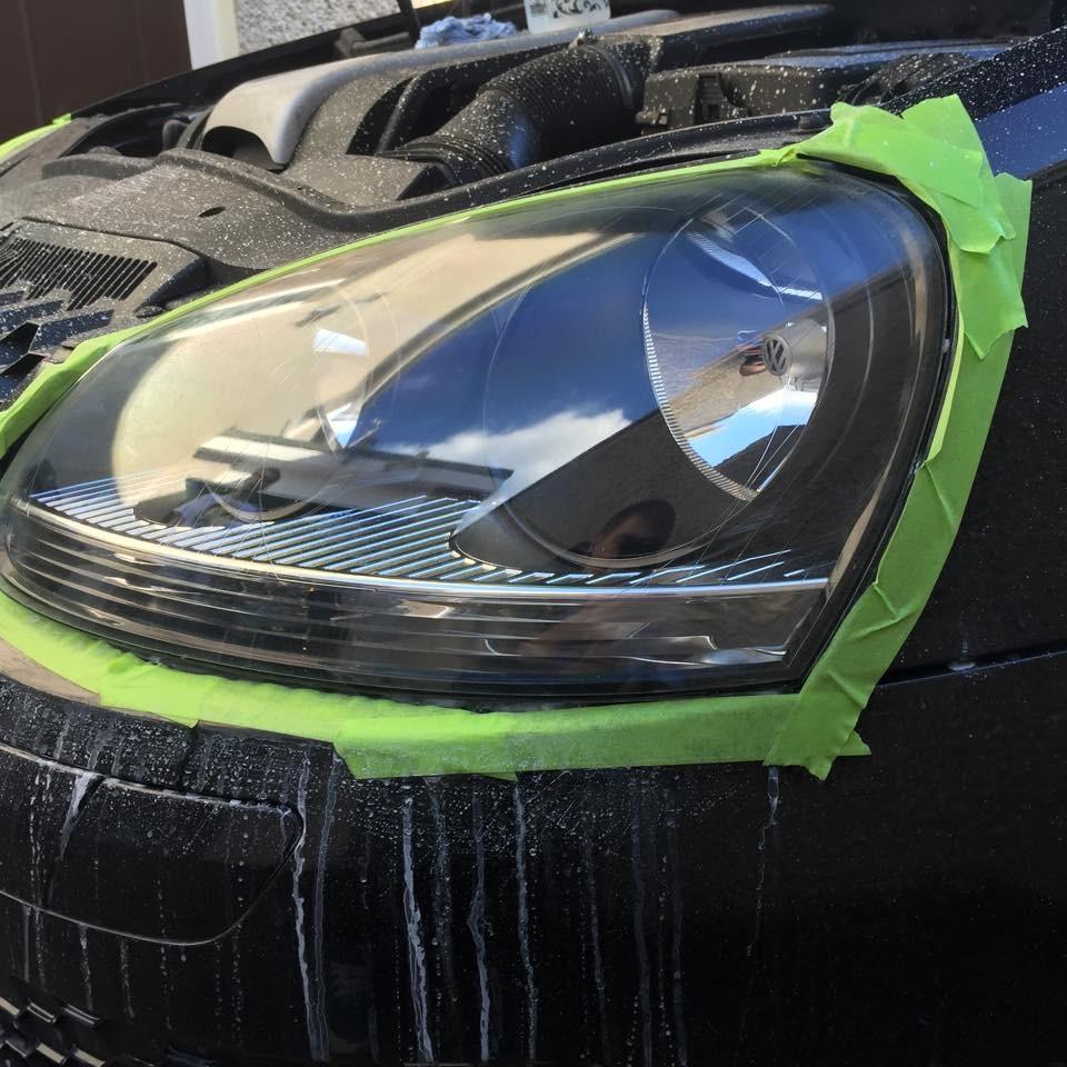

But when you are happy with it I went over it one last time with some Autoglym polish just got the final finish and it turned out great!
I would highly recomend this kit and all you need is a drill and something to spray water on the headlights as you go and you should be sorted!  :happy2:

Lol, um wow.
Nice transformation but what a mess you've made! We do quite a few headlights, especially on Mk5's - we do them with the bonnet up as it's just another edge you're not going to accidentally damage - and never make that amount of mess, haha!
Hope you have put some decent wax on the headlights as well - they will soon return to being yellowed and faded if not, as you've removed the remaining protective UV layer by sanding/polishing!

Yeah I went a bit canny with the paste haha but was a good excuse to give the engine bay a clean up lol
Yeah I used some expensive Autoglym wax but will was planning on giving them a going over whenever wax the car just to give it that nice finish.
