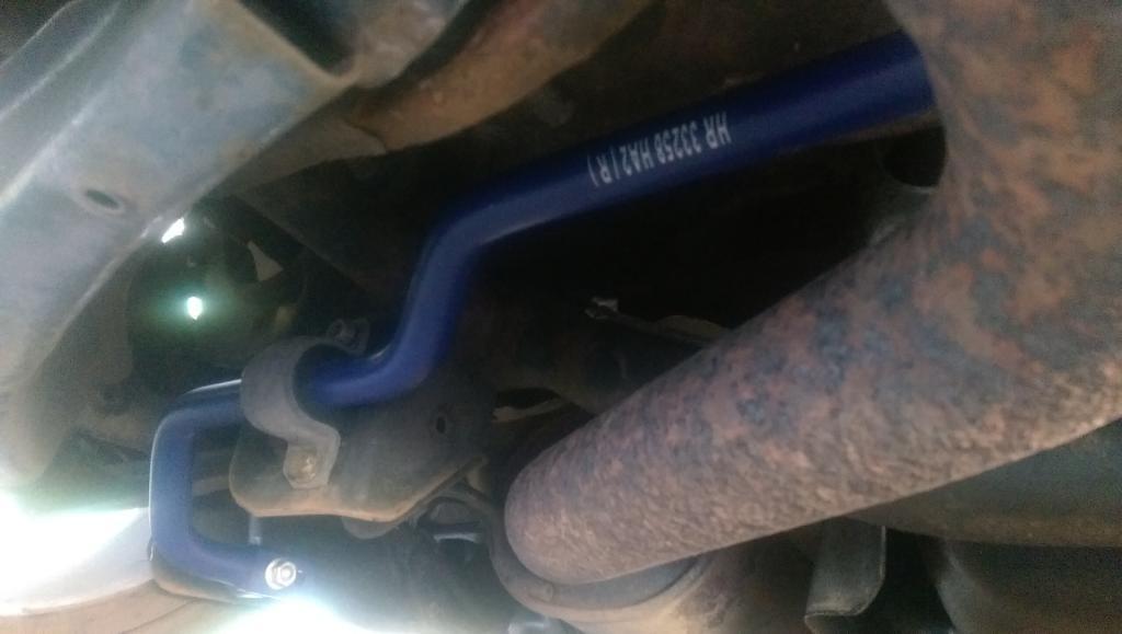

Rear anti-roll bar fitted yesterday, 24mm H&R set to hard and will fit the front over the next couple of weeks on soft :)
