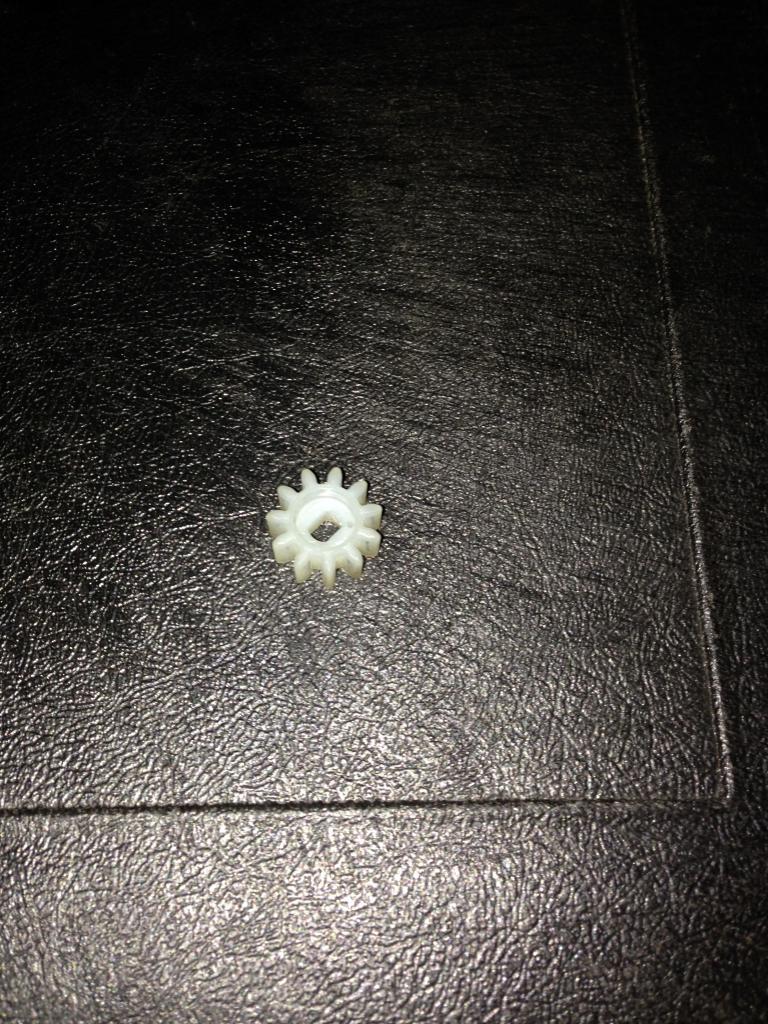

It's the little motors that control various different flaps. I had one that would click very loudly which I ended up replacing. When I took it apart some of the teeth were missing on the cog so the loud clicking I was getting was it trying to turn on the missing teeth.
