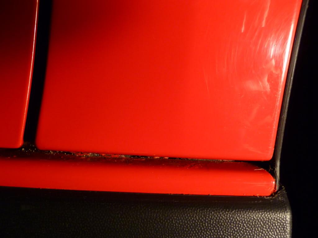

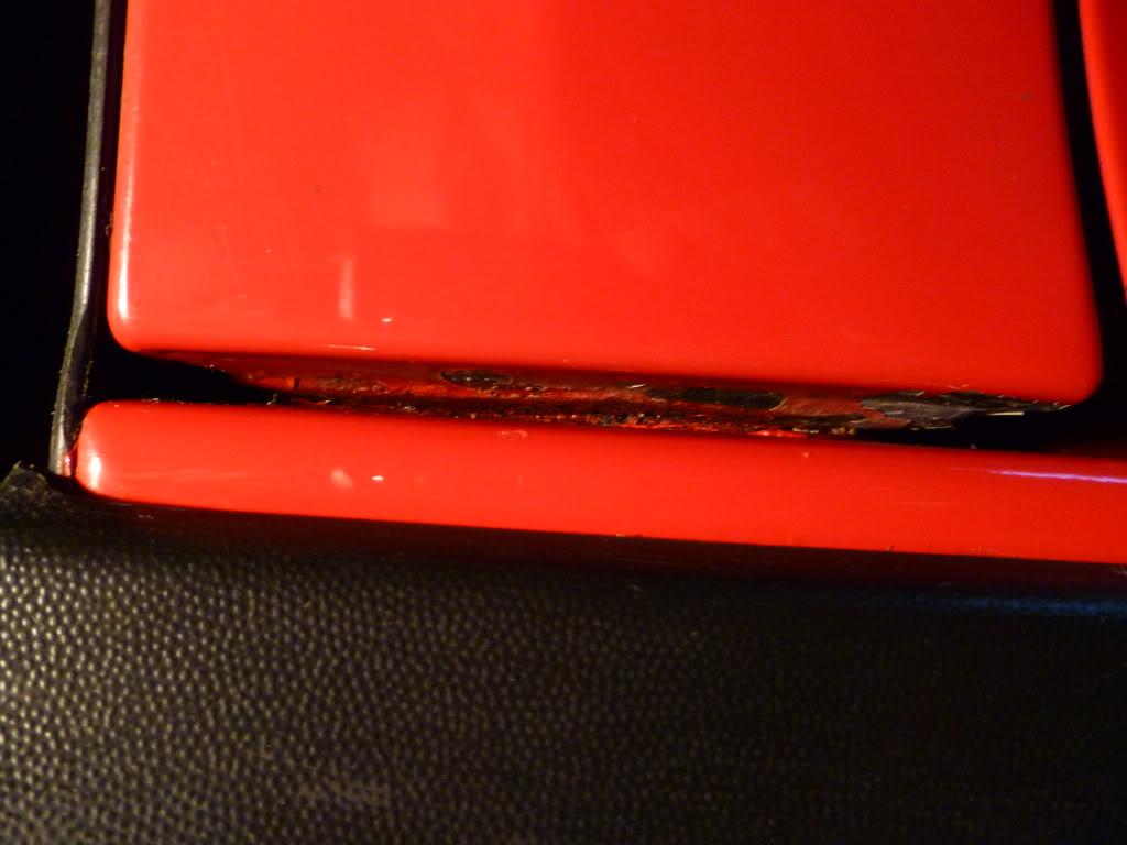

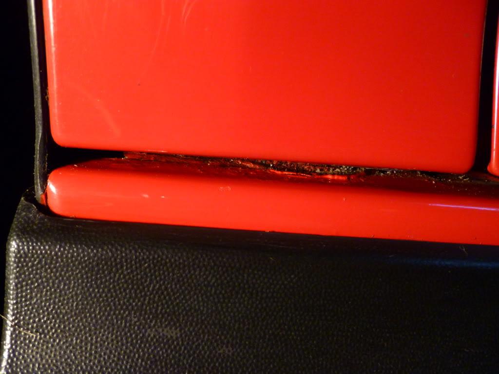

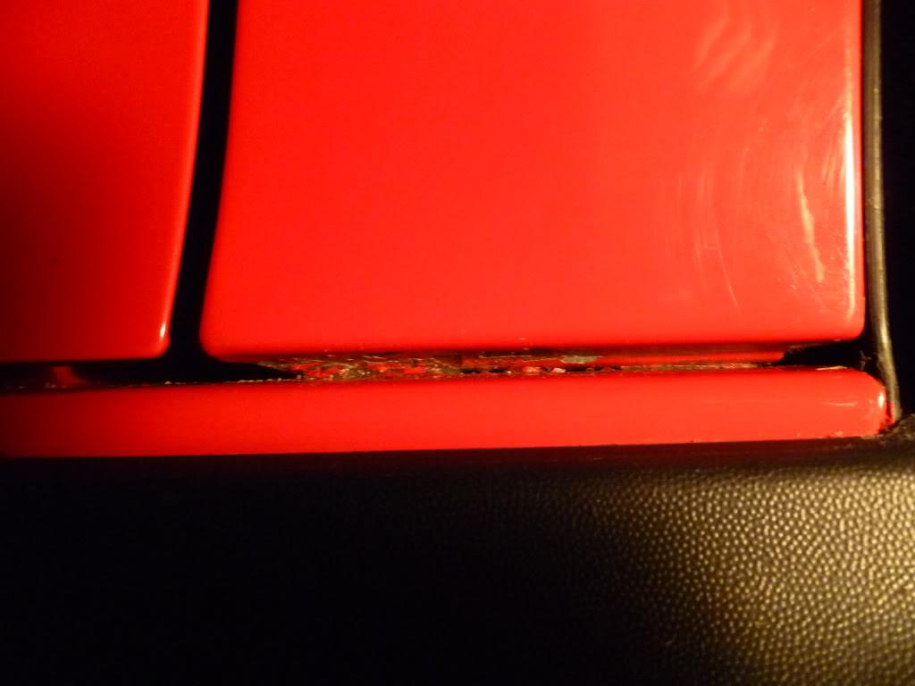

I got my car back from Smith Knight Fay bodyshop on Tuesday after it was in a week for the warranty repair to the rusting door sills. All looked OK from an initial glance when they handed back the keys but I've had a proper look today using an inspection lamp and this is what I find:
It looks like they've spent 5 minutes painting the sill (only) with a touchup brush. And they've managed to file off paint from the wing (right hand side of last picture) :mad:
No prizes for guessing who I'll be ringing first thing in the morning!

God mate thats look terrible, just cant seem to trust anyone nowadays, to do it right they need to take the wings off.
Hope you get it sorted  :happy2:

Sent my pictures of the bodyshop's "repair" to the VW dealer who arranged the warranty repair yesterday and the bodyshop were on the phone to me within 30 minutes. The bodyshop manager said that the work they were requested to do and the work that was done "don't appear to match" and he does know why the wing wasn't repaired. It's booked back in for another repair in 2 weeks time. Lets hope they do a proper job this time.
I told them to collect the car from me (35 miles away) and drop off a courtesy car. I also asked to see photos of the repair work before they return the car to me. He agreed to all this, which makes me think they know they've screwed up and need to keep me quiet!!
2012 Mk6 GTD. Tornado Red. TPMS, RNS510 and reverse camera retrofit.

Finally got my car back on Monday following it's second 1 week stay at Smith Knight Fay's bodyshop in Manchester. Thankfully they've done the warranty repair properly this time and it looks like new again - none of the surface irregularities, etc. that were left last time. They had to take the front doors and wings off to do the repair properly so it took longer than their estimated 2 to 3 days!
They showed me pictures of the repainted sections before they had reassembled the car to prove everything had been repaired properly but refused to let me have a copy for "data protection reasons". Somehow I don't think this is quite right, more like protecting themselves and stopping me posting them all over the internet.
