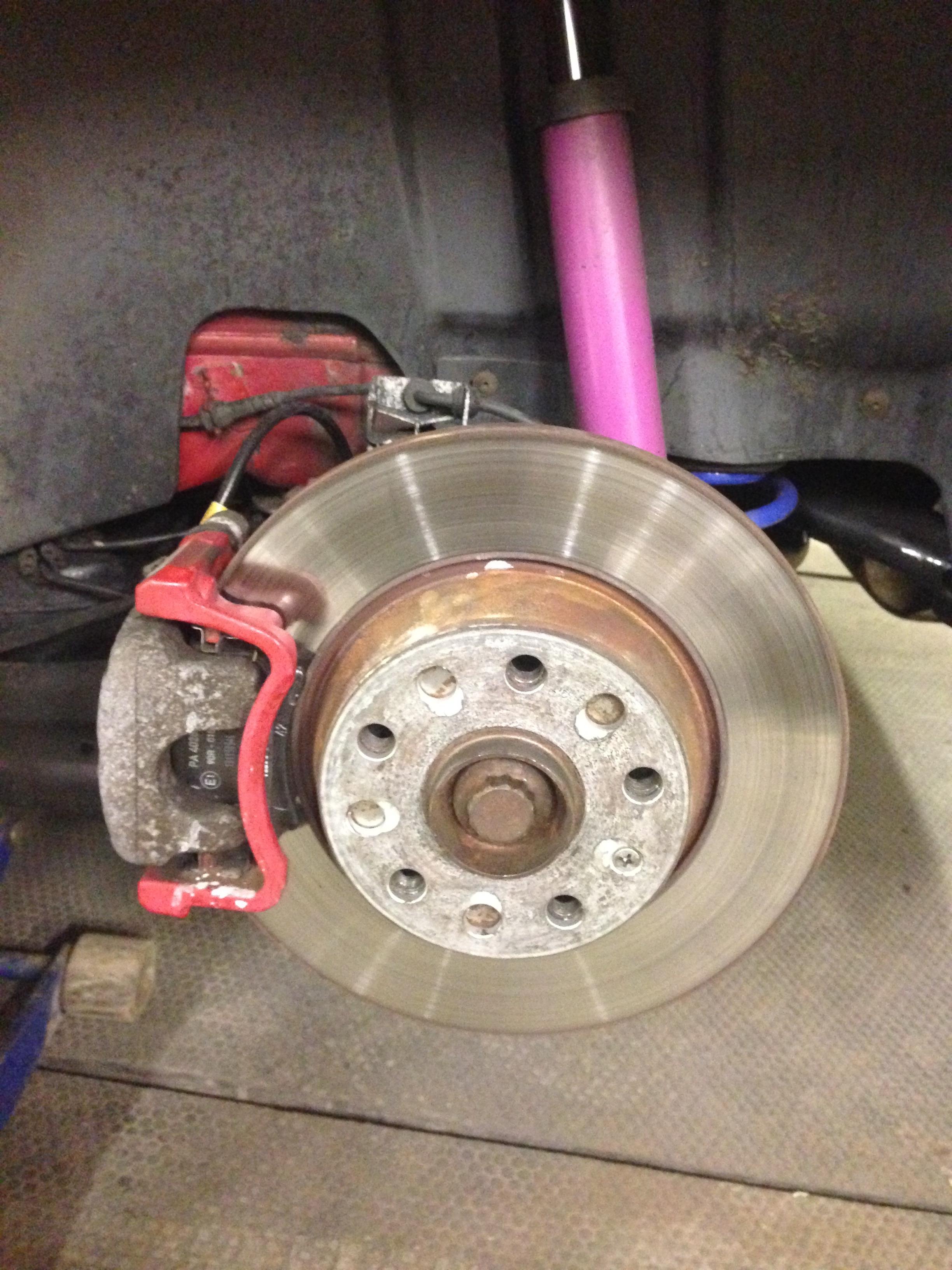

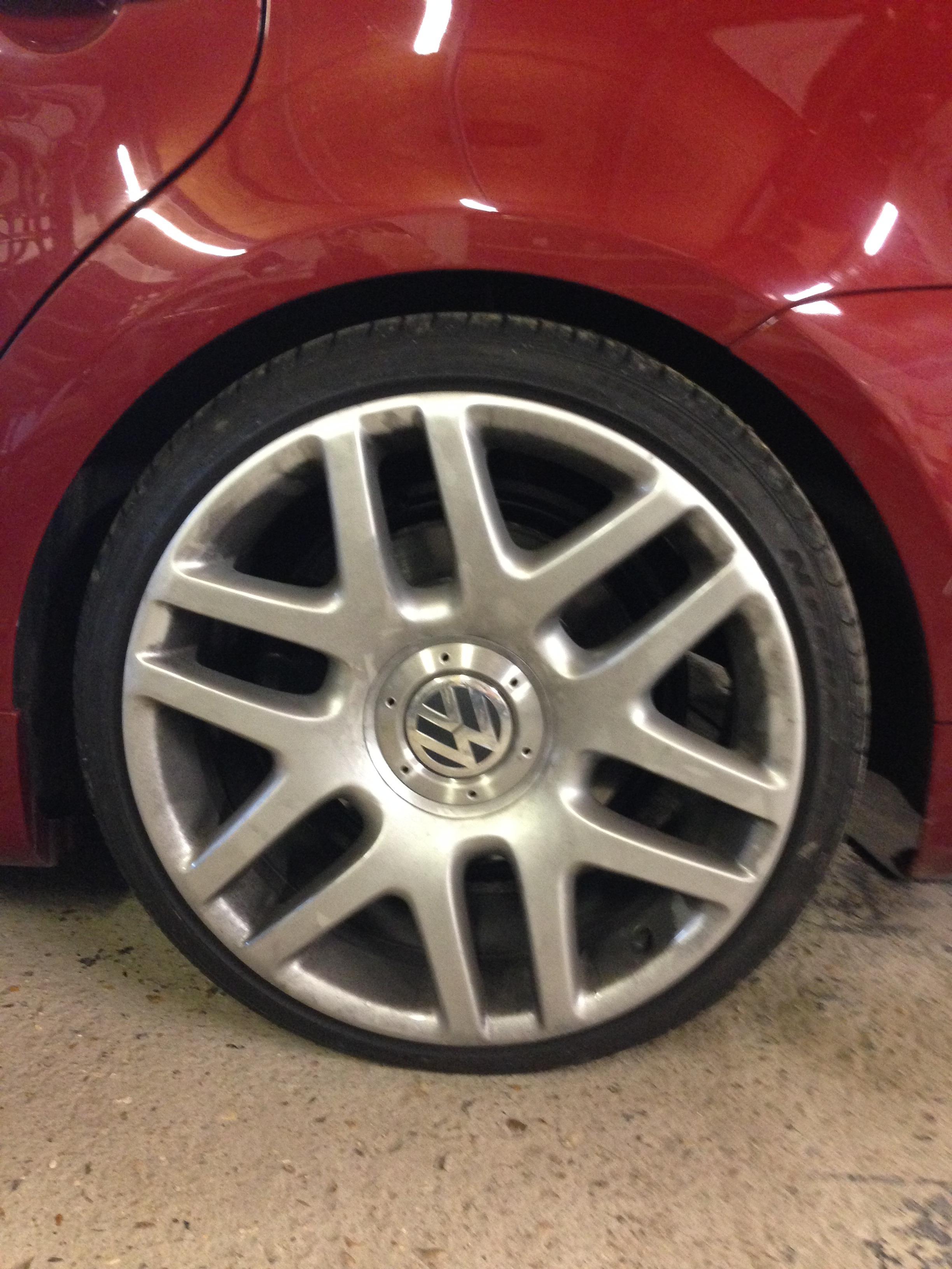

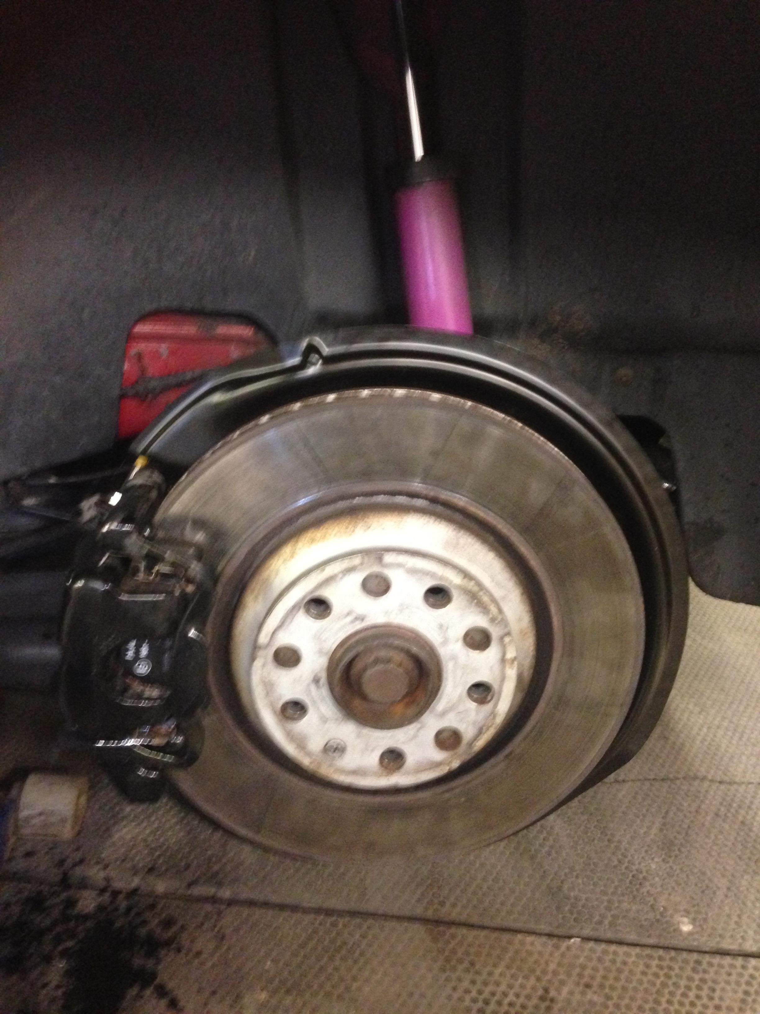

Managed to pick up a full set of s3 / r32 etc brakes (only needed rear so will sell fronts on)
Ever since i went for the 370mm ttrs fronts the rears were dwarfed and under very heavy braking the tail got a bit loose, so been looking for the 310mm vented set up for a while, after a few UPS dramas (losing 2 discs) it all arived (in installments) i'd already bought shields and pads
So off with the old 286mm gti set up
And on with the 310mm luckily came in black to match ttrs fronts
Look bit more purposeful behind the helious :)

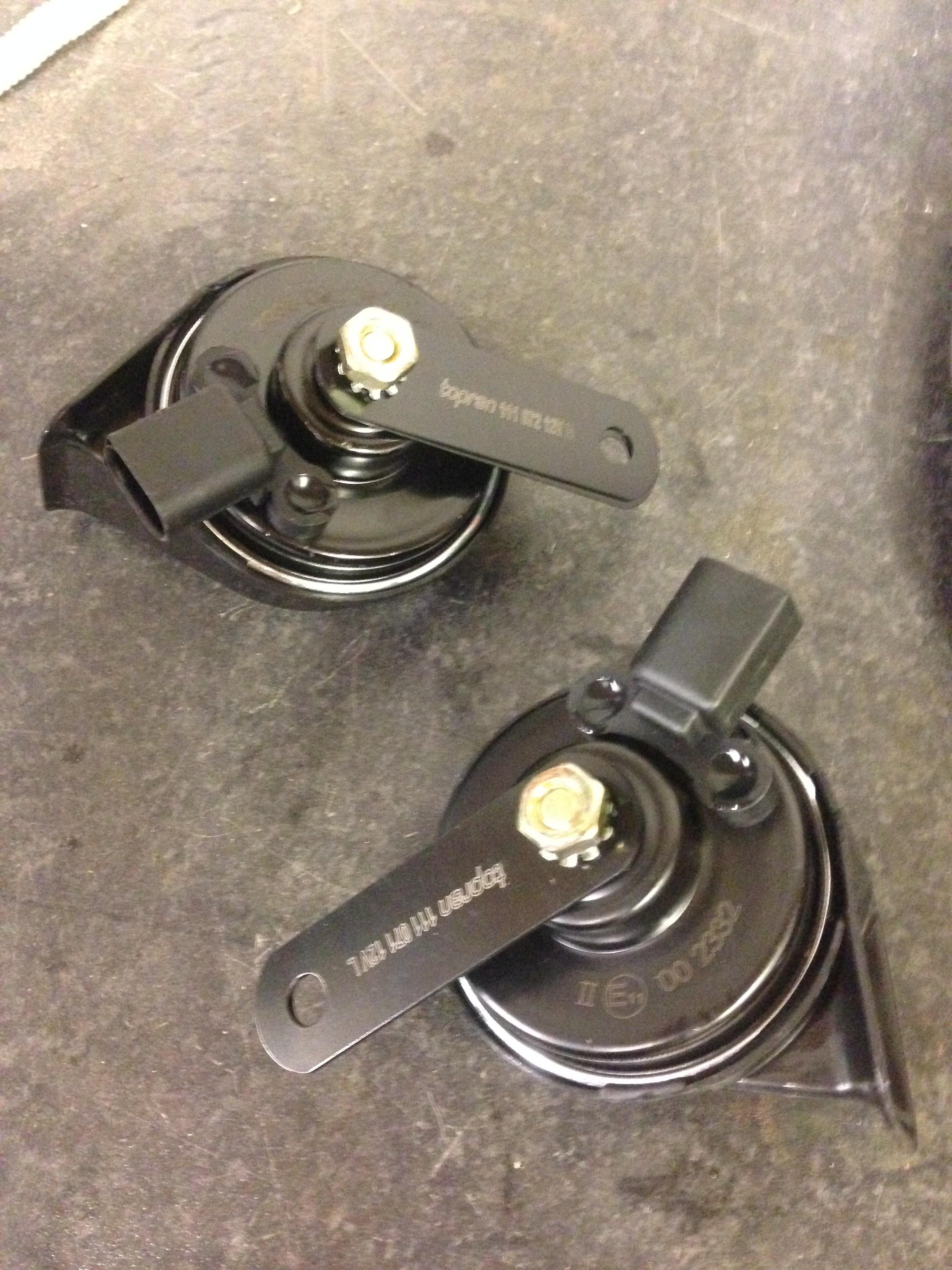

Also gotsome topran horns, somehow during the swap 2 same tone horns were fitted and sounds terrible so rather than mess about working out what tone is what i bought new hi and low pair

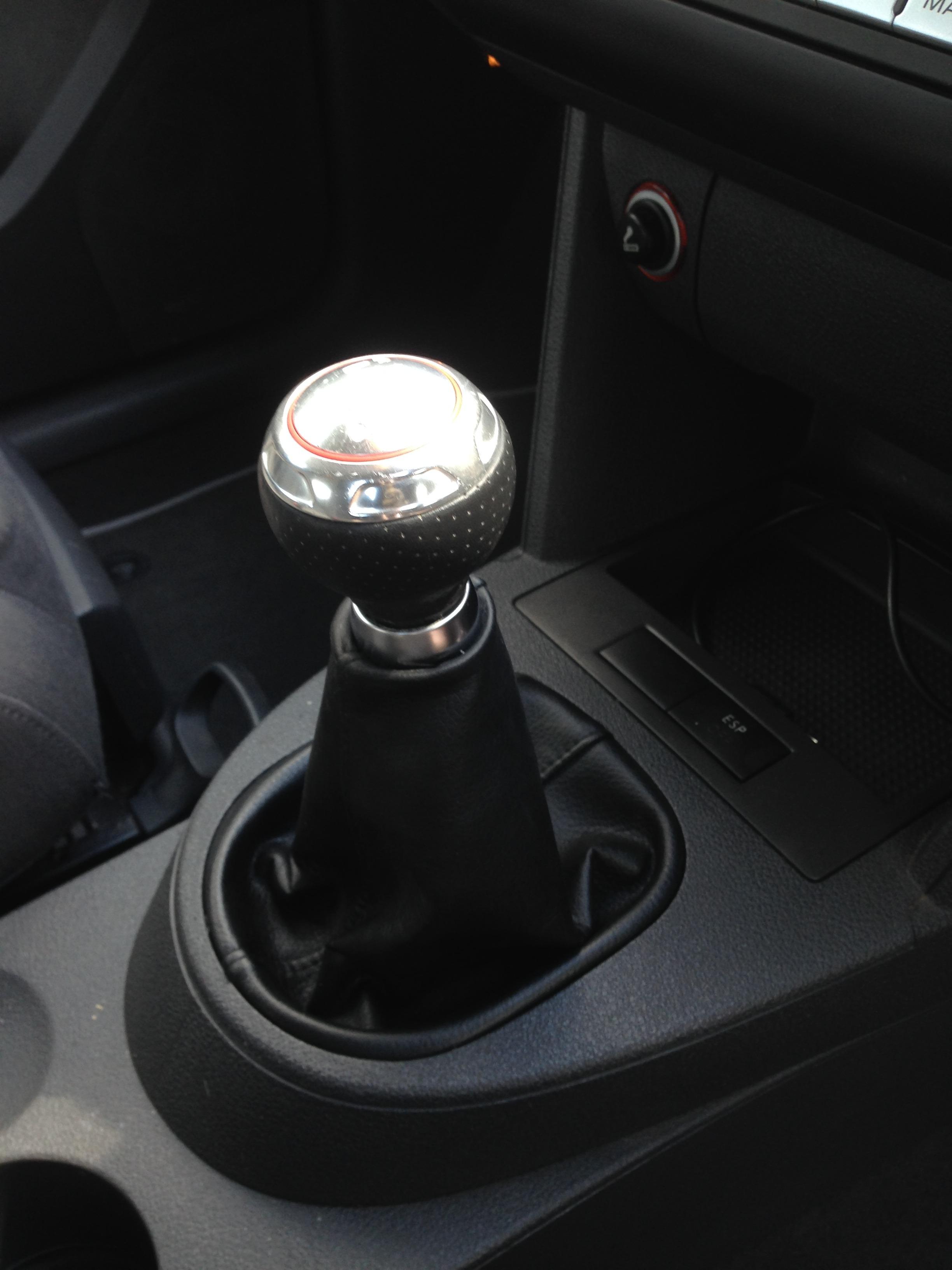

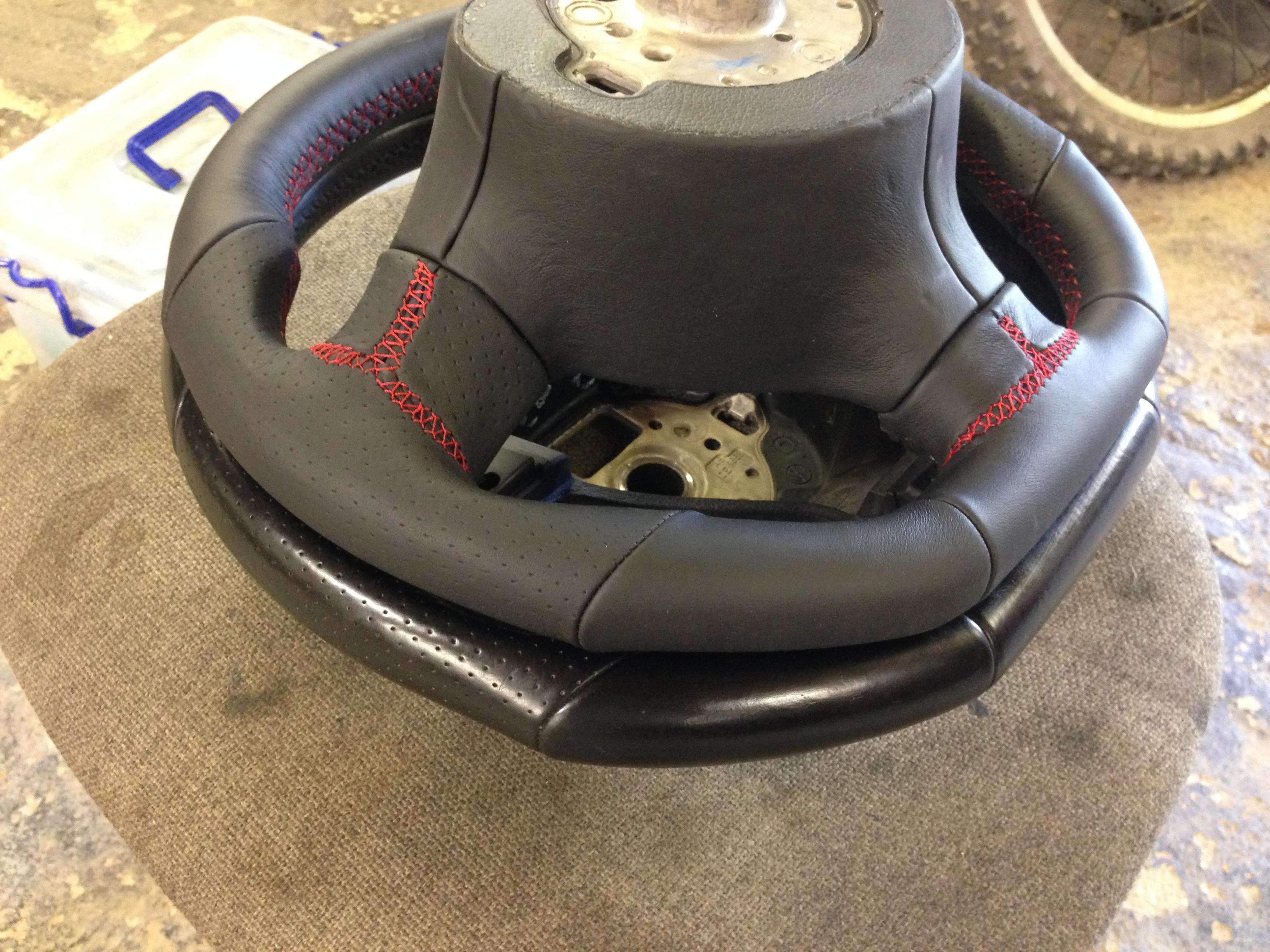

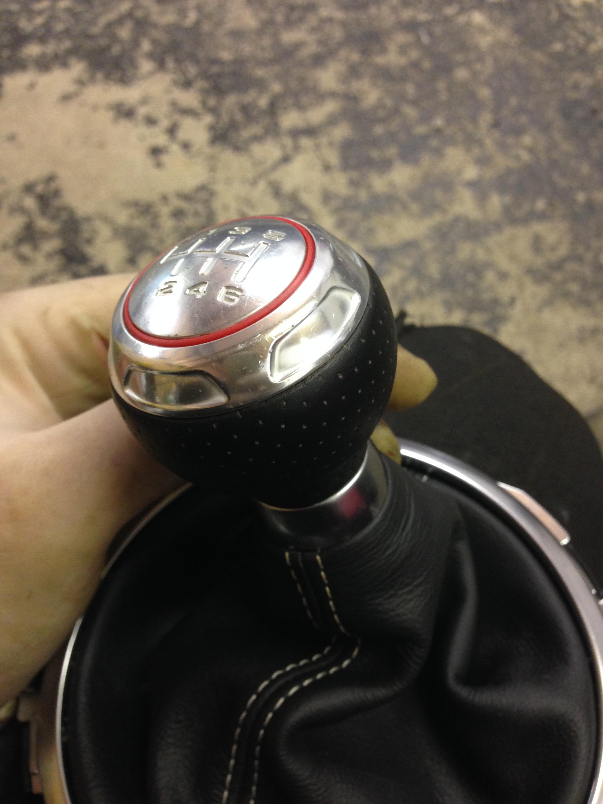

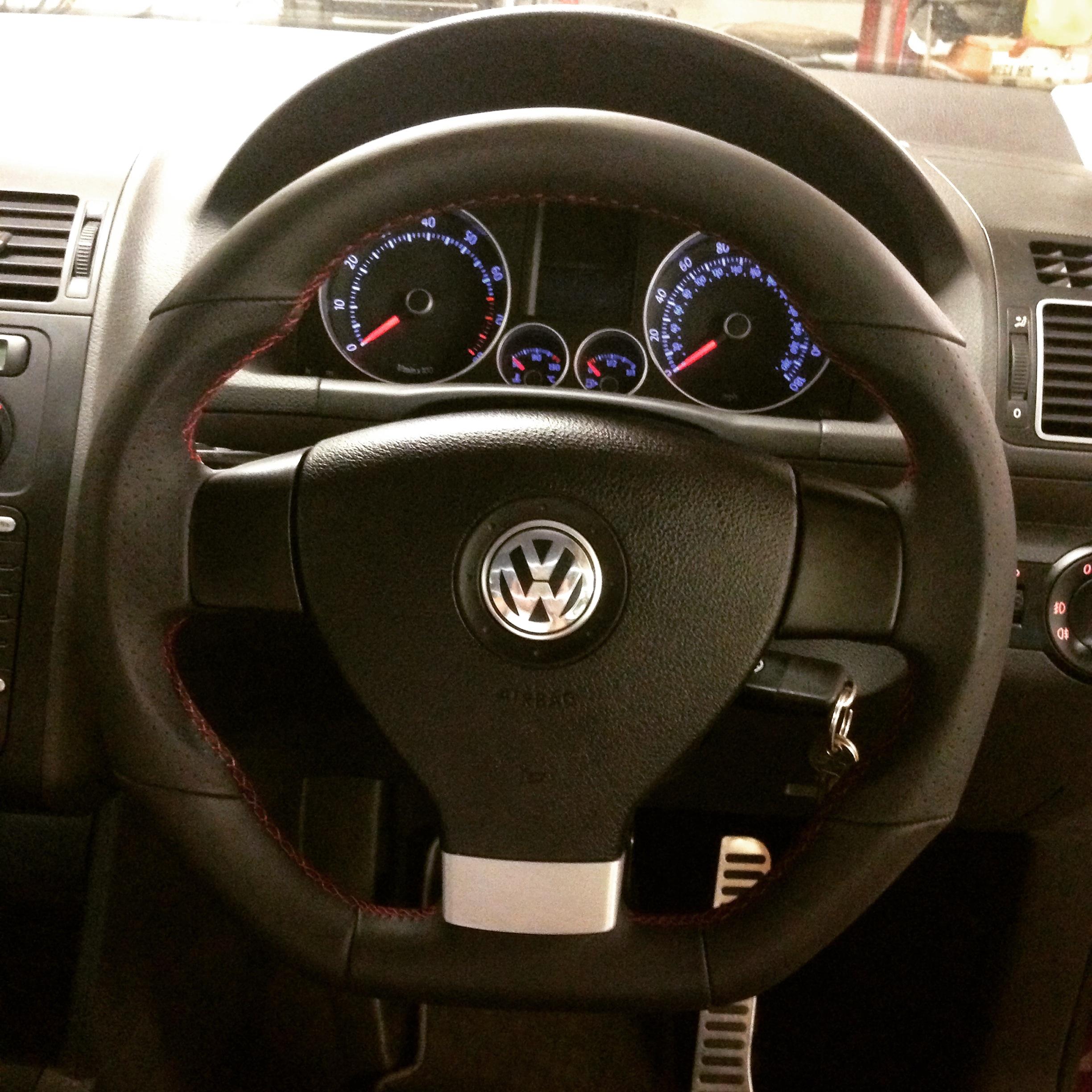

My steering wheel turned up yesterday and my gearknob arrived this morning
Steering wheel is retrimmed gti style that is 20mm smaller with red stitching
And ttrs gearknob

Very nice mate, who did the steering wheel? I'd like a slightly smaller one.. Do they modify your existing one? As I have the Mk6 style in my Scirocco..
Re: TFSI BUS
« Reply #217 on: August 10, 2015, 01:32:20 pm »
I had mine rebuilt as flat bottom and 3 & 9 oclock retrimmed in suede with red stitching.  I forget the name of the company, sent my wheel to Germany to have it done.  Will try and dig out the info

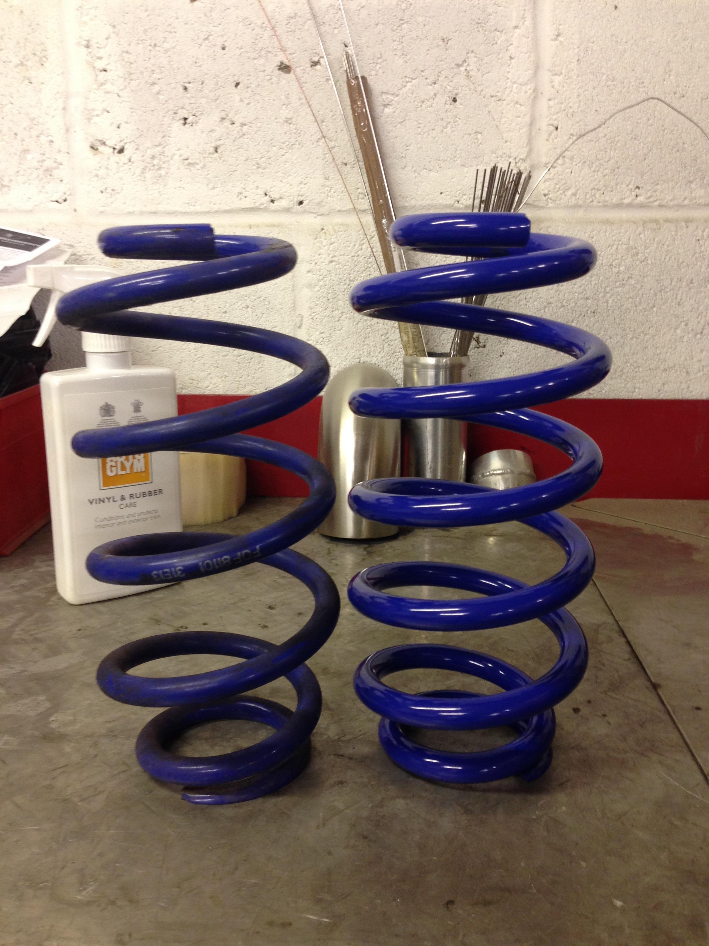

Not a lot been happening lately, bought some passat r36 rear ap coilover springs to try and stem the squat as they have the higest axle load on the platform
Touran rear vs passat
Unfortunately even with adjusters etc out it sat way to high, so refitted touran items while i consider what to do next

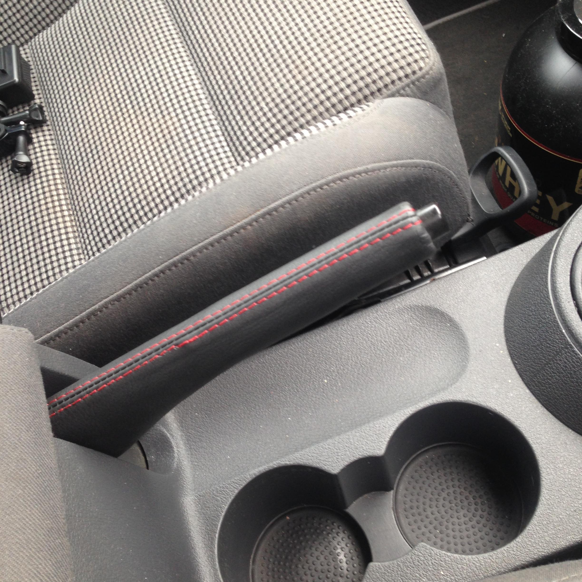

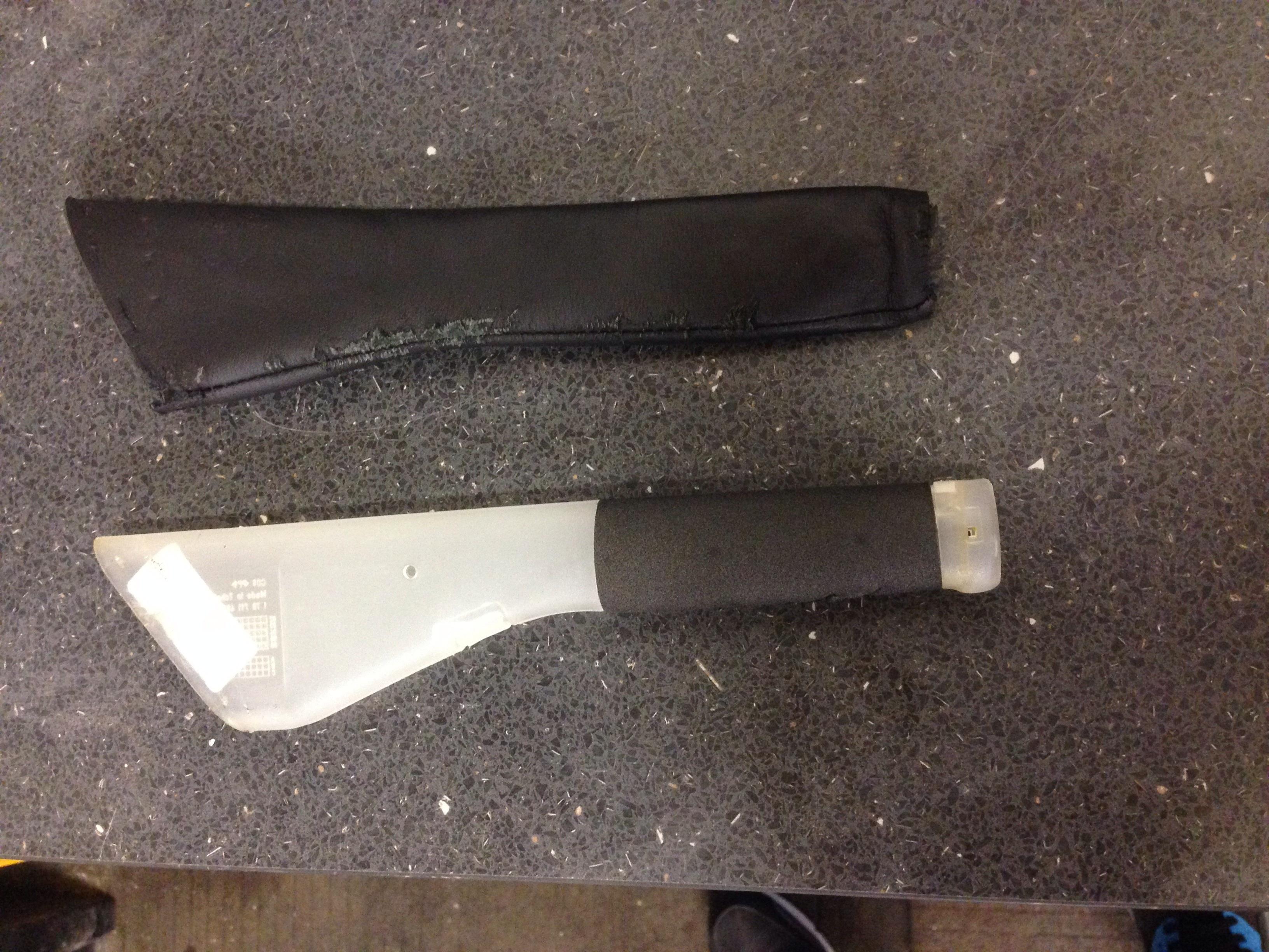

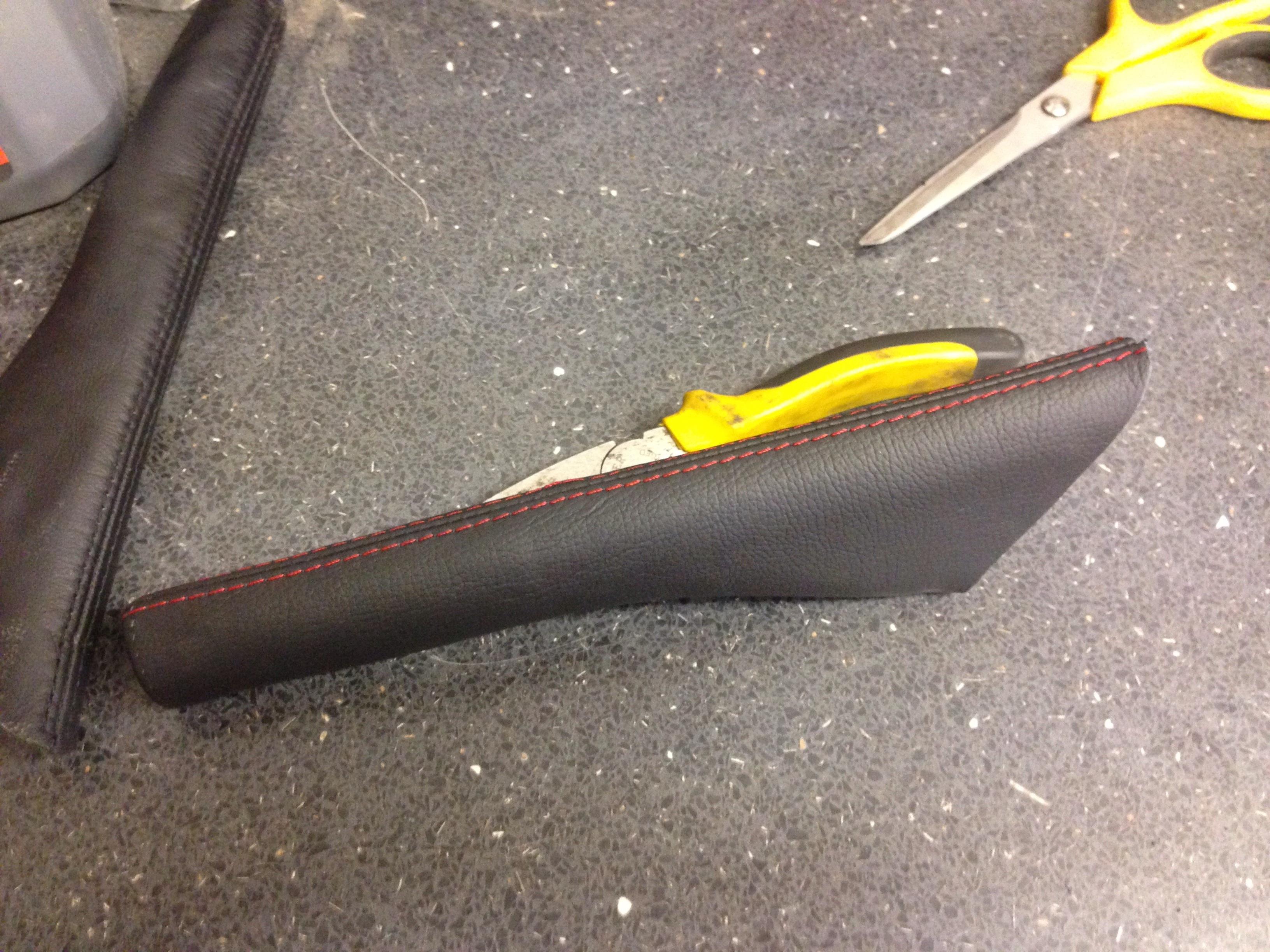

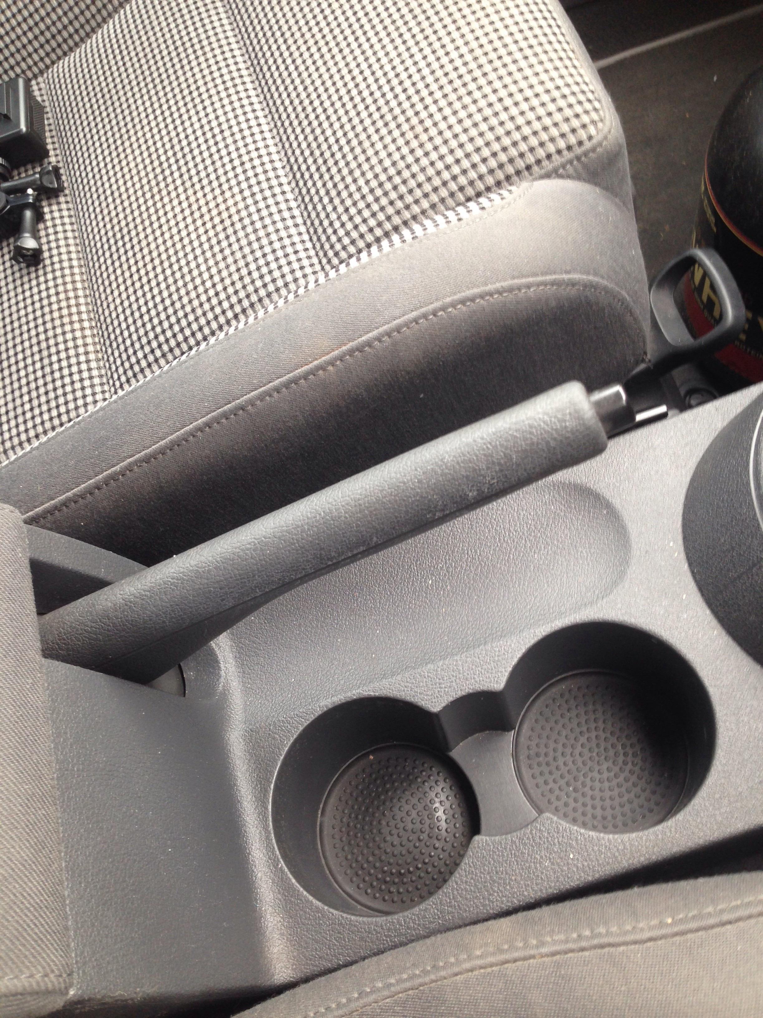

Also decided to tend to my handbrake
Bought a leather handbrake off ebay but wasn't the cleanest so removed the trim and leather cover
And fitted an ebay cover in place of the leather
Fitted
Touran TFSI Quattro | stage 2+ BHZ | UK's first

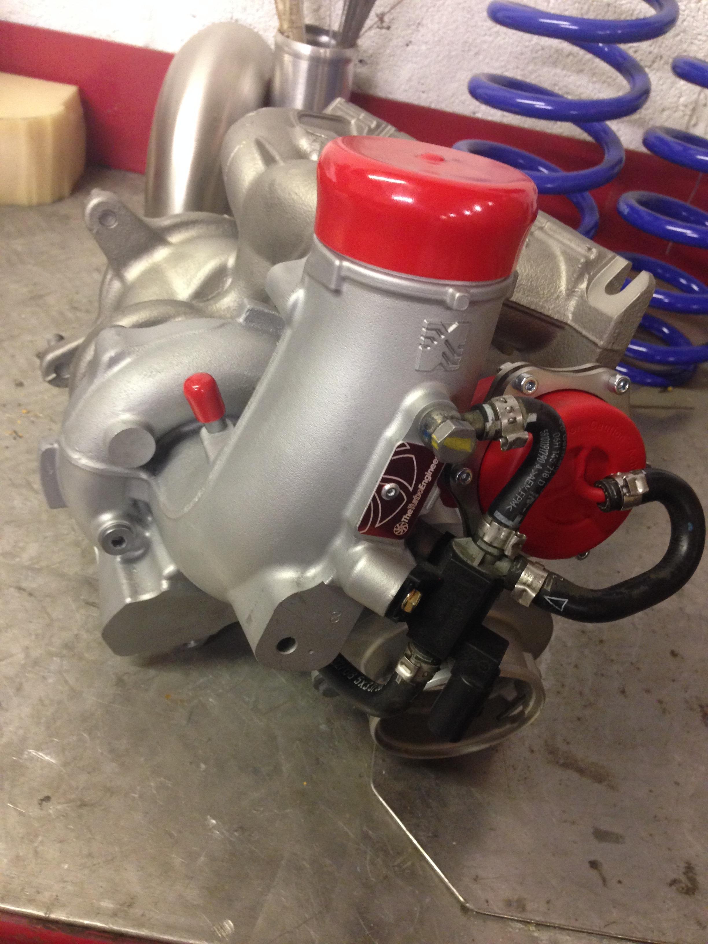

Oh this arrived yesterday too

Congrats and oh my that Turbo looks stunning  :happy2:
Offline Paradox1
  • -Given: 41
  • Posts: 1038
Re: TFSI BUS TTE420 arrived
« Reply #224 on: August 21, 2015, 03:42:44 pm »
Do you know if you could send off a k03 turbo to be made into a TTE420?
I thought the k03/k04 units were the same, just different internals?
