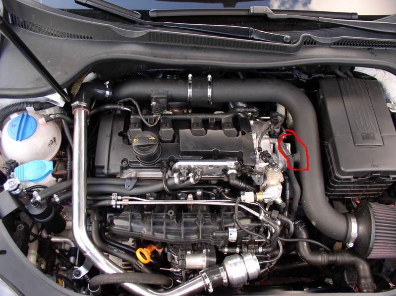

These are the part numbers associated with the US noise pipe:
noise pipe 1K0 145 945 A
throttle body pipe with bung 1K0 145 770 P
pressure hose 1K0 145 856
sealing washer 3C0 145 117 B
retaining clip 1K0 145 769 A
I am not sure you'll need them all but folk in the US have changed the oem noise pipe to the Eurojet version when using the BSH intake with DV kit.  http://www.20squared.com/product_p/5.1.023.htm
The eurojet version looks like this when installed
