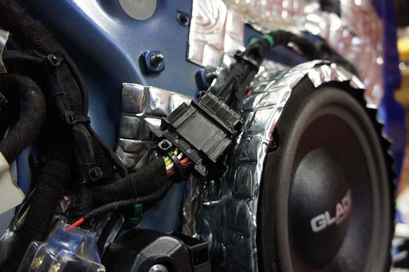

I have the Herz HSK 163's running from an RNS510.
A lot of pics of the install in my build thread.
http://www.mk5golfgti.co.uk/forum/index.php/topic,90967.120.html

You can mount the crossovers in the doors. Then you run one wire to each. Running the wires is easy i spent the most time deadening the doors.
This may help http://www.mk5golfgti.co.uk/forum/index.php/topic,93154.msg934040.html
You can get a 2 channel amp or a 4 channel and use the other 2 channels for a sub.
