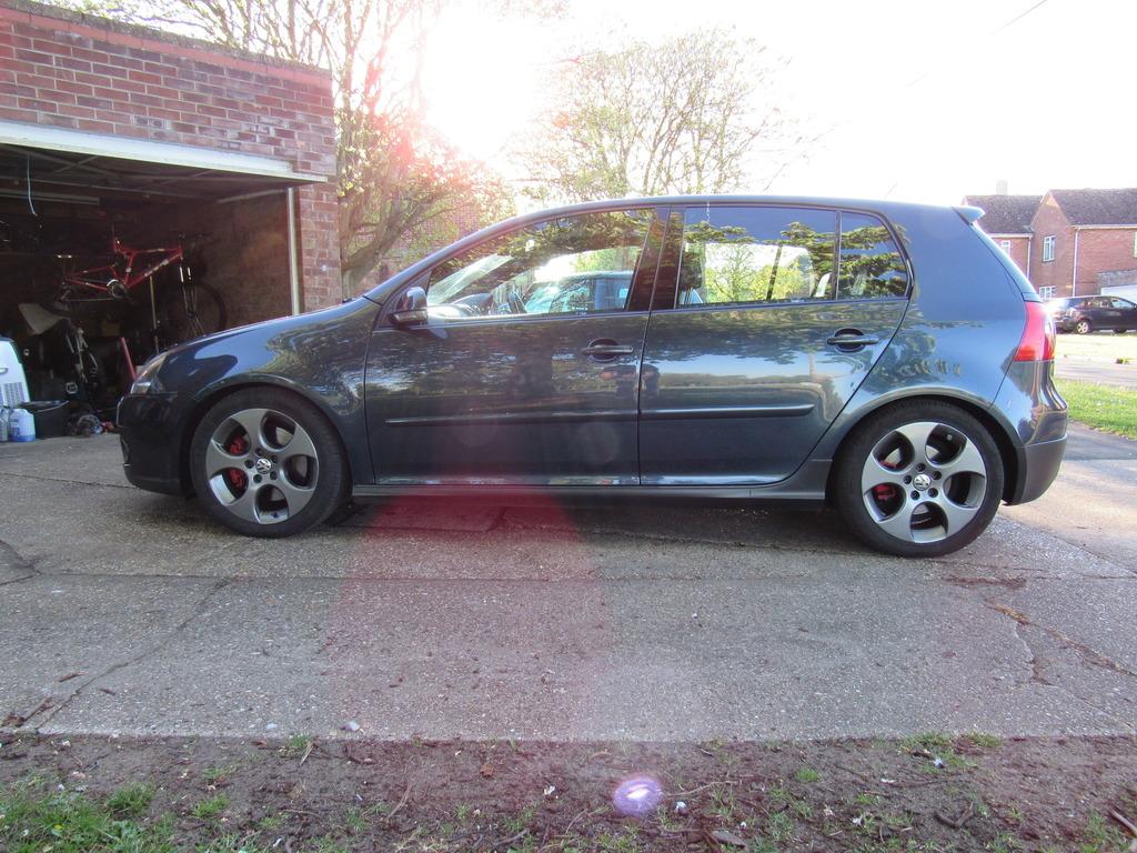

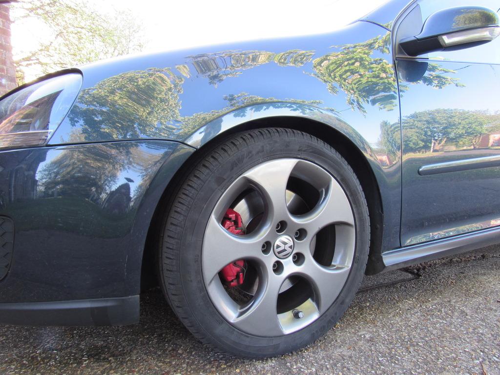

So...finally got round to putting my DSG Springs on the front...
Also treated the car to some new Sach's struts as the passenger one was a little bouncy over pot holes.
Car now sit's pretty much level all the way round, much more OEM :)  (will get a decent pic up)
from hub centre to arch lip is 34mm all round now.
 :pomppomp:

Offline Vwgticrazy
