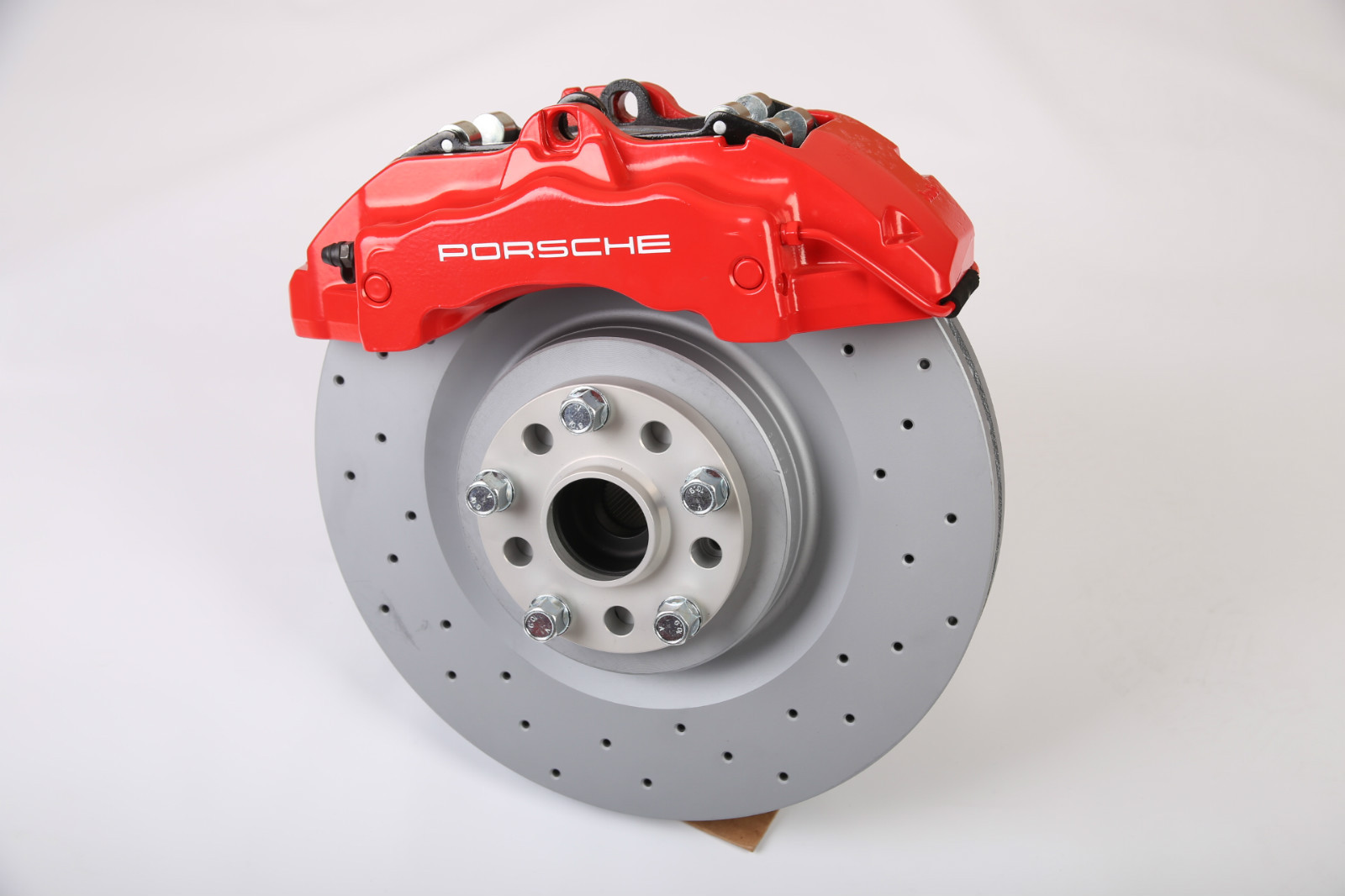

You have 3 easy options:
-4 pot NQSBBK from Porsche 986 (http://www.mk5golfgti.co.uk/forum/index.php?page=mods&mod=20) with OEM GTI brake discs
-4 pot TT-RS front brake kit with TT-S brake discs with 340 mm or with MB GL450 brake discs with 350 mm
-6 pot Brembo 18Z from Touareg/Q7/Porsche Cayenne with MB GL450 brake discs with 350 mm
I chose the last option. :smiley:

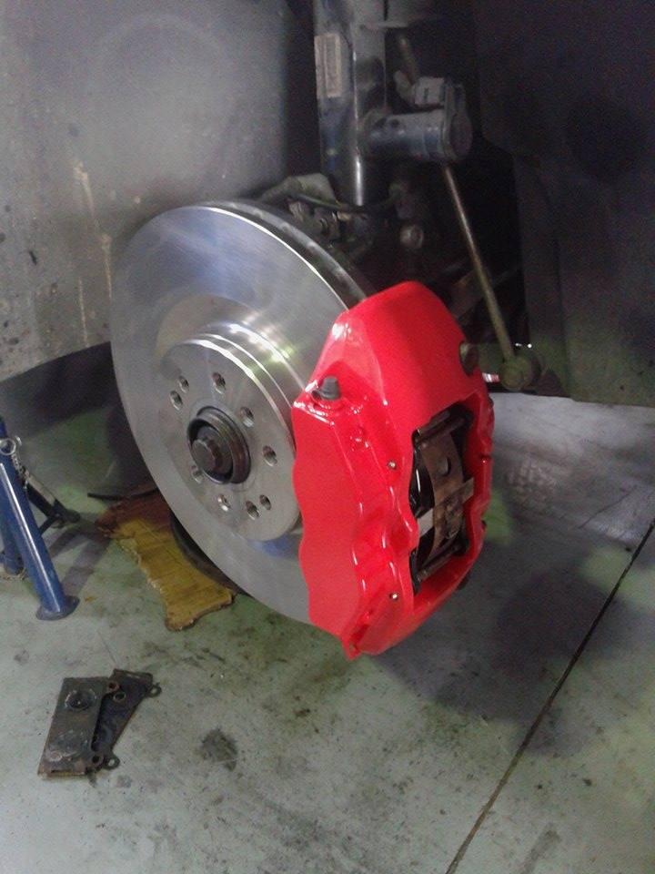

A friend of mine with a Scirocco fitted TTRS brakes with those discs:
I'm preferred going for the Brembo 18Z with the same discs:
