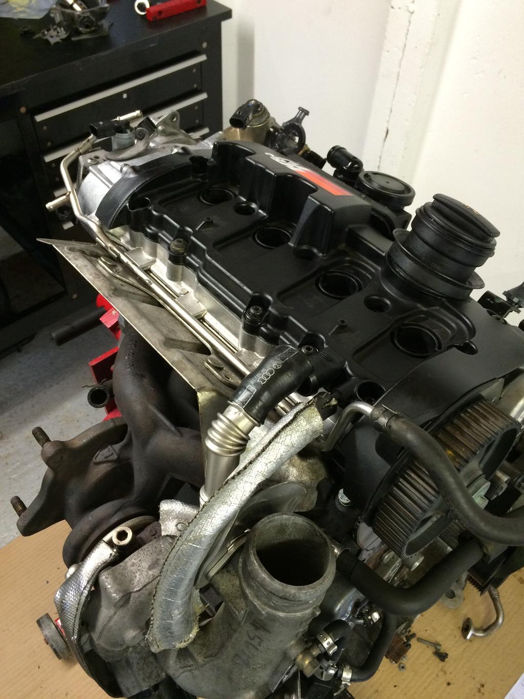

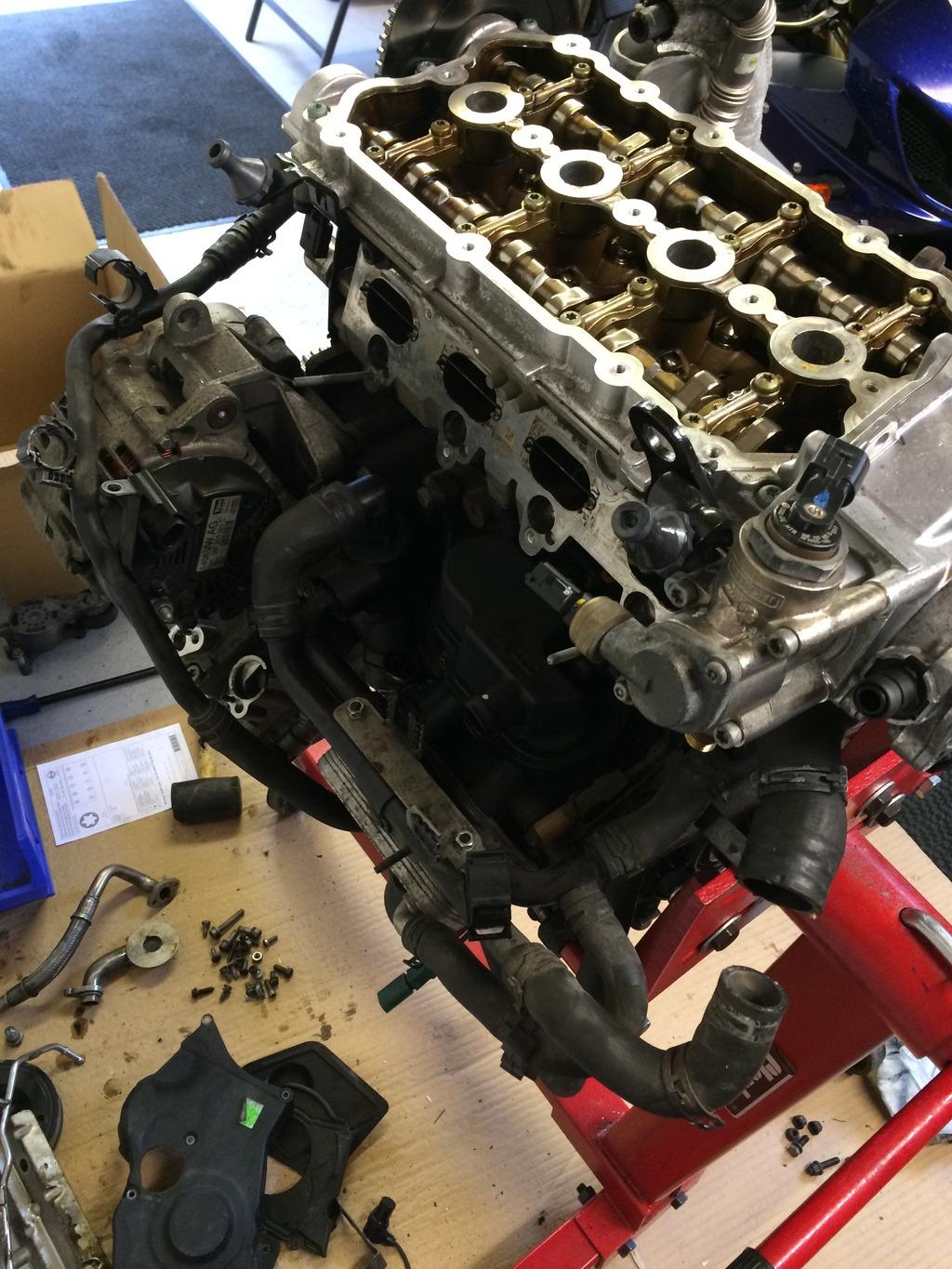

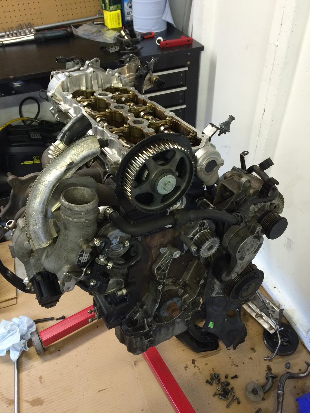

Just a quick update. Bought most of the parts to start putting it back together. Just one trip to my local TPS and I'll have everything.
I'm gonna get the rest of my engine out of the car this week and hopefully have the other lump in and ready to turn over by the end of next weekend.
I'll keep posting pictures as I go  :happy2:

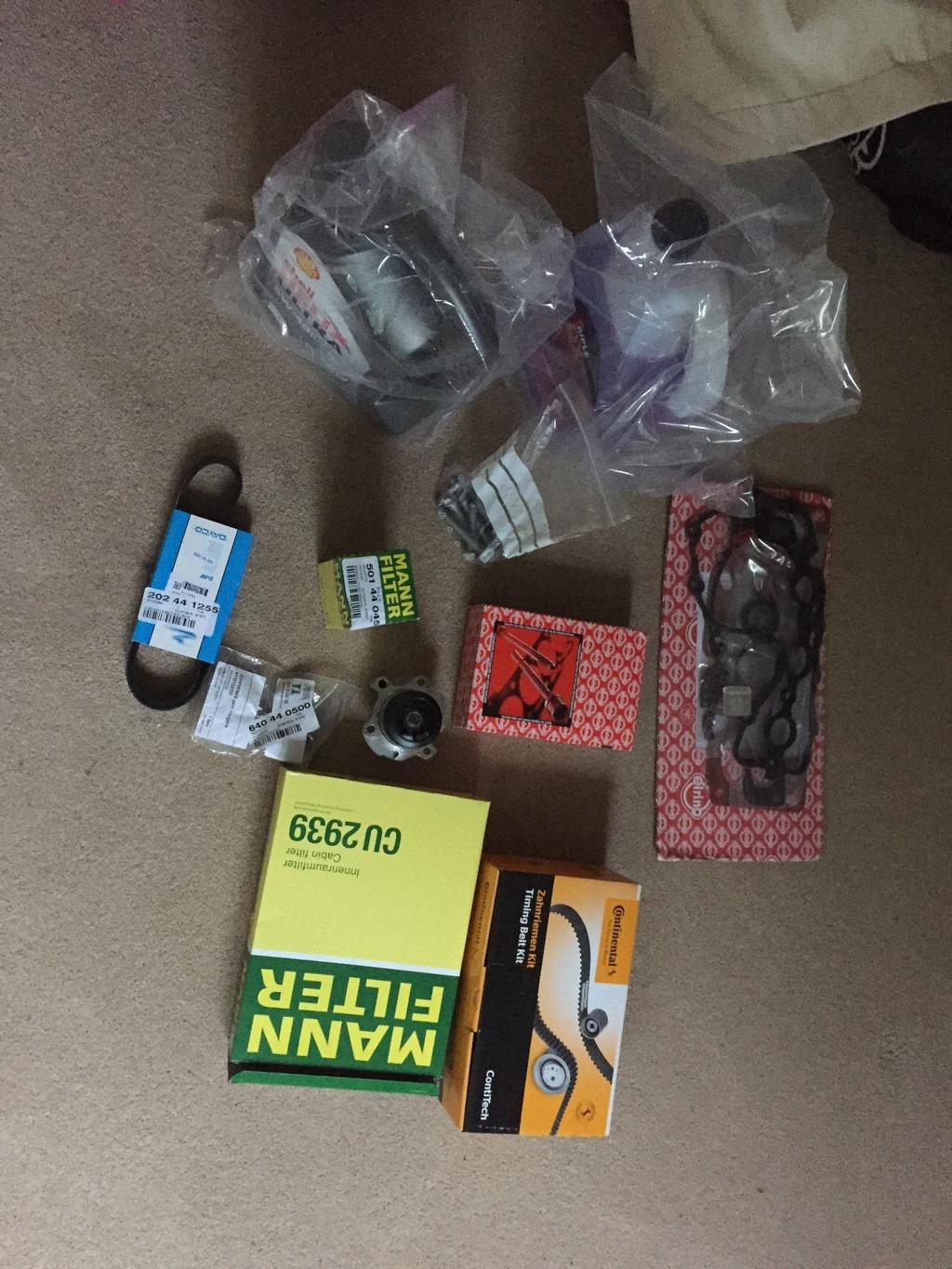

Had a delivery today...
Head gasket kit
Head bolts
Oil filter
Pollen filter
Flywheel bolts
5 litres g13 coolant
5 litres shell helix ultra 5w40 oil
Aux belt
Came to £95 delivered from car parts 4 less with a £15 discount code
Genuine water pump and 6 engine mount bolts that are supposed to be replaced with a cambelt change came to £55 from TPS Stockport
Continental cambelt kit was £74 from Quicko in Trafford Park

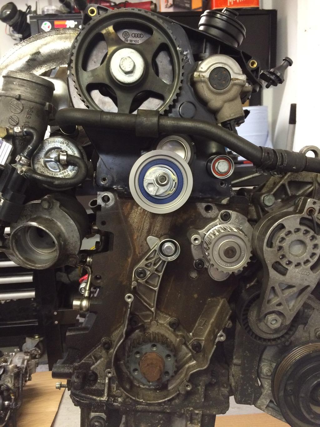

« Reply #27 on: July 12, 2015, 12:33:49 am »
You seem to be making good progress  :congrats:
Did you install a new pick up pipe?
05 | Tornado Red | DSG
Offline Ricky123
  • Posts: 379
  • My Ride: http://www.mk5golfgti.co.uk/forum/index.php/topic,98436.0.html
Re: My 3dr black GTi
« Reply #28 on: July 12, 2015, 12:35:52 am »
I put the one off my broken engine on this lump as it was only a couple of hundred miles old

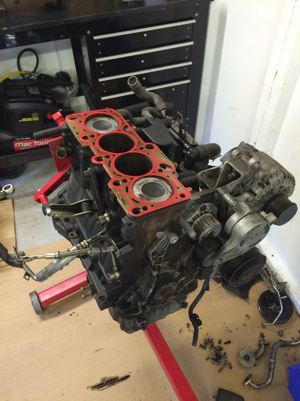

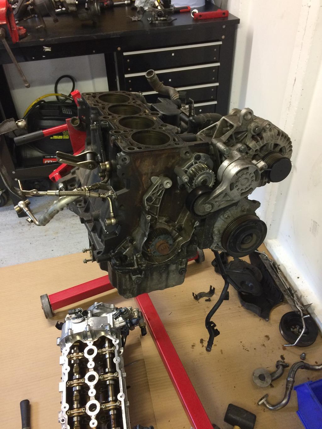

« Reply #29 on: July 12, 2015, 05:09:01 pm »

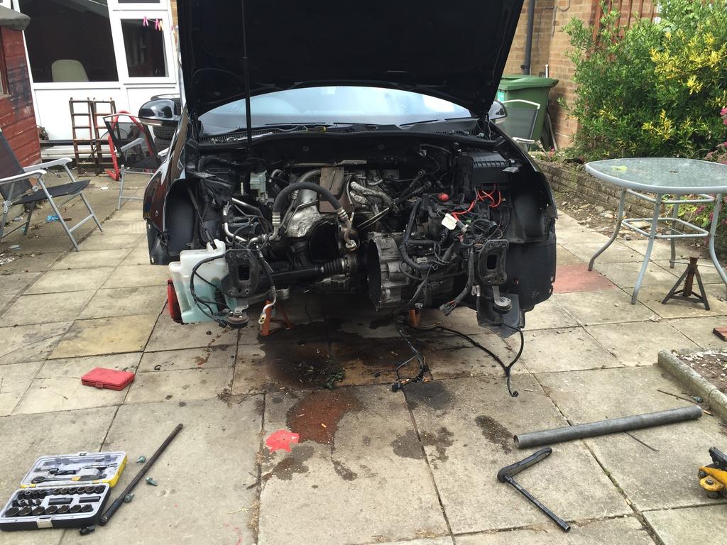

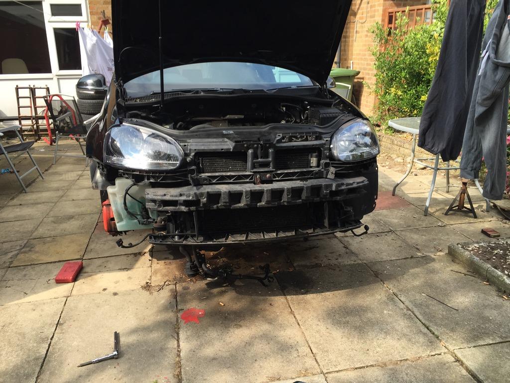

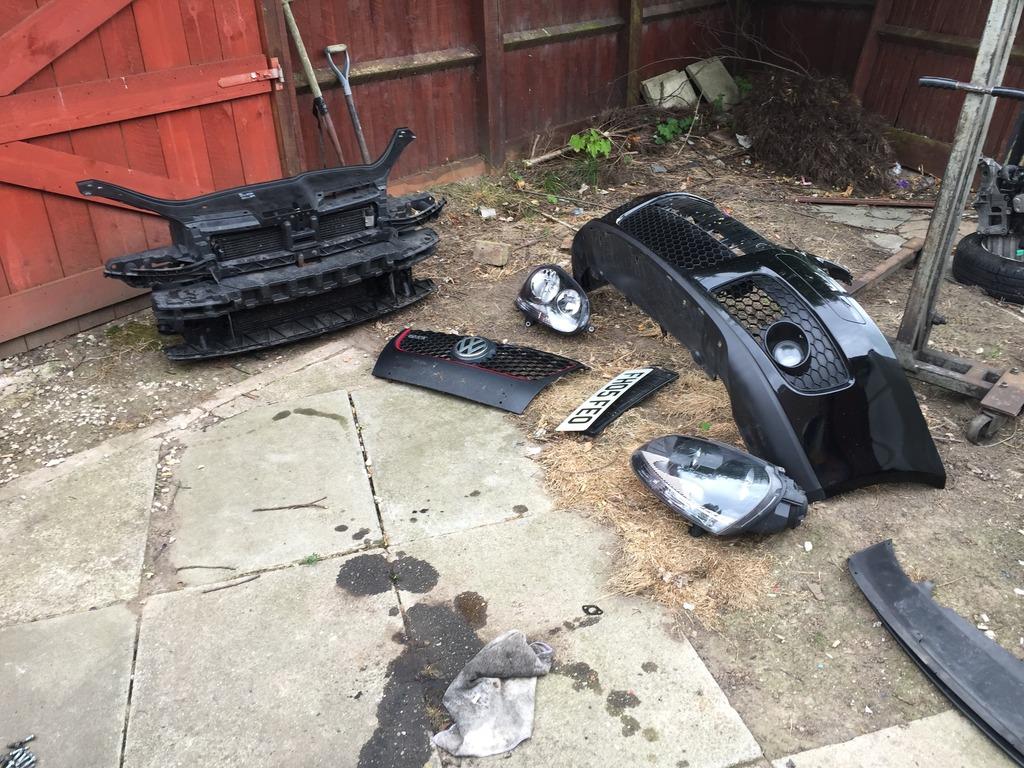

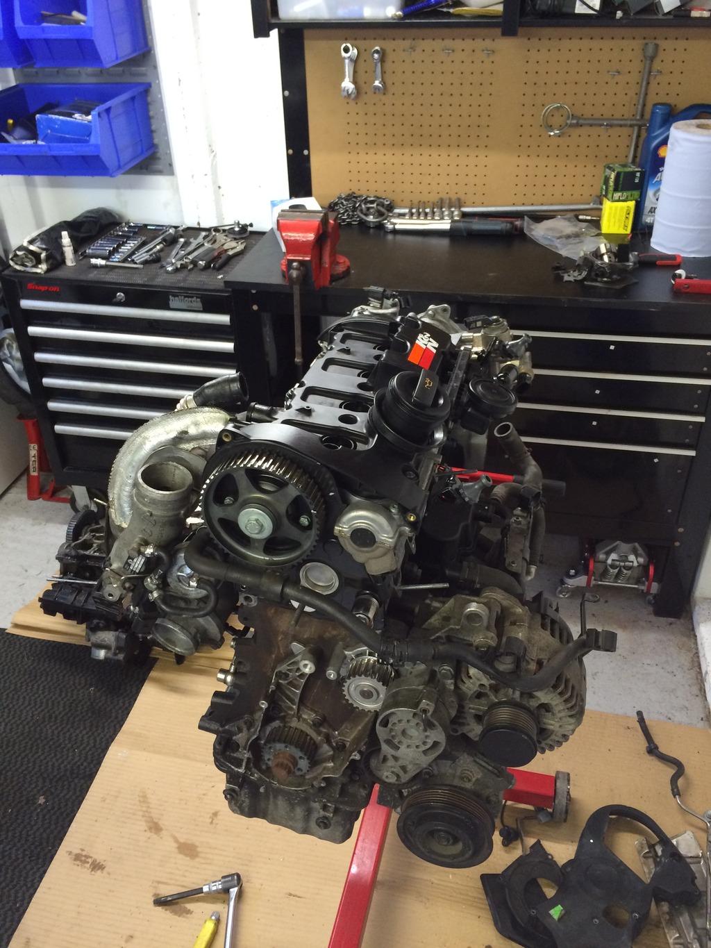

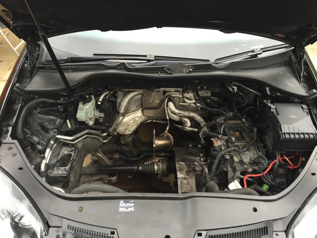

The engine was that tight coming out I've decided to take the front end off to get the new one in.
Others might think it's a lot of hassle and try it another way but believe me if your taking the engine out and leaving the gearbox in then remove your front end lol
Makes life a lot easier and it's not hard to do.
I'll post some more pictures up soon. I'm getting the jet wash out and giving the bay a good going over.
I also had a look at the front brakes, wishbones etc to check the condition  :happy2:
