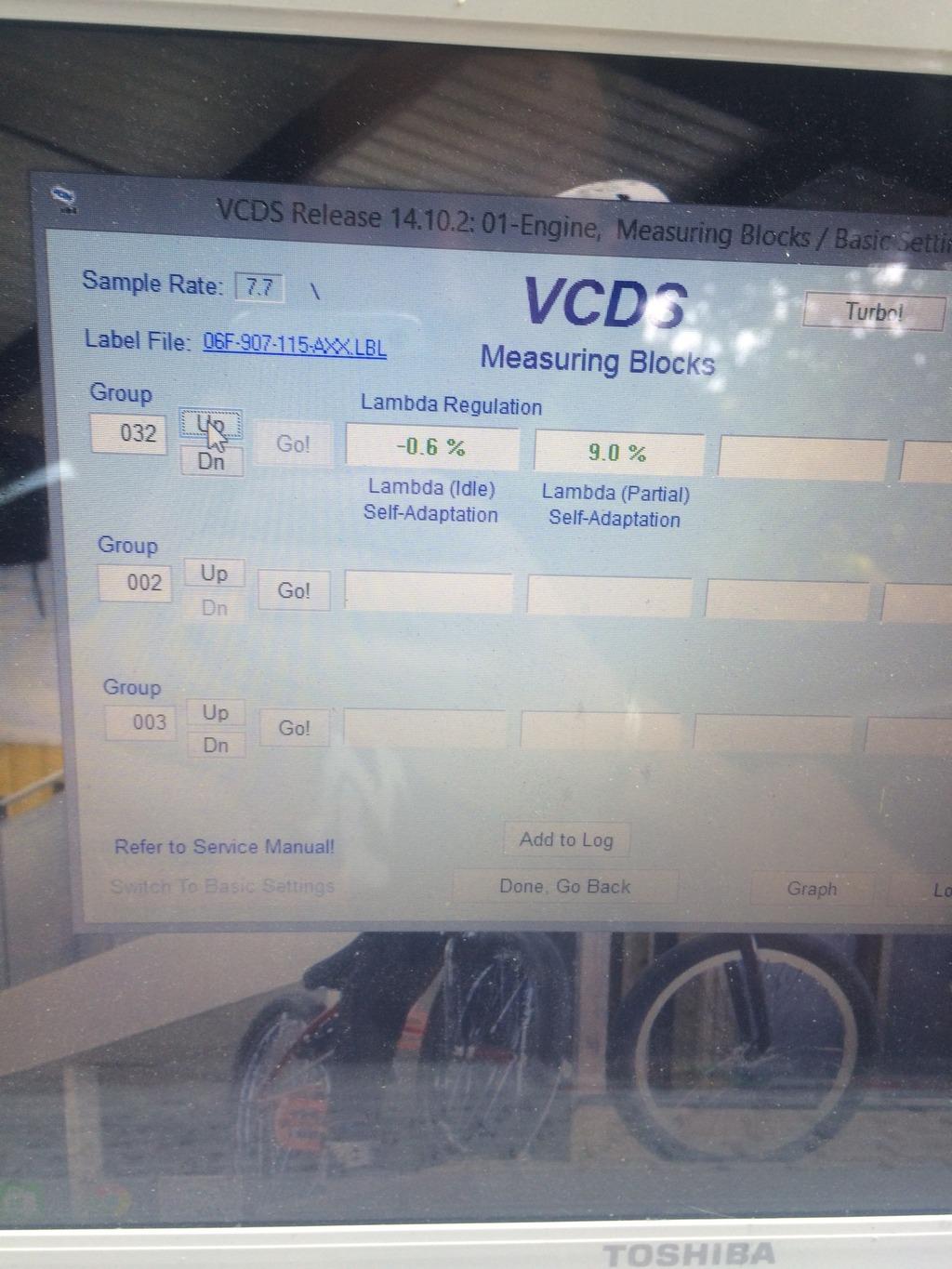

Car doesn't seem to be running quite right lately so plugged in vcds to have a look
No fault codes
But on logging i have misfire on cylinder 3 and 4
Replaced coil packs, plugs and done a compression test and all held about 160psi!
Then when I was looking at other bits i found out its running too lean
I replaced the cam follower and its still the same.
Heard that vacuum leaks can cause it to run lean so replaced my forge dv for the better oem one and my pcv blank to the oem pcv. Car still runs crap!
Rail pressure is fine as well.
What else could it be?
Anyway i can check injectors using vcds?
Any help would be much appreciated  :happy2:

What intake are you running? What were your LTFT's before you had this issue?  How many misfires are we talking about and are they all the time including at idle, or just when driving/under load? Are you K03 or K04? You mention you replaced coil packs, but what about the plugs? If not, change them. Did you examine the plugs colour/condition? if so then details or pictures would be good
Lots more info needed, but the short answer is no you can not check them with VCDS. You can sometimes hear them after you have had the car running by removing a spark plug and listening in to the affected cylinder for a slight hiss

Missed the mention of plugs. Does sound very much like the injectors, getting to be common with K04 cars as they are getting older.
Did you check the condition of the plugs when you changed them? Were the 2 wet / soaked in fuel? Removing the plug and listening for a faint hiss from inside the cylinder shortly after switching the engine off would be next
