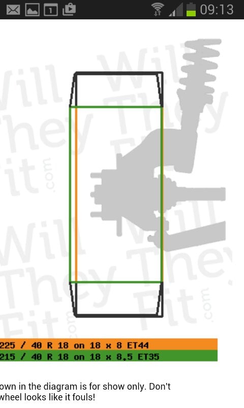

I've put your wheels into willtheyfit, with the current 235 40 18 tyres in comparison to 215 40 18 tyres. You can see where you'll gain some room:

And here's your wheels with 215 40 18, against my VZ with 225 40 18.
 You can see that the shoulder of your tyre would actually sit close to mine. Like I said, VZ with 225 40 18 are known to be a good fit, so therefore your CH with 215 40 18 should be pretty close to that same good fit.

Just to note - 225 40 18 is a factory size for these cars and gives the most accurate speedo readings. If you compare the above images, you'll see that a 215 on your CH wheels brings the diameter much closer to the factory dimensions shown for the 225s on the VZ wheels.
That's another added benefit of going for 215s on the CH wheels.

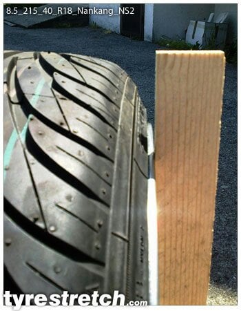

Here's an image of a 215 40 18 tyre on an 8.5 wheel. You can see just how much clearance you can gain over a 235 40 18.

So basically, it sounds like i made a mistake getting CH when the VZ look practically the same and fit better, okay... so if i got some 215/40/18 tyres on my CH, would the alloy poke as much as in that picture? Like the tyres are a bit stretched etc?

That depends on the tyre. Some tyres stretch that way, which for me isn't a good look.
However, some such as the Toyo T1R lend themselves to a bit of stretch without exposing the rim too much. 215 40 on 8.5 is a very mild stretch anyway, so using the right tyre makes it a viable solution.
These are Toyo T1R, with what looks like a bit more stretch than 215 40 on 8.5.
The tyrewall maintains a much nicer shape with a T1R.
