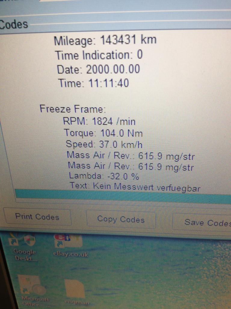

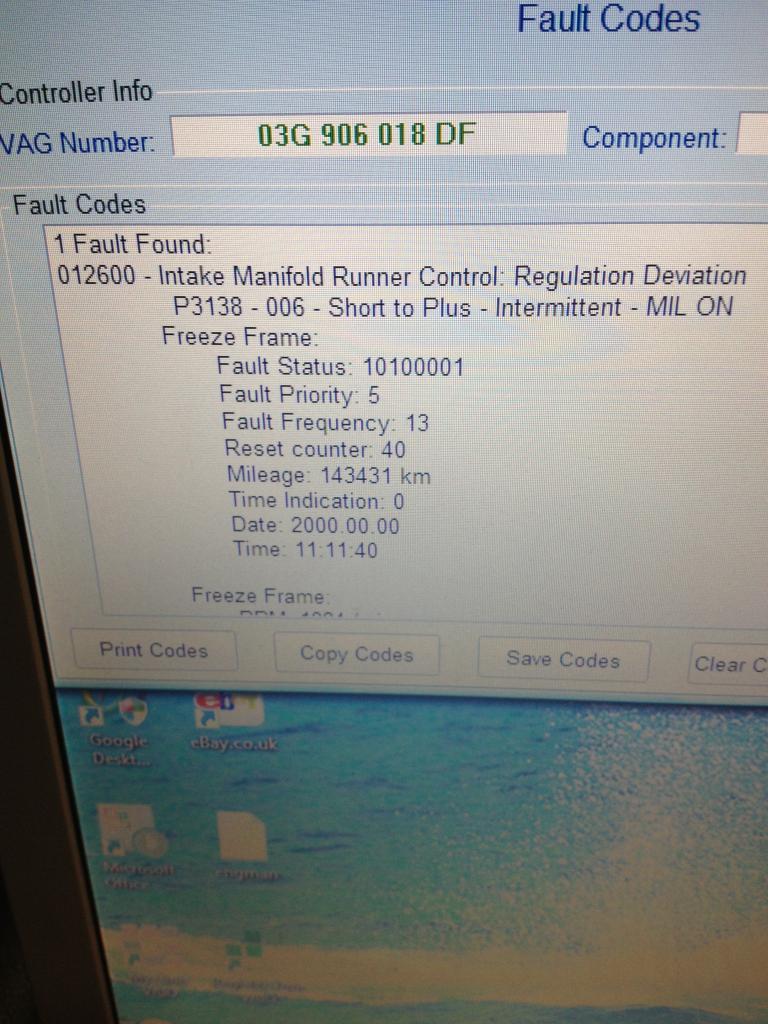

I have had it put on vagcom by a mate and this is all it keeps coming up with.
I have searched and searched the internet to no avail, the 006 short to plus seems to not be a common issue.

Maybe try a basic setting of the Intake Manifold Runner
http://wiki.ross-tech.com/wiki/index.php/19594/P3138/012600

Thanks for the reply, ive tried that and as it seems that is for the TFSI engine which would have the motorised flaps. i cant perfrom a basic setting on the TDI being that it is vacuum.
