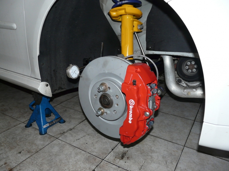

Easily available kit. Parts required are sold from many tuning shops.
Parts required:
-Complete Brembo 18Z calipers
-Mounting bolts
-Brembo 17Z pads
-350 mm MB GL450 front vented discs
-Centering rings
-HEL braided brake lines for Brembo calipers

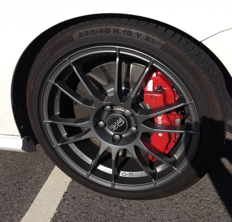

What spacer do these need to fit under stock Mk5 R32 wheels?
